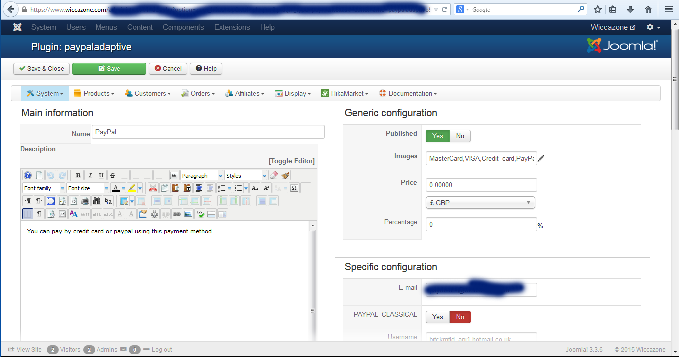

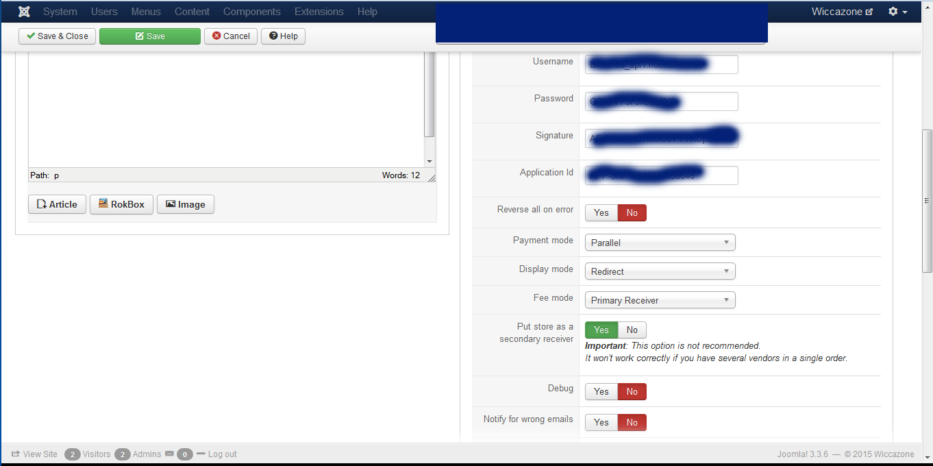

  • Posts: 24
10 years 6 months ago #188807
Hi Mohamed
I am using paypal adaptive and have attached some screen shots.
in the screenshot - the payment mode is set to parallel, but I have also tried the mode as chained - and still get the same problem
Thanks for any help in advance.

  • Posts: 26264
  • Thank you received: 4043
10 years 6 months ago #188816
Why did you activate the setting "put store as secondary receiver" ?
  • Posts: 24
10 years 6 months ago #188839
My reason for this is because paypal say I need to be the secondary receiver because if a customer makes a purchase from more than one vendor in the same transaction and I am the main receiver, if they request a refund, as main receiver, all vendors will have to refund regardless of only needing to refund from one vendor.
Thanks for your quick response
Last edit: 10 years 6 months ago by steflosco36.
  • Posts: 26264
10 years 6 months ago #188842
Regarding the error, it looks like you making an order without any vendor.
But if the store must be the secondary receiver without any primary receiver, the plugin can't work ; it becomes in contradiction with his configuration.
Am I right ?

  • Posts: 26264
10 years 6 months ago #188908
We added this option because it was added by some users but I am still not fan of it.
That's why I put a warning message when the option is selected.
