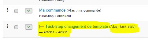

  • Posts: 8
11 years 7 months ago #188955
I just found a solution!
1. First, I created a new menu link. And the type is an "Article". And I the parent link is the ma-commande menu. And I changed the alias.
2. Then in that menu I assigned it to a new template (or I could assign a new module).
