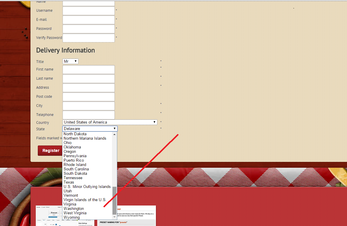

I noticed when i register as a customer to have an account so i can order that the state of Wisconsin not listed in the states drop down list
see screen shot
all the customer local from Wisconsin
any help and solution appreciated
thanks

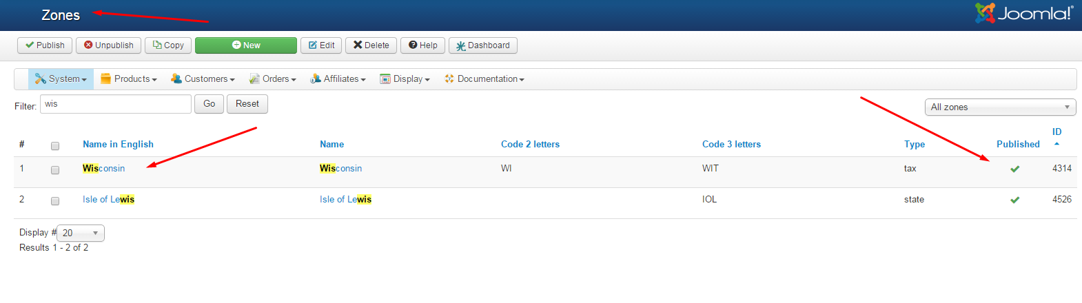

I checked the zone already and here you go screenshot
what do you think

You changed it's type from "State" to "Tax" so the system doesn't consider it anymore as a state and thus doesn't display it in the state dropdown.
There is no need to change it to the "tax" type since both country and state zones can also be used as tax zones in your tax rules.
