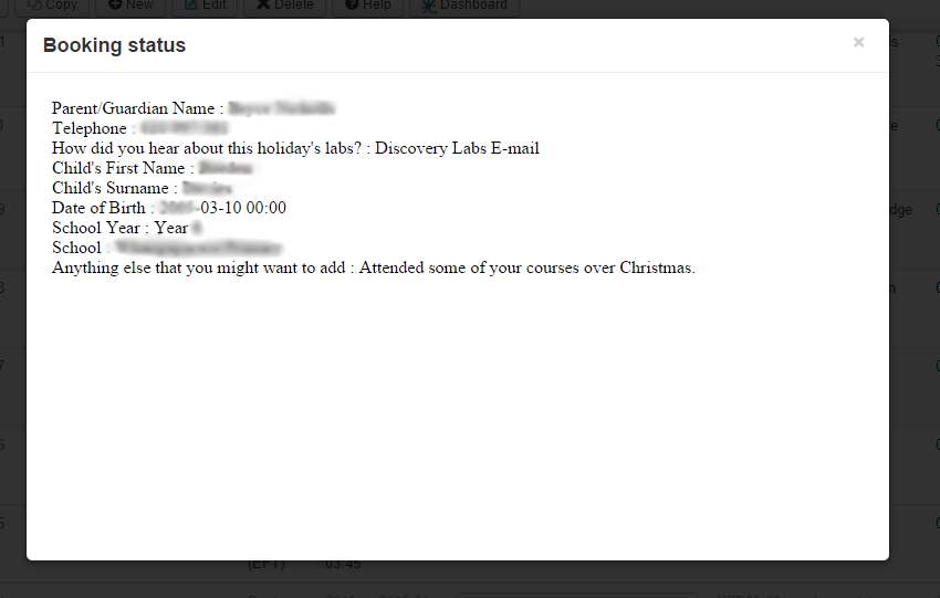

-- Error-message(debug-mod must be tuned on) -- : When changing order status don't get all options
Before updating, when I changed the order status a screen would open up that allowed me to add notes to the order as well as send a copy to my client. Now all I get is a screen that looks like the one below. There is also no save button.
Some more info: It looks like any screen with e-mail associated with it does this. Invoice and Shipping Invoice tabs are working just fine

I first think that it looks like a hidden PHP Fatal error in your email.
Then I see that you send us an email with accesses to your website ; so I take a little look.
I forced temporally the "error reporting" to "maximum" in your Joomla global configuration and I was able to see the PHP error message
Parent/Guardian Name : ---------
Telephone : -------------
How did you hear about this holiday's labs? : -------------
Child's First Name : -------------
Child's Surname : -------------
Date of Birth : -------------
School Year : -------------
School : -------------
Anything else that you might want to add : -------------
Warning: strtoupper() expects parameter 1 to be string, object given in /YYYYYY/public_html/XXXXXXXX/administrator/components/com_hikashop/classes/field.php on line 1382
Catchable fatal error: Object of class stdClass could not be converted to string in /YYYYYY/public_html/XXXXXXXX/media/com_hikashop/mail/order_status_notification.preload.modified.php on line 378
I don't know if you have customized your preload email, but if you did not modify it, I will suggest you to remove the override for that part of the email.

After looking at your website and doing some tests, if found that the issue is coming from your custom order field with the namekey "coupon".
Please create another custom field with another name, populate its value with the ones of the "coupon" one and delete the "coupon" custom order field.
This namekey can't be used because in the order data we have a "coupon" entry for the real coupon system, so when trying to get value in the custom field it get the coupon object of the order..

11 years 6 months ago #190379
Awesome, that did it :-) Thanks
