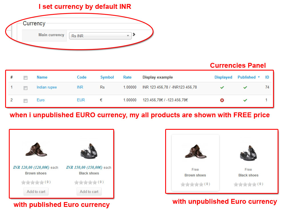

  • Posts: 4
11 years 6 months ago #191554
Sir,
i attached the photo please check sir....
I want to show only INR prices, i don't want to show any other currency.
I hope this will help you to understand my problem.
  • Posts: 2143
  • Thank you received: 747
11 years 6 months ago #191555
Ok, let me say it again then:
Set only INR to both "published" and "displayed".
For a start, make sure that all other currencies are not "published" or "displayed". Simply put: no other green checkmarks behind any other currency.
Of course, make sure that no cache is enabled on your site.
You should then have prices displaying in INR only.
If you then want to add other currencies as well, please try to understand the difference in between "published" and "displayed" - you should now have enough information for this.
