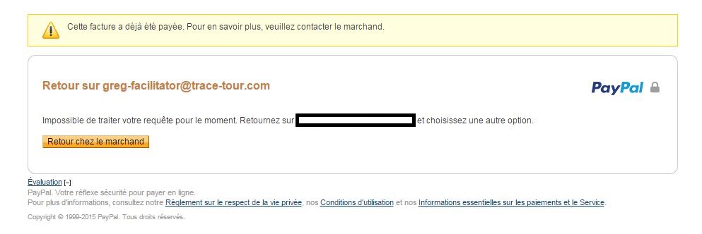

  • Posts: 56
11 years 5 months ago #193458
I enter the Sandbox account Paypal gave me into Plugin Paypal configuration.
then I test it and I get that.
and I've received an email telling "Your command will be valided after receive your payment"
Don't look like working.
Any advice
Last edit: 11 years 5 months ago by mtgt.
11 years 5 months ago #193483
I think that you have an issue with your paypal settings.
Maybe the sandbox account parameters. Please check that the option to validate payment manually is disabled, etc.
