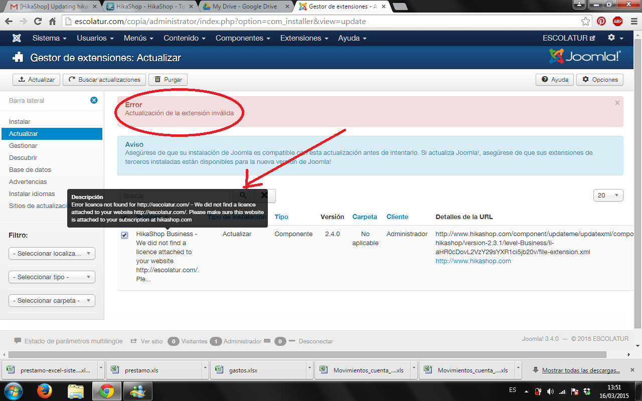

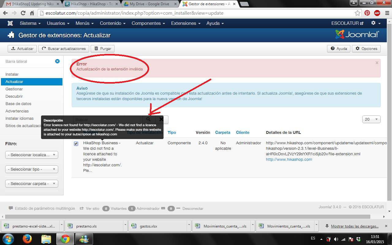

  • Posts: 80
11 years 5 months ago #194981
Thanks, but when I go to Extensions -> Update I have the screenshot attached.
Where must I download the updating file and where must I copy the updating file downloaded?
Best regards
Leonora
11 years 5 months ago #194985
Please look at the text with the title "HikaShop Business" : "we did not find a licence attache to your website".
So please check your Hikashop licence to see to which website you attached it.
www.hikashop.com/my-account/your-subscriptions.html
We just provide automatic updates to one single website per licence.

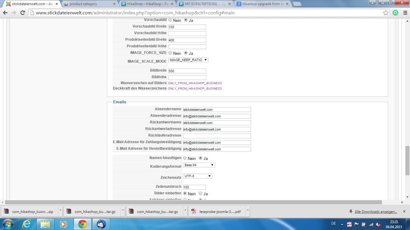

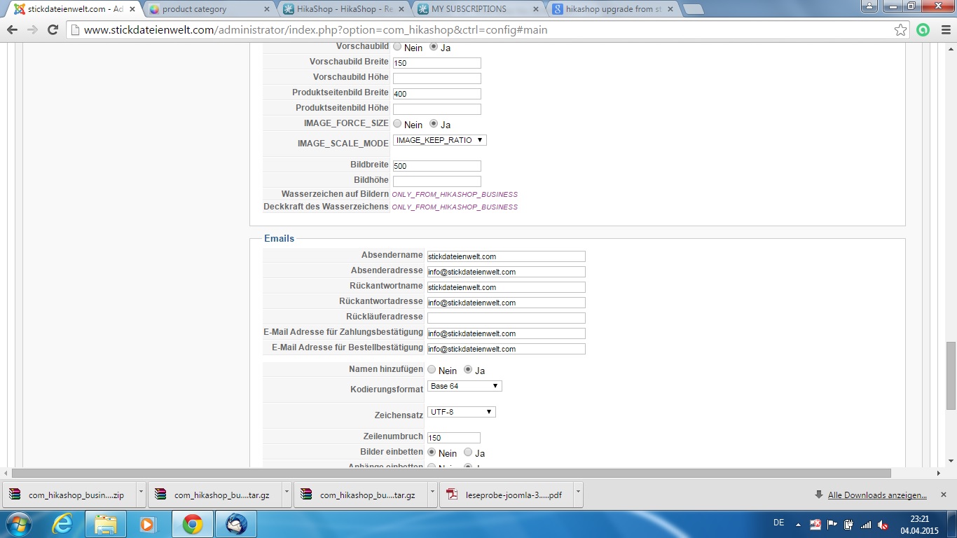

  • Posts: 9
11 years 4 months ago #197332
Hi ,
i have a problem after update to business from essential.
i have had just downloaded the business zip to joomla installer. it had no problem within , but i see some message on my site and i still have no bussines version inside
what i have to do jet? it the update no pass?
thank you
  • Posts: 9
11 years 4 months ago #197338
and more one: all prices gone to free.
what is this?
  • Posts: 9
11 years 4 months ago #197340
may be it also help you to understand what's happen: i can't save no more new articel and also old one can't save the changes
thank you
i hope you can help me

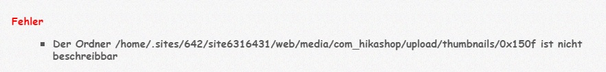

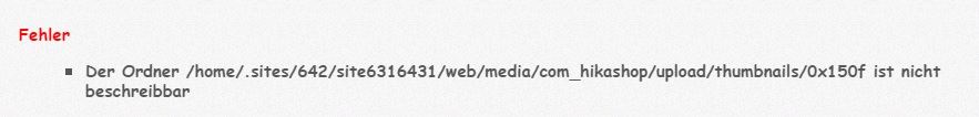

11 years 4 months ago #197342
The error message you got means that you have a folder (the folder written in the message) which is not writtable.
So you have to check that the folder exists and right have write permission ; if the folder does not exist you have to check that the parent folder have the write right permission.
Regarding your screenshot and the "business" message ; are you sure that you right update your website ?
Maybe you have an upload limitation and the installation was not processed ; maybe you have some write permissions issues and the files were not updated..
Please try to install HikaShop business using the "ftp install" method and check that you do not have error messages while processing the update.
