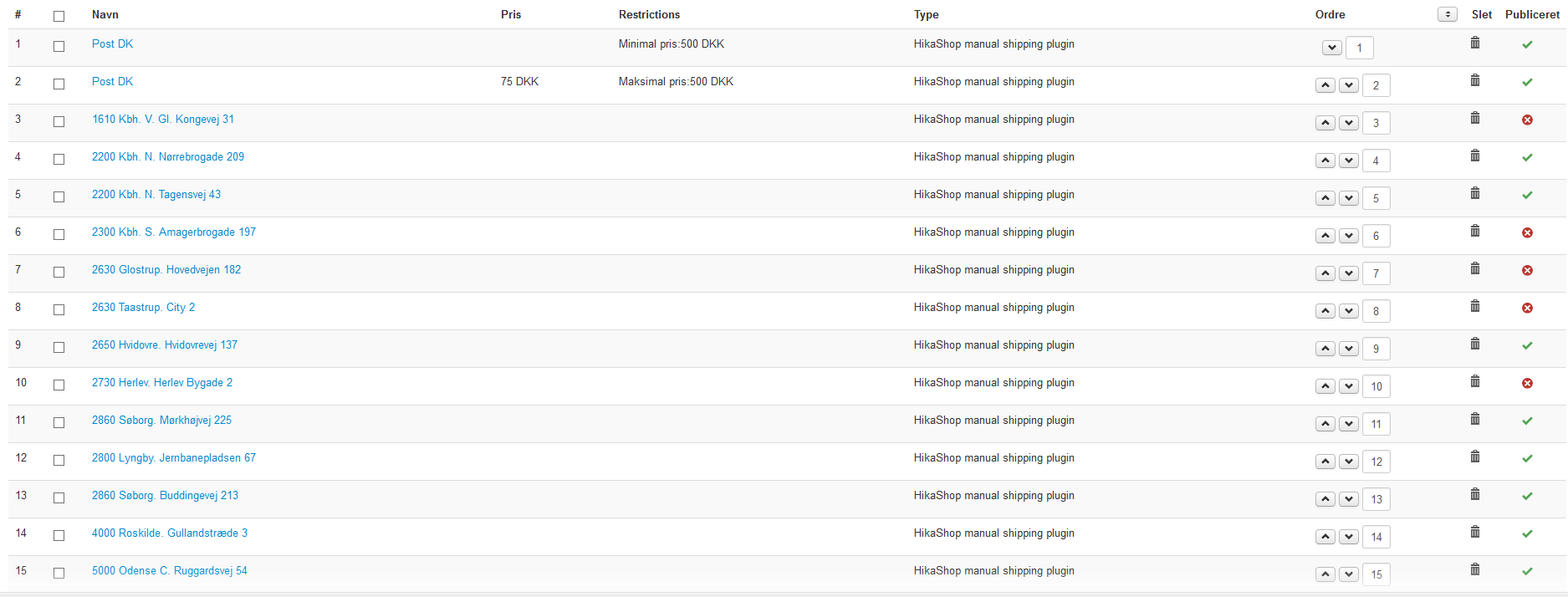

11 years 5 months ago #196914
Can you provide a screenshot of your shipping methods listing so that we can see how you configured their ordering ?
  • Posts: 171
  • Thank you received: 4

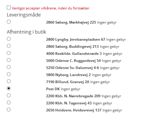

11 years 4 months ago #197319
Here is screenshots of both frontend and backend
