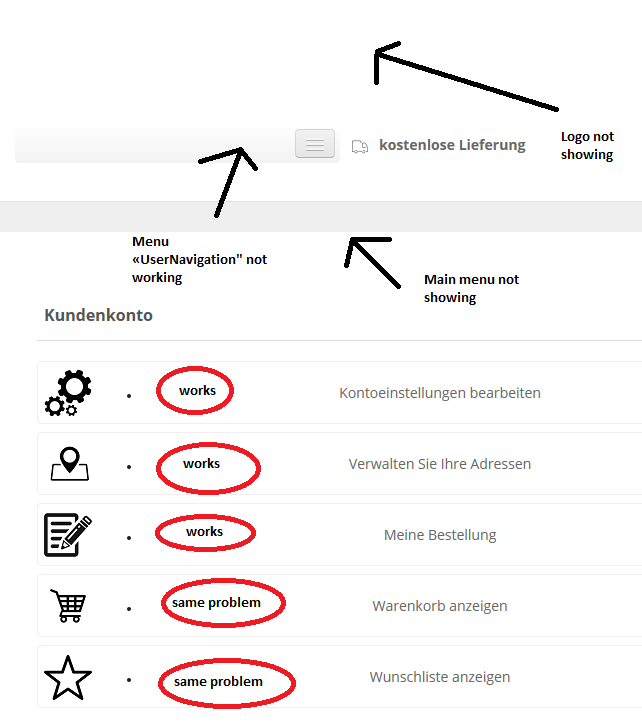

Hello
I might have the same problem but didnt edit a custom code for the menu. The menu works on every page except from "Userpage" and two more reachable only through "Userpage". Furthermore is the Main-Menu dasappearing and the logo isnt showing either. You can see the problem in the picture attached to this comment.

11 years 3 months ago #201413
Did you check your JavaScript console to see if you had some error in it ? Without a direct access to the page where you are having your issue we won't be able to fully understand your issue.

11 years 3 months ago #201489
I can give you a login to my page.
There is indeed a JavaScript error and I dont think I am able to solve that :blink:
florcar
11 years 3 months ago #201639
Yes please give us a link to your website and a test account.
You can send these informations via our contact form, don't forget to give the link of that topic in the message.
11 years 3 months ago #201646
It is possible that the JavaScript error cause the issue, this come from the plugin system "yjsg".
Please try to disable it, or contact the plugin provider to solve that issue.

11 years 3 months ago #202051
Hi Xavier
Thanks for the help. I had to reinstall this plugin. Now it is working fine.
