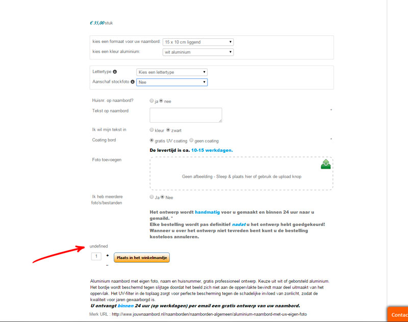

I'm trying to migrate my complete shop to another domain (currently a testdomain). I exported the complete mpw_hikashop_** database and first installed Hikashop on the testdomain and then imported the SQL exportfile into the new database.
Everything looks fine, but on the productpage the "hikashop_product_price_with_options_main" returns "undefined".
I can't figure out what's causing this error.
Can you help me out?

It seems to be a problem with your server configure which sends a 404 status instead of a 200 status when no status is specified by the application. That should normally not be the case and that's what is creating the problem.
Edit the file "option_price" for your frontend template via the menu Display>Views and change the line:
header('Content-Type: text/css; charset=utf-8');
to:
header('Content-Type: text/css; charset=utf-8', true, 200);
and that should hopefully be enough to force a 200 (success) response code from your server for the price with options.
An alternative could also be to hide the price with options with such CSS:
#hikashop_product_price_with_options_main{ display:none; }
but I suppose that you want to display it.

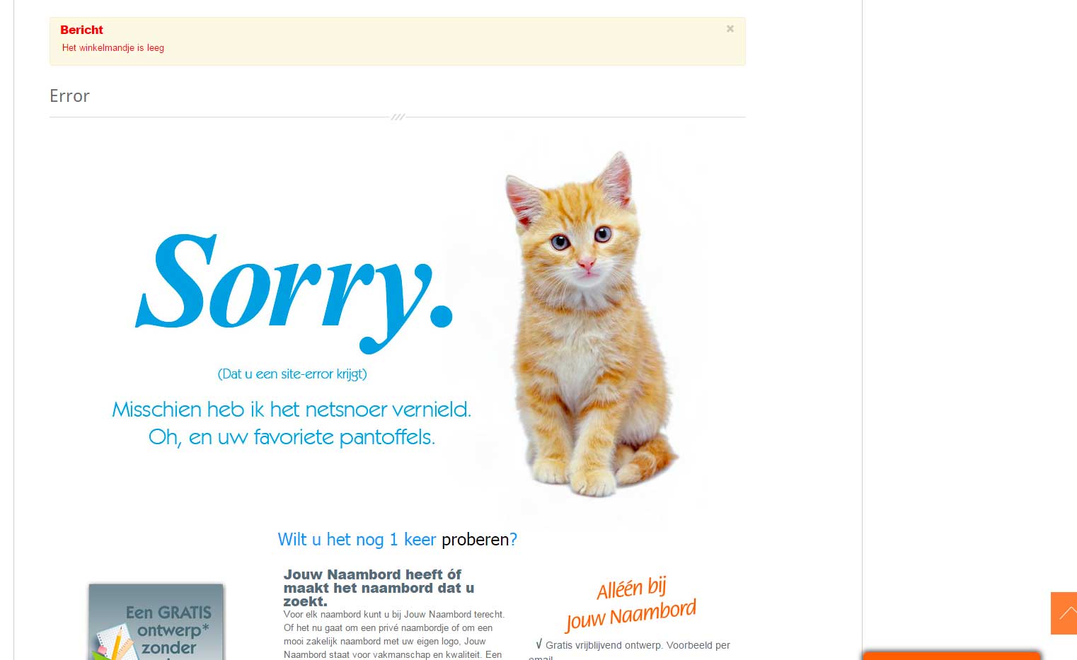

Yes, that indeed does remove the undefined error and displays the price with options. But then in the next step instead of forwarding to ..index.php/component/hikashop/checkout?Itemid=156 it returns ..client-login/my-orders/user page with the Message: cart is empty

This means that the system added the products to the cart and then redirected to the checkout, but on the checkout page, the system couldn't find the cart anymore and thus redirected there with that error message.
This will happen if the server can't keep the user session data.
Try to change the "session handler" setting of the joomla configuration. It can sometimes help in such cases.

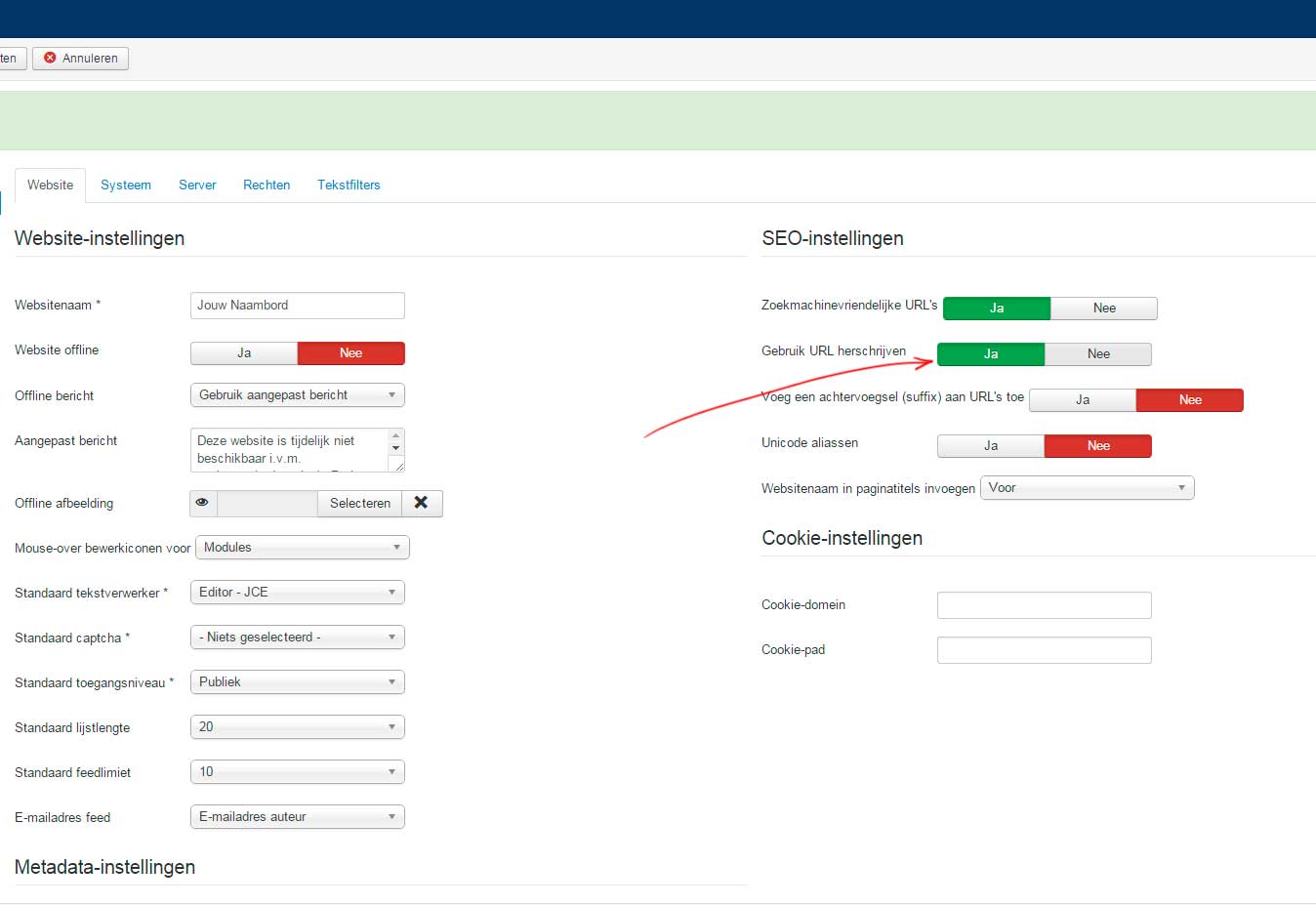

After very much trial and error I found out the cause of this problem. In Joomla default settings I have the SEO setting "Use URL rewrite" on "Yes", so the "index.php" is removed from the url. This is causing the error on the product page. When I change the setting to "No", the productprice with options is shown correctly. Off course I would like to keep the SEO setting to "Yes".
Michel.

I 'm not sure if I understand what you mean by that. When enabled (see screenshot) all the "normal" article pages on the website are shown correctly without the "/index.php/. The only occurring error is in the productprice with options on the product page. The htacces file is ok, my other websites (without Hikashop) are working correctly with this setting. So why should this be something the hosting comp. can solve? Do they have to change something on the serverside?
B.R. Michel

Yes. Sorry that I took you in the wrong direction. Indeed the fix you provided didn't do the job. That's why I kept searching for a cause myself and found out about the SEO setting.
When the setting is activated the price with options shows "undefined" and when it's disabled the price with options is shown correctly.
