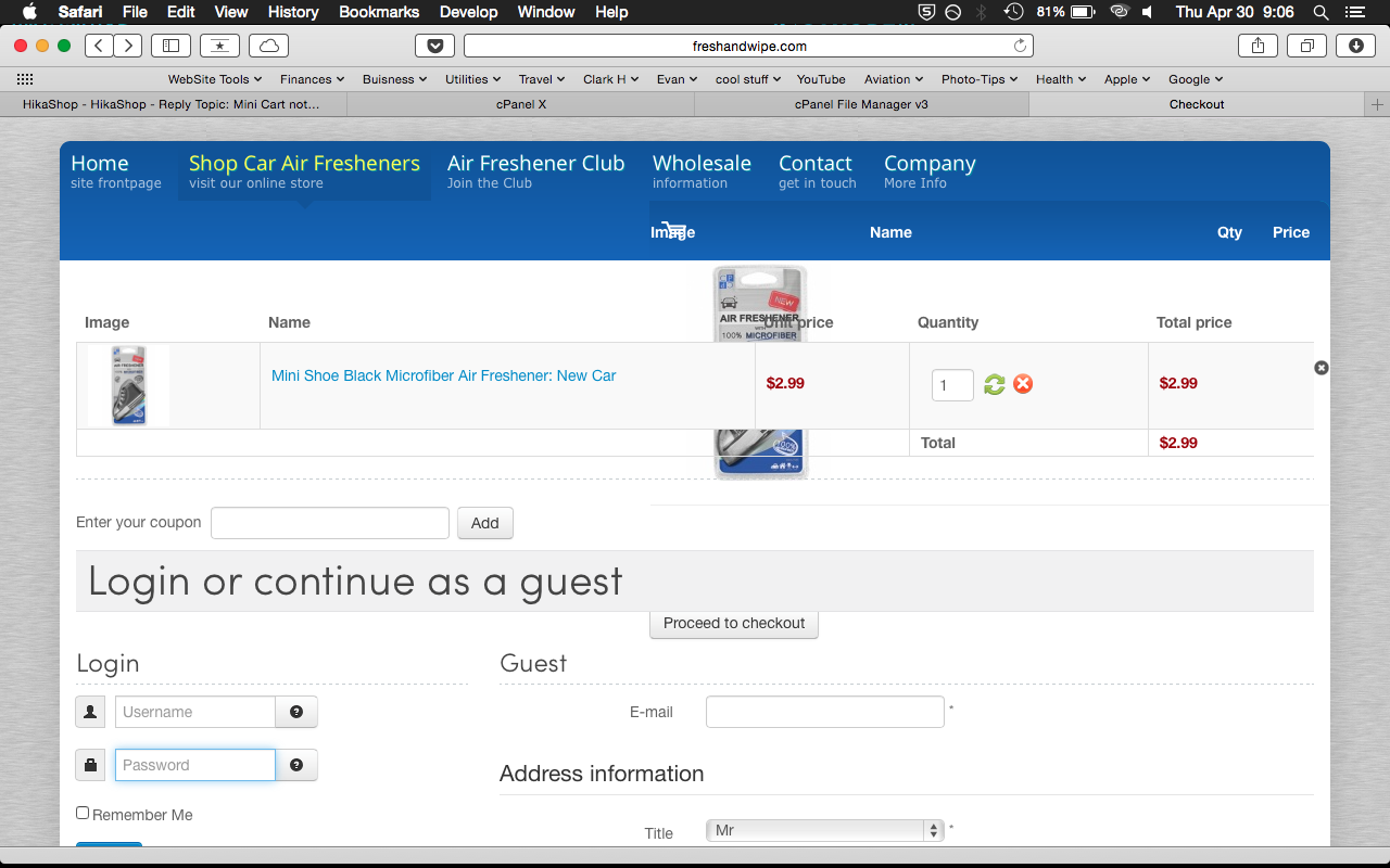

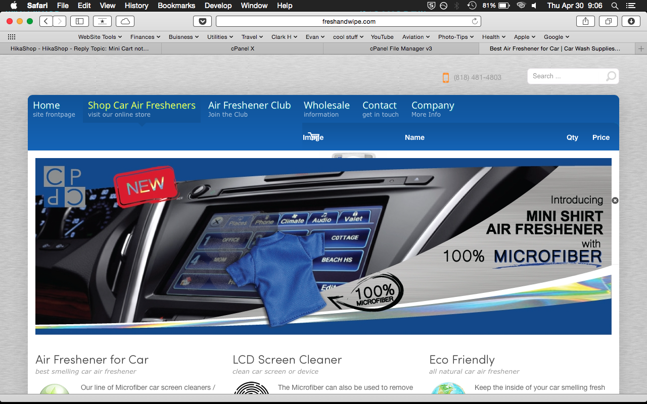

I have not done any customization to the templates/YOUR_TEMPLATE/html/com_hikashop/product/cart.php File. The strange part is that this feature has been working ever since i installed HikaShop and 2 days a go it stopped working with no customization or modification of any file.
I tried to rename the file as you stated but that re-aranged my Menu Items for my website here is an image.
Thank You

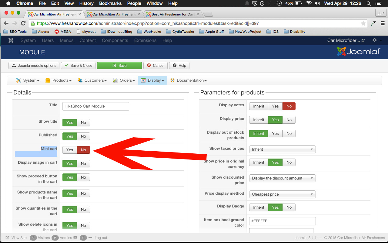

Renaming that file means that the cart module uses the normal display again. And since you have the "mini cart" option turned off in the cart module options, it's normal that you see the full cart there.
This even indicates that your cart module view had been heavily customized as it is not taking into account that setting of the module.
So turn on the "mini cart" option of the cart module and it will look a bit better and the link to the checkout will work.
Now the display will probably be different from what you had since by renaming that file, you basically remove all the customization done to the cart module.
