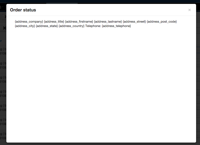

Hi guys, I'm having issues with order first of all it comes up with gibberish (same as this thread here) TOPIC: After Update to 2.3.3, Cannot Change Order Status. When I click on status to change from created to shipped (say if they have paid and we have seen it in our account). I get gibberish :(
Does this mean I have to update Hikashop? I tried searching for an answer but it appears it didn't get solved for this guy.

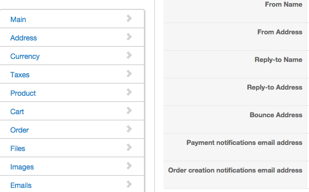

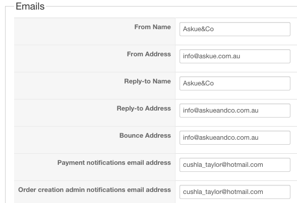

These are the fields I have filled in for the order under 'configuration->emails' Is there perhaps something I'm missing or another section I am supposed to be filling in.
Thanks! (again) :)
