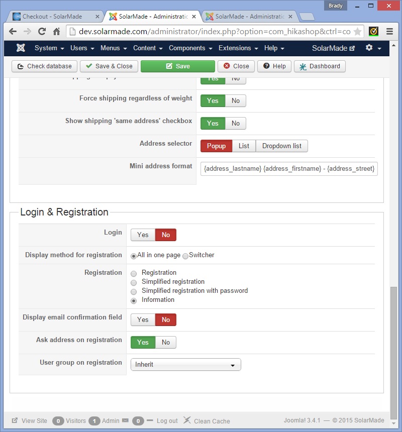

I updated to the newest hikashop version on our development site to test it before I updated our live site. I have some custom coding in place and I wanted to make sure the update didn't clear that all out and set things back to defaults.
Most things seem to be working properly except on checkout. I get the the "Email address already used" Error but my setting are the same as the live site(last hikashop version which is working and doesn't display this issue). I have attached a picture of my checkout settings.
Do you know where else this issue might be coming from?
Thank you

Thank you for the reply. I suppose I should have been more specific.
We want all customers to be guests, every time they purchase. We only collect data for shipping purposes and do not need nor want it to be store on Hikashop/the internet.
Our current live site is set up this way. However, after the implementation of the Hikashop update on our development site, and using the same configuration settings, it has forced the undesired error. We do not want people to register. Where else should I look , beside Hikashop configuration>Checkout, or what else should my settings be, other than what is attached below, to turn this feature off.
Thank you
11 years 3 months ago #203055
Your configuration is set to use guest account ; but it does not change the fact that if there is already a Joomla account with the same email, HikaShop won't allow the guest account.
