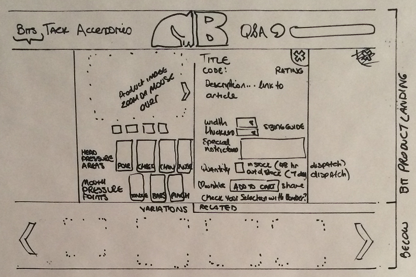

Hi there
I would like to change the appearance of the product page to something similar as the image attached. Is this possible?

  • Posts: 26
11 years 2 months ago #204085
Hi Mohamed
What basically needs to happen is
1. add what is currently in the Specifications tab at the bottom of the page to be positioned just below the product image.
2. Add a horizontal related product slider below the product information.
Link to development site
My php is not the best but i do know my way around css.
Hope this helps.
