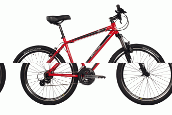

I have an csv file with the products to import.
The csv have the url of the image for each one.
When the csv is imported the published images show two black lines. See the image attached.
Could you help me?

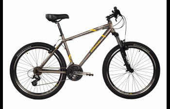

Hello Nicolas,
Thanks for your help! The black lines disappeared but some images are broken. See attached. I think that the problem is with the .gif images.
Regards, Leo.

I don't see why it would be linked to the force size setting.
Could you delete the folder images/com_hikashop/upload/thumbnails via FTP so that HikaShop will then regenerate all the thumbnails ? Does that help ?

10 years 11 months ago #206051
Hello, I´ve deleted the folder and the new image is generated again with the same problem.

10 years 11 months ago #206095
I know that it is not the perfect answer but I can't tell you why the image is not processed correctly.
That is linked with the PHP GD library and I don't think that we can do something to fix it in HikaShop.
But I can recommend you to use PNG files instead of GIF files. The compression is generally better and you can also have the support of the transparency ; plus you can have a better palette of colors.
