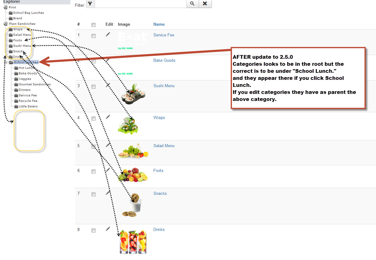

Category tree is not correct after upgrade to 2.5.0.

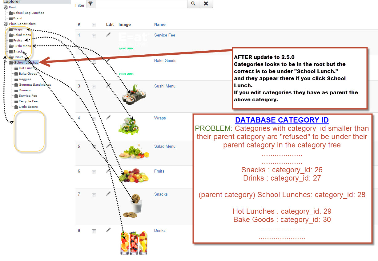

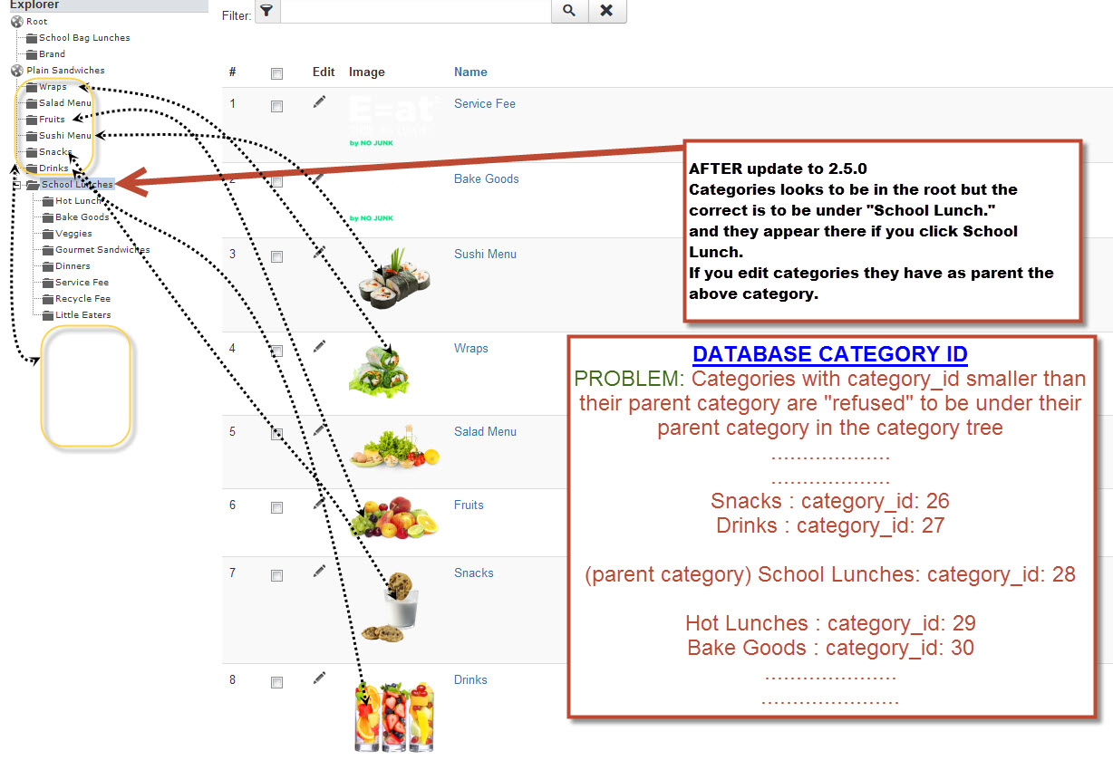

I checked database and the "category_type" is product and also all "category_parent_id" are the same.
I think that the key for this problem is that the categories with "category_id" smaller than the parent category are "refused" to go under it in the tree.
Details inside the screenshot
Please advice
Thank you

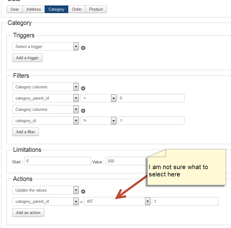

1. The simplest solution is to create a mass action via the menu System>Mass action of the type "category", with two filters: one on the column "category_parent_id" equal to 0 and one on the column "category_id" different from 1.
And with an action "update the values" on the column "category_parent_id" equal to 1.
That will reassociate these categories below the root category.
Then, you can click on the "rebuild" button of the Categories listing of HikaShop to fix the tree structure and you'll be able to see these categories in the left explorer.

2. I made the mass action as you described with a question in the last step (see the screenshot) and categories dublicated, and a copy moved under the category in question.
Of course test was locally, so I had no problem to restore the database.
Can you please be more specific?

Your mass action is the way I would have done it.
If that doesn't help, then we would have to look at your website backend in order to check the issue directly.
In that case, please provide an access along with a link to this thread via our contact form:
