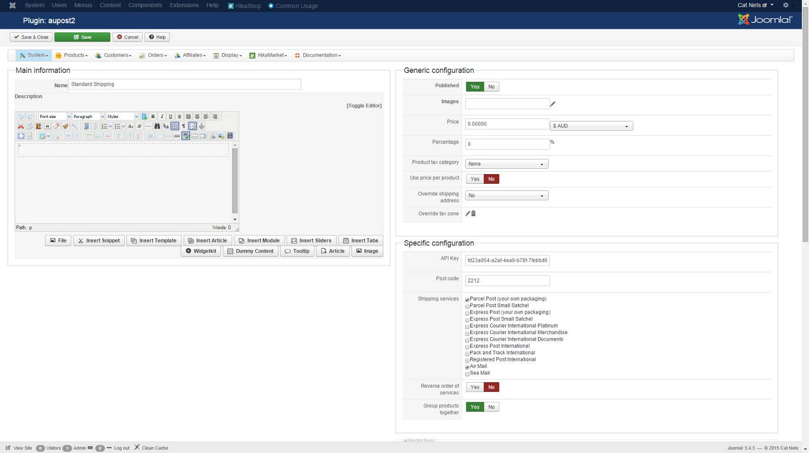

10 years 10 months ago #209947
Hello !
It's working fine on my end, can you show me through some screenshots how did you configured :
- Your shipping method
- The product that you have in your cart

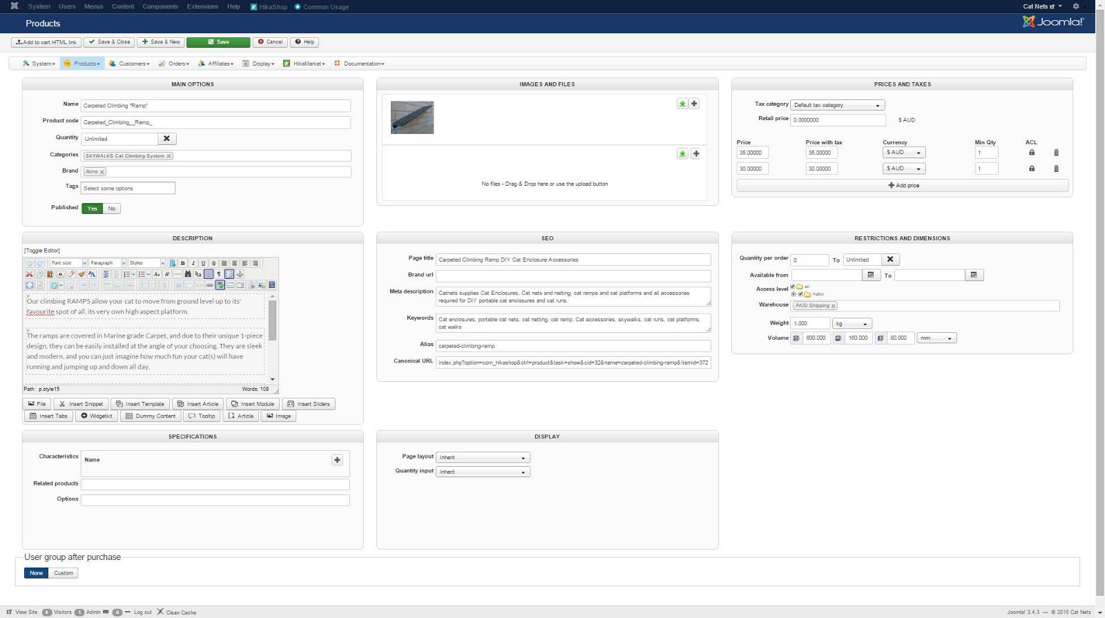

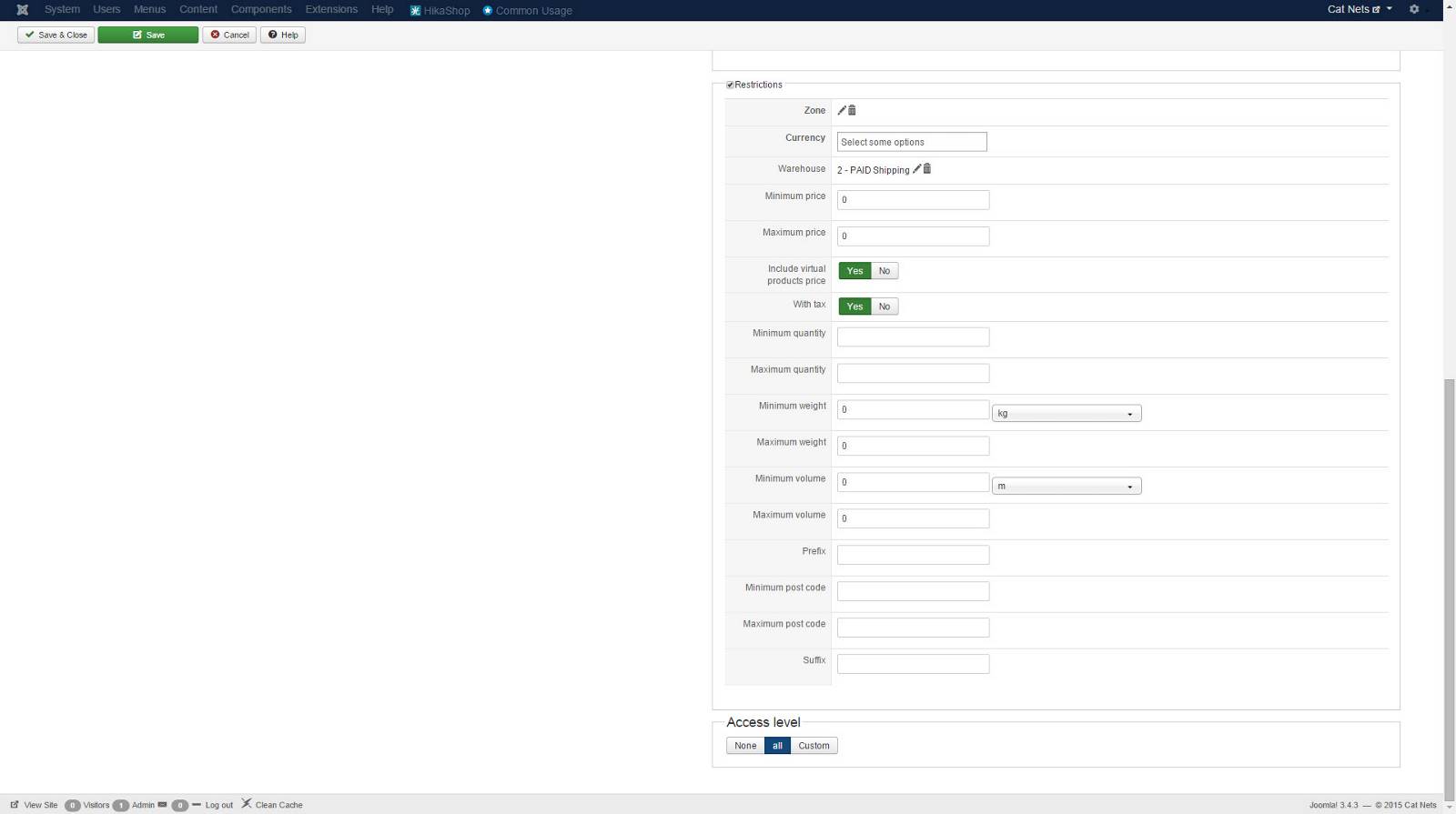

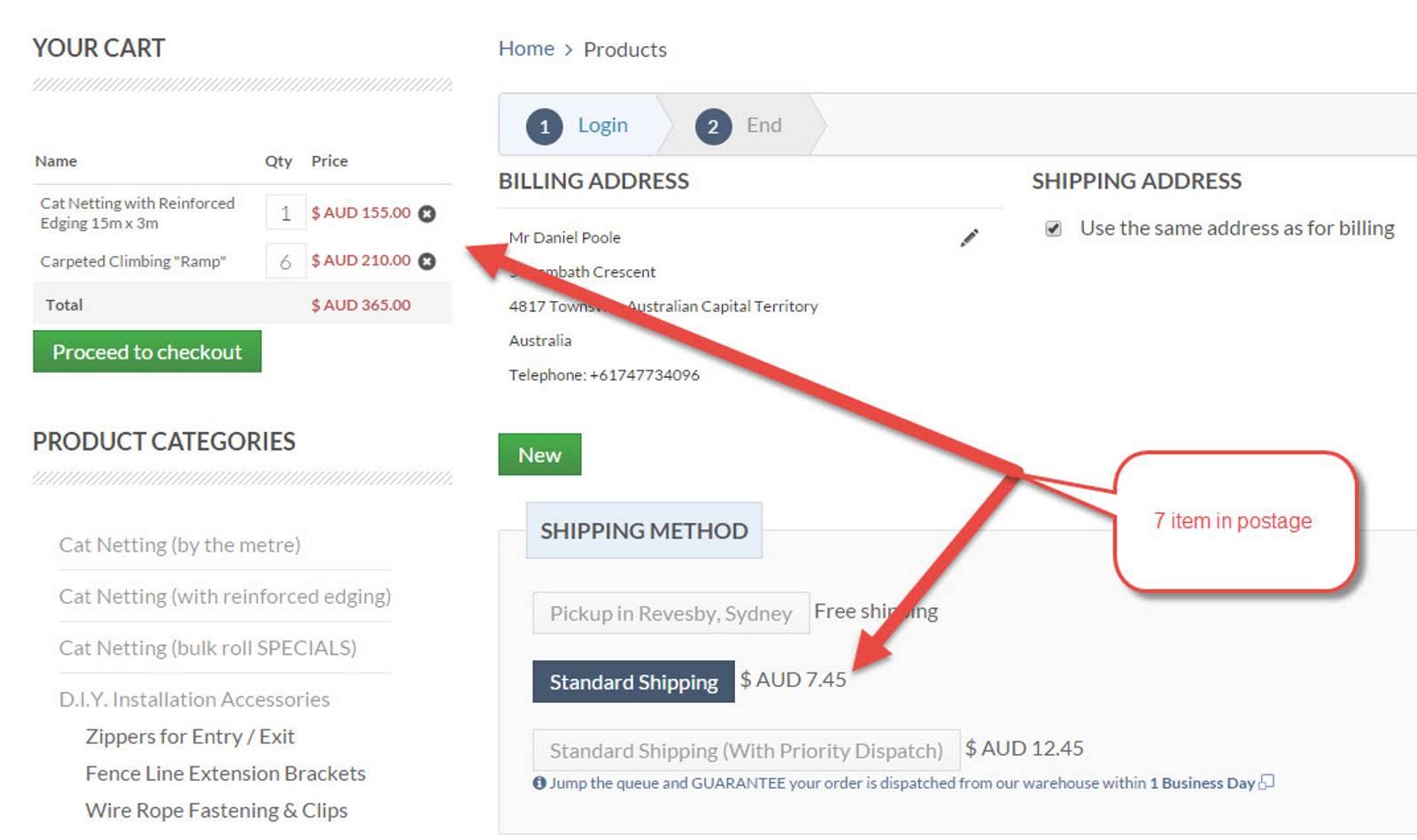

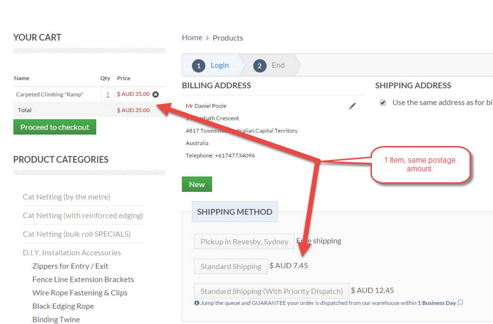

  • Posts: 64
10 years 10 months ago #210072
I have attached 4 screen shots, the first two show no matter if there is one product or multiple products in the cart the postage stays the same. The 3rd, 4th & 5th images show the product & shipping settings.
