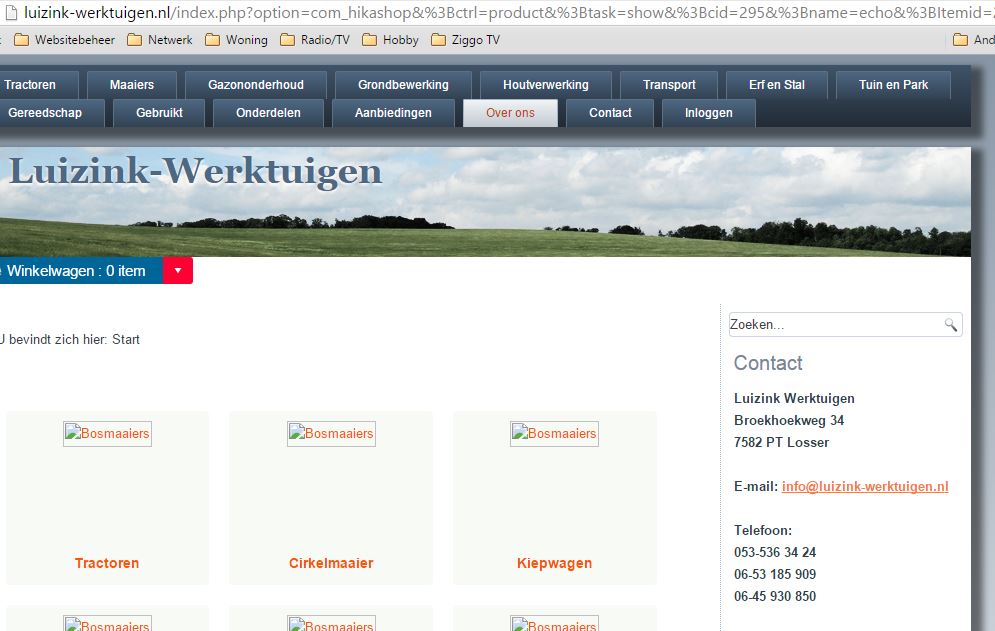

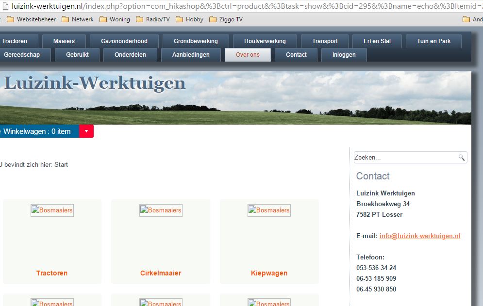

On my website, after the update to version 2.5.0, the url's of some products are a mess.
Examples:
Tuin en Park>Bosmaaiers>Echo Multifunctioneelsysteem
Url: luizink-werktuigen.nl/index.php?option=c...%3Bcategory_pathway=

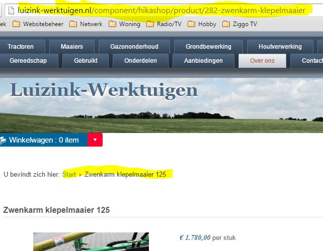

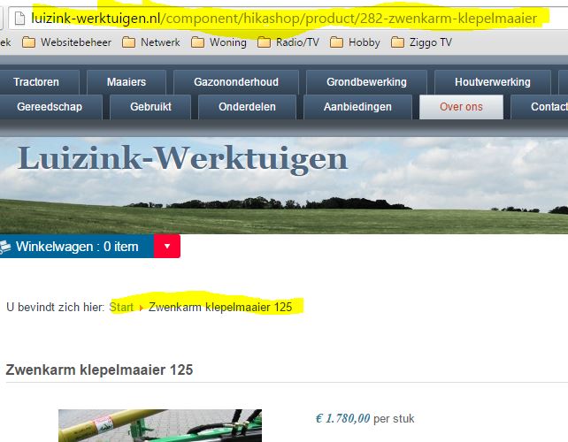

Maaiers>Klepelmaaier>Zwenkarm klepelmaaier 125
Url: luizink-werktuigen.nl/component/hikashop...wenkarm-klepelmaaier
In the first example not only the url is messed op but a page is shown with all categories...
In the second example the url is not as it should be. Neither is the breadcrumb.

This looks like a problem with the canonical URLs of your products which are not correct together with the "force canonical URL on listings" option activated in the HikaShop configuration.
So two solutions:
1. You could turn off that option of the HikaShop configuration. That way, the canonical URL won't be used on the listings to access the product page but recalculated each time.
2. You could clear off the canonical URL of all your products with a mass action configured like this take.ms/wHjUJ via the menu System>Mass actions.
The upgrade from the 2.4.0 shouldn't have an influence on the issue.

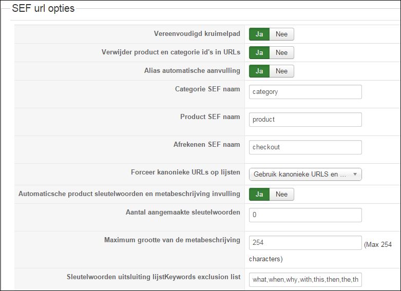

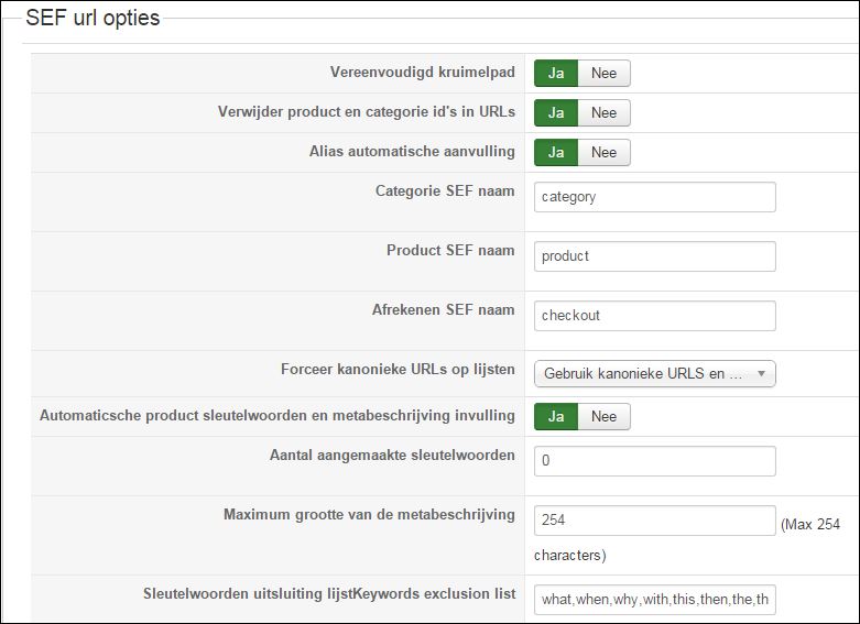

Thanks again. I removed all the canonical url's via a mass action and changed the SEF configuration as in the attached screenshot.
Would you please be so kind to confirm that this is a good/valid configuration.
We do have products that are accessible via the main menu and the same products also via the sub menu. What I see is that when one product in a certain submenu is once accessed via the main menu, the canonical url/breadcrumb points via this main menu path.
Because I prefer that the breadcrumb is always via the sub-menu I had to access one product in each sub menu once. That seems to work but is there another solution or configuration for this?

I don't speak your language but what you did looks ok.
Note that you don't need to access each product page to have the canonical URL generated automatically.
Just accessing the listing of products will be enough.
