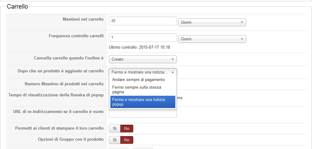

Hello
How you can see in the img, I setup in global configuration the option after a prodoct is added to cart as "stop and show a popup.
But it adds just the product in cart without any popup :unsure:
The same when I click on image of produc dettail, it show the image in other page, not in a popup
What do you think?? why that??
thanks
FRank
