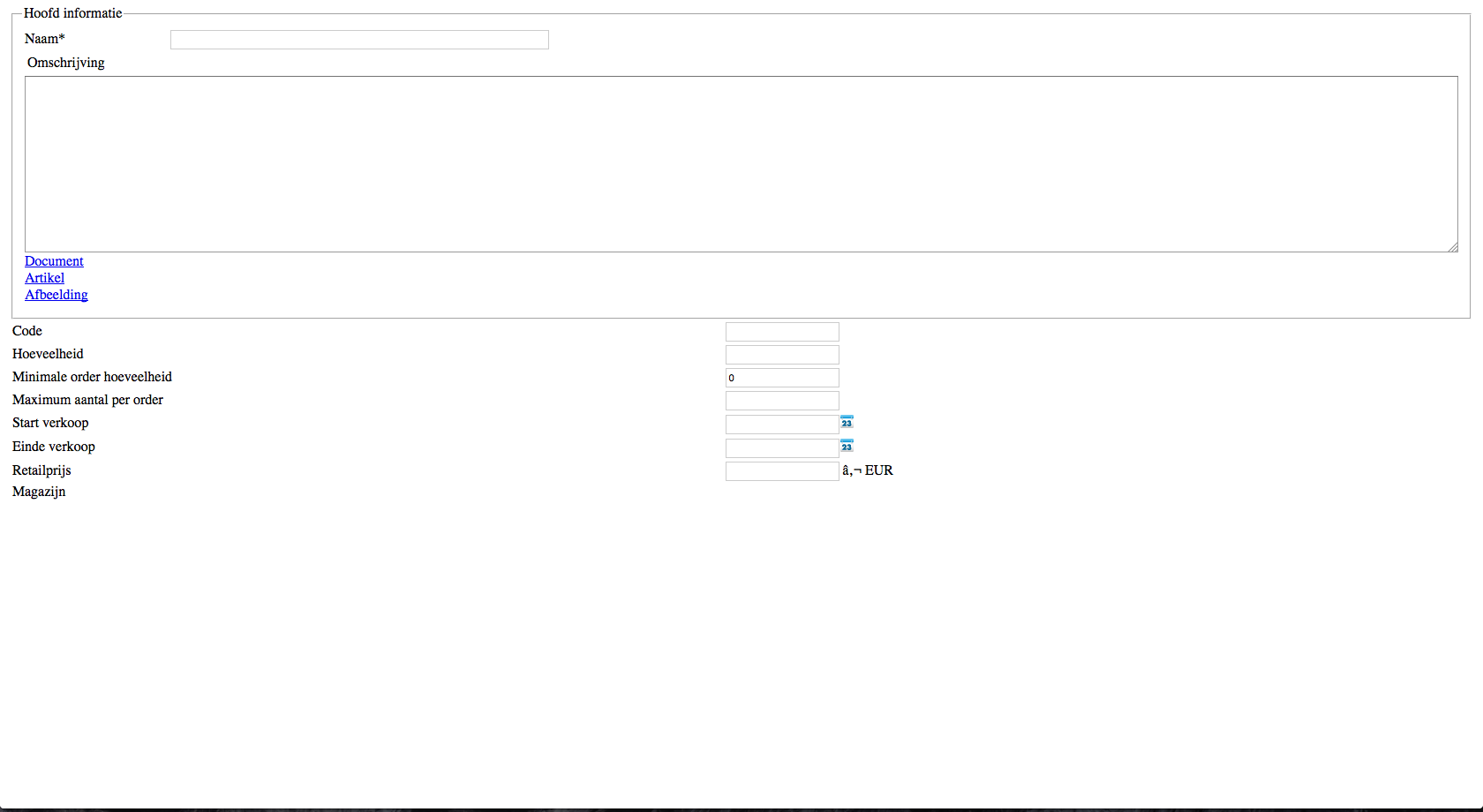

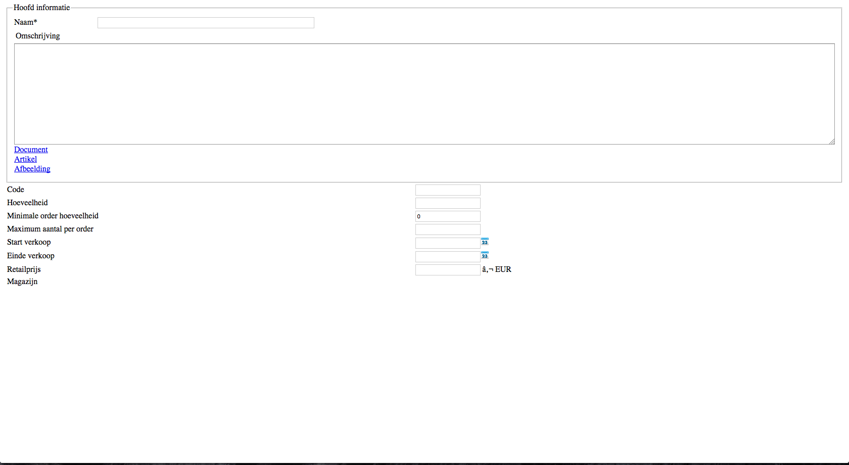

Hi, I experienced a problem I couldn't solve. I upgraded from 2.4.0 to 2.5.0 as it is always good to get the latest version before asking for help. It looks like my initial problem (finding an article to give discount) is solved. But it looks like another problem came in its place.
When I go to the backend article list and click on an article, I get a rather empty / incomplete page. See screenshot.
I tried to remove all the cache I could found (browser, Joomla, et cetera) and also did a DB check, nothing strange.

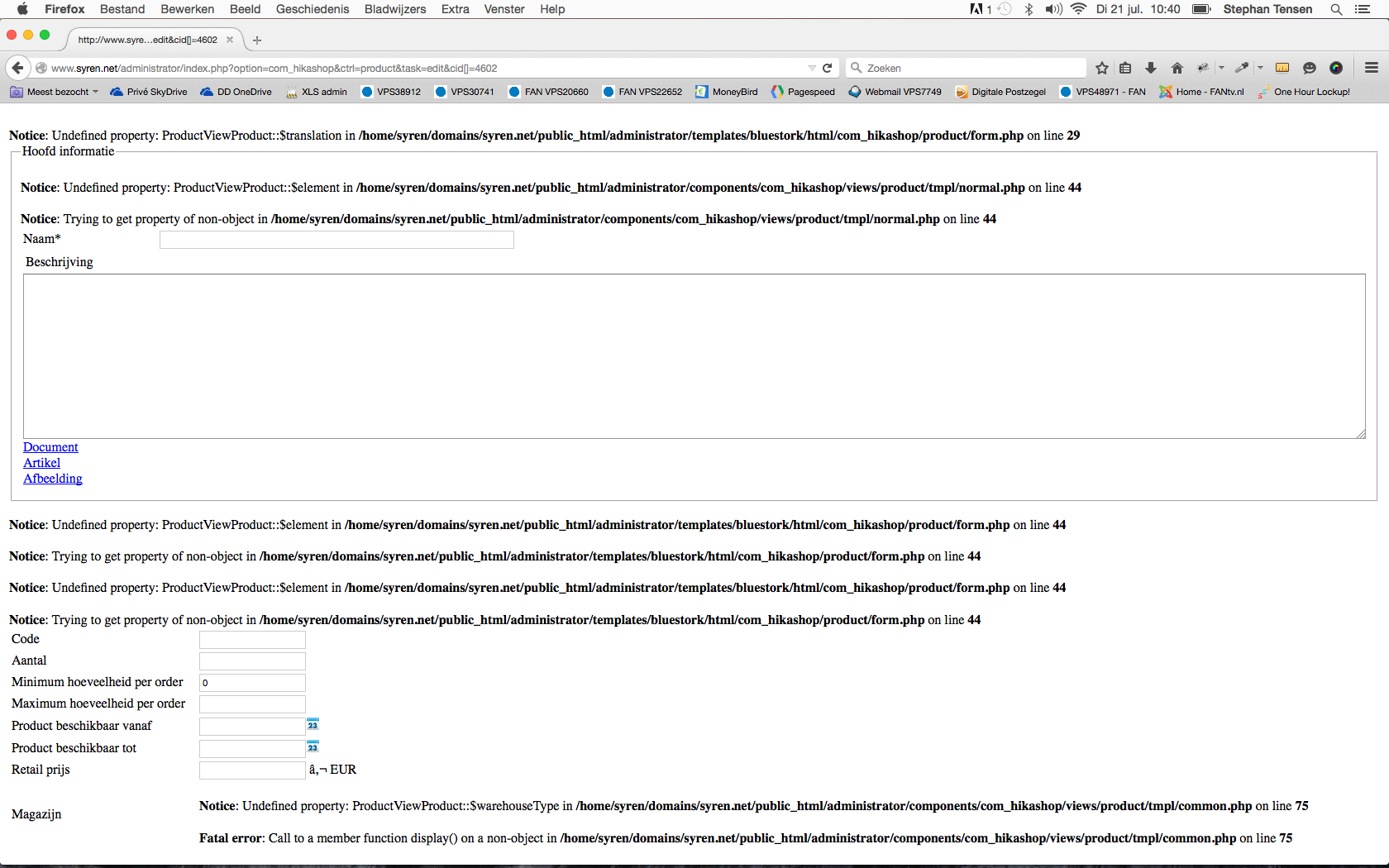

Can you :
- Activate the Joomla debug mode ("Administration->Global configuration->System->Debug System/Language")
- Set the "error reporting" option of the Joomla configuration to "maximum"
- Test it again so that you can see if it display an error message which will help you to understand from what your issue is coming.
Thanks.
  • Posts: 91

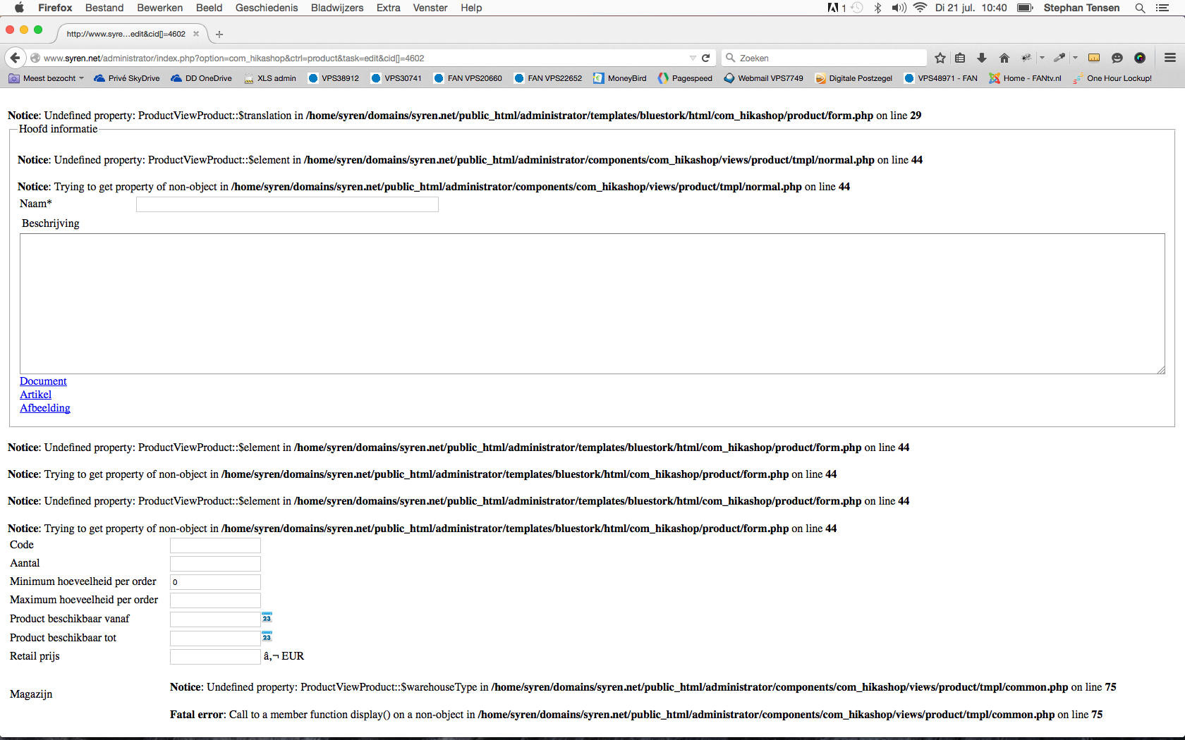

10 years 11 months ago #209033
See attached screenshot.
  • Posts: 85765
  • Thank you received: 14072
10 years 11 months ago #209035
It seems that you have a view override on the "show" file of the "product" view for your backend template.
Remove it via the menu Display->Views and that should fix the problem.
