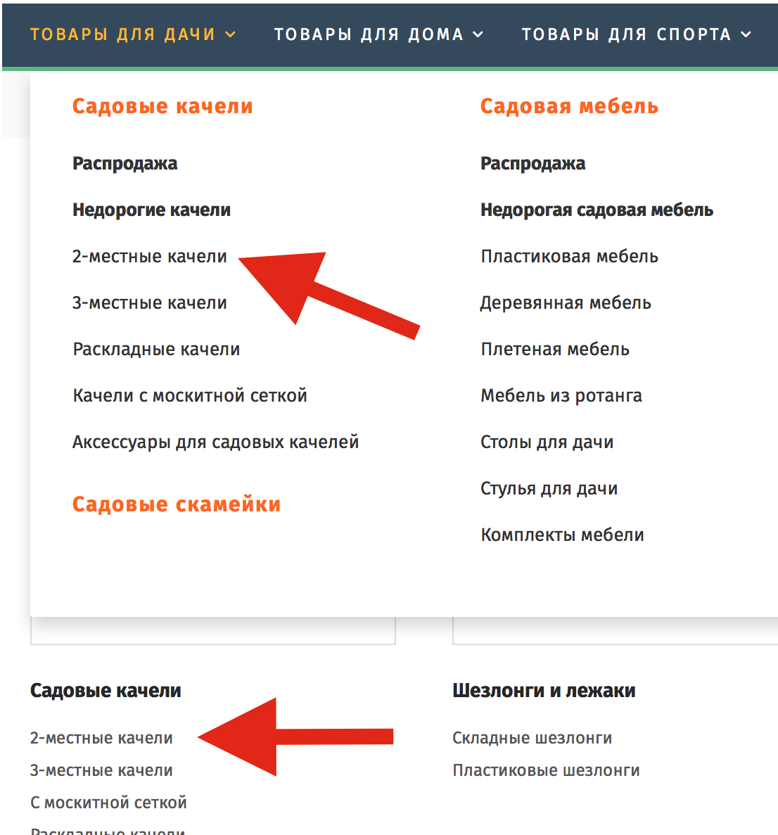

The problem is: i have main categories and subcategories. The correct path (and canonical url) should be like this:
homenland.ru/tovary-dlya-dachi/sadovye-k...li/2-mestnye-kacheli
There is a menu link, a cannonical link and i also got this link while stepping thru the parents dirs: tovary-dlya-dachi->sadovye-kacheli->2-mestnye-kacheli
but when I list categories with all their subs ( homenland.ru/tovary-dlya-dachi ), this link turns into homenland.ru/tovary-dlya-dachi/category/p2-mestnye-kacheli
That is we've got category string, and 2-mestnye-kacheli turn into p2-mestnye-kacheli
Once again, I don't need double links and I don't need homenland.ru/tovary-dlya-dachi/category/p2-mestnye-kacheli instead of homenland.ru/tovary-dlya-dachi/sadovye-k...li/2-mestnye-kacheli
Whats the heck?
Though the top level parent categories seem to have proper links

  • Posts: 29
10 years 10 months ago #209979
Unfortunately, whichever option I choose for "force canonical URLs on listings" nothing changes at all at behaviour - the link are still incorrect.
you can check here, any link for subcategory
and compare it to appropriate links in top megamenu, i.e. "2-местные качели"

  • Posts: 29
10 years 10 months ago #210221
Yes, there are canonical URLs everywhere. That is the point!
please enter here homenland.ru/tovary-dlya-dachi
See my screenshot above. You will see that links in top menu are different from links of sub-categories below, under categories' thumbnails, which are completely faulty. That is instead of homenland.ru/tovary-dlya-dachi/sadovye-k...li/2-mestnye-kacheli
i have homenland.ru/tovary-dlya-dachi/category/p2-mestnye-kacheli - which is not what I need. More over, those later links lead to nowhere. And there is category inside url, as well as alias is also with mistake
Maybe it would be better to grant you access?
