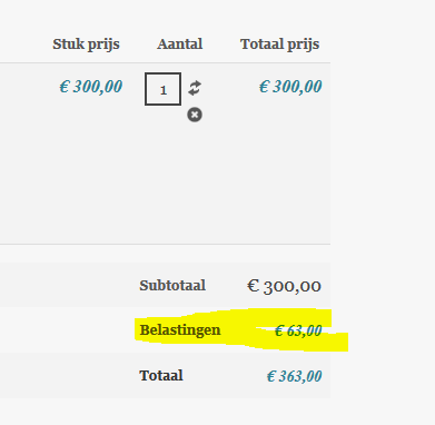

I use HikaShop to request a quote. I have a website to make the hiring party tents. Customers can place several tents in the cart. But I want not showing the taxes. Now I have it disabled in the configuration but it remains visible at the check-out and confirmationsf mailings sent.
How can I turn off all stating definitively been charged?

  • Posts: 18
10 years 10 months ago #211971
True, the products, I can turn off the load.
But the total at the checkout stands still (Card module)

  • Posts: 85765
  • Thank you received: 14072
10 years 10 months ago #211988
If you want to remove that line too, then it means that you don't have taxes anywhere, and in that case, you can simply remove or disable all your tax rules in the menu System>Taxes since they won't be used at all.
