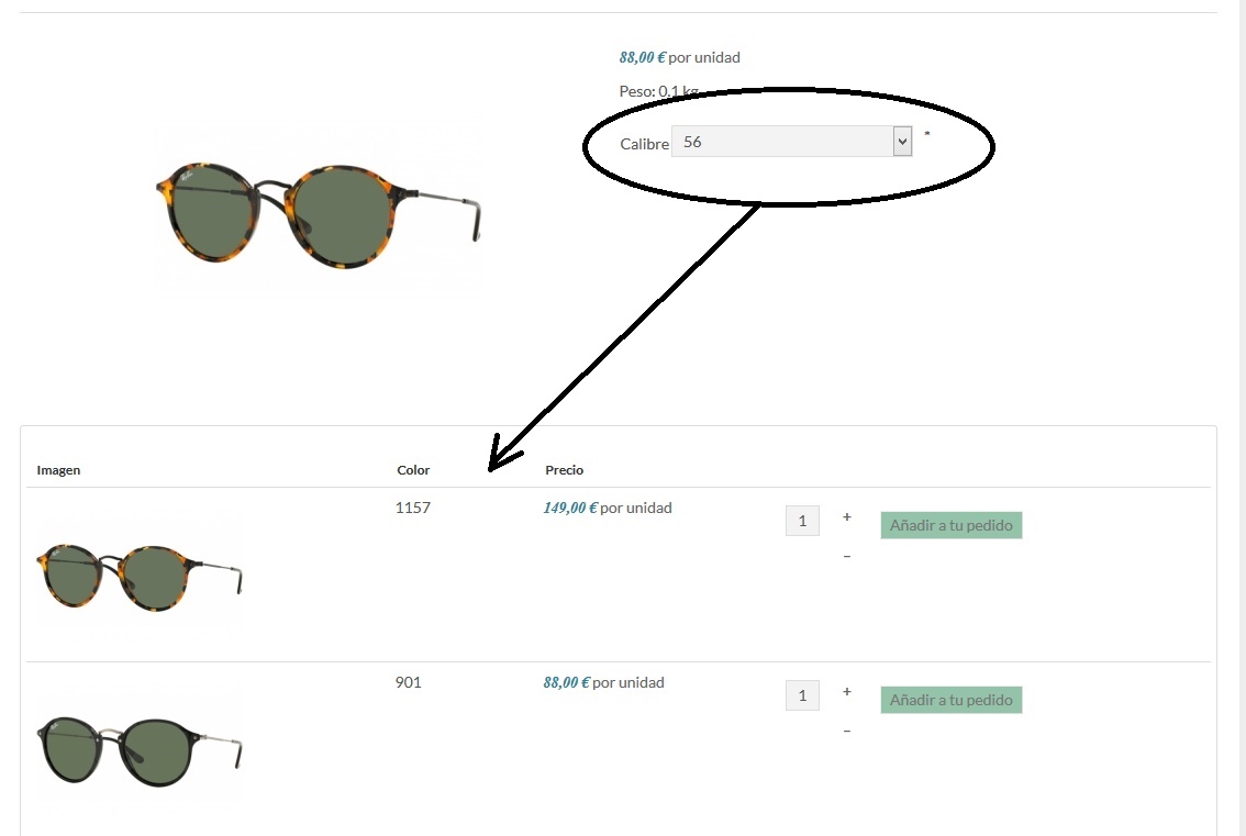

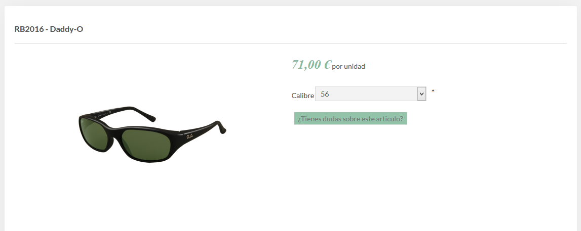

I need to add the custom field in the table below , to select the size before buying ...
I added a photo for better clarification

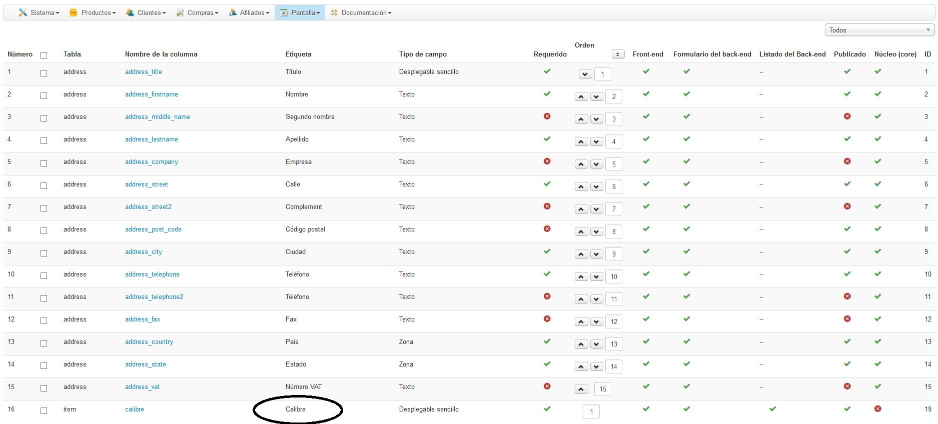

You'll have to use a custom ITEM field, and then set the "Custom item fields" option to YES through your product listing content module configuration page via "Hikashop->Display->Content modules".

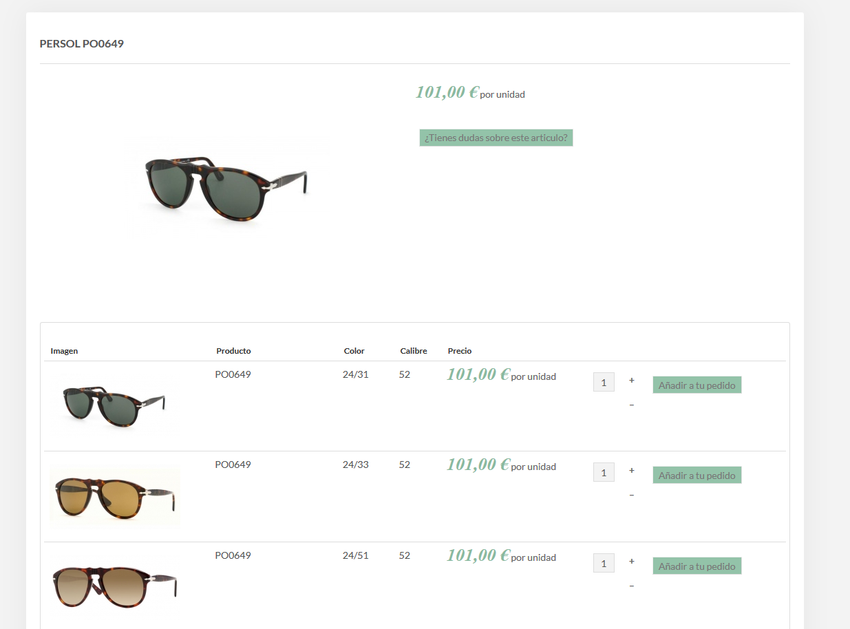

I think that Mohamed thought that your listing there was a products listing module, and not the listing of variants of the product.
It's not possible to have the custom item fields displayed in the variants table for each variant of the product.
The system hasn't been made to support that.
In that case, I would recommend instead to have a second characteristic for the size and add it to the product as second characteristic.

He just wanted you to create a new "Calibre" characteristic and add it to every product which use the "Calibre" custom Item field.

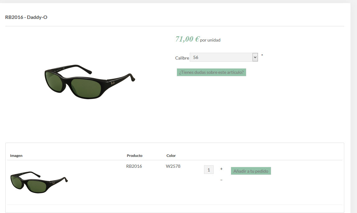

Hi, I created a custom field " Calibre " and I get to select it. But then when you pay does not leave the selected gauge "Calibre".

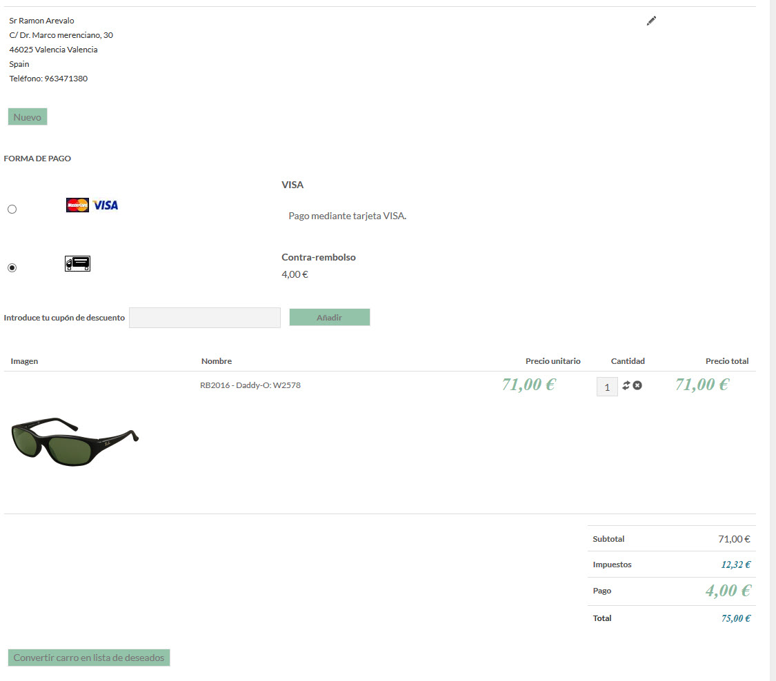

10 years 11 months ago #215728
I make custom field "Calibre"
I see the " Calibre" in the model
Now i buy and i dont see "calibre" in payment.

It's actually working fine on my end, can you give us a link to your product page so that we can directly test it ?
Thanks.

I already told you that the system doesn't support custom item fields for products with characteristics if you use the "list" display of the characteristics selection interface.
So it's normal that it doesn't work.
As I told you, I would recommend instead to have a second characteristic for the Calibre and add it to the product as second characteristic.

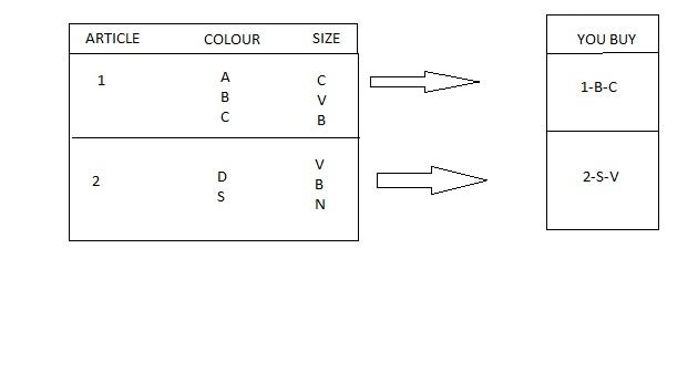

I explain how it should operate:
1 article have most colour and 1 colour have 1 or 2 or 3 sizes...but dont all colours have same sizes...
It is not easy to explain and my English does not help ...IM SORRY.....
