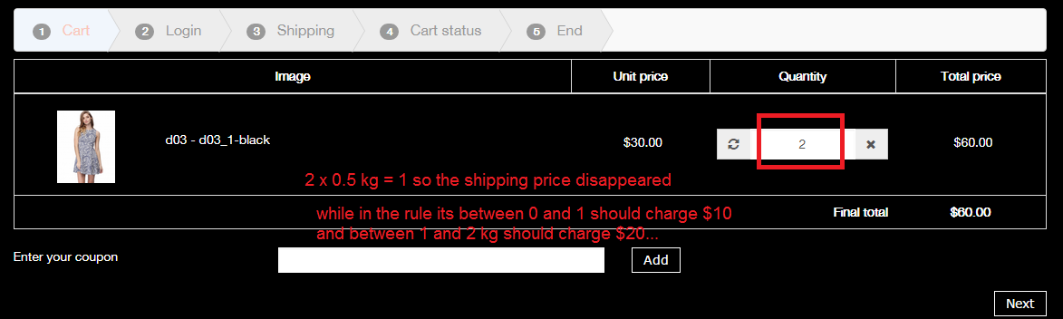

between 0 and 1 Kg= $10
between 1 and 2 Kg = $20
between 2 and 3 Kg = $30
if the total items in cart got a total of 1 kg or 2 kg exactly the shipping price disappears, but if its 1.99 it charges $10 and its 1.001 it charges $20, but if its 1 kg exactly it will charge $0.

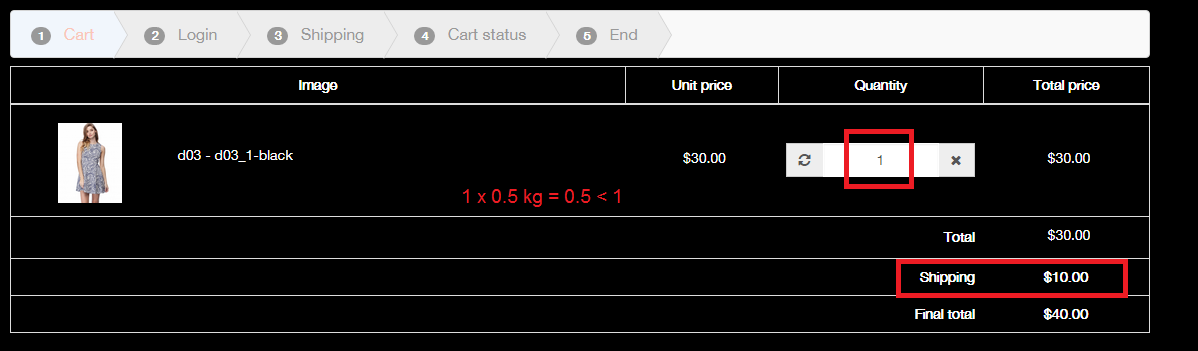

take.ms/GmvU2
- I configured a shipping method with a max eight of 1kg:
take.ms/HEthc
- I see the shipping method on the checkout for 2 items of that product in the cart:
take.ms/a73YH

See, it's as I said: take.ms/VwOp3
It's not a problem with the shipping methods weight rules since I'm still able to select that $10 shipping method with two products.
It's just a matter that the selection is removed and that it has to be added back manually.

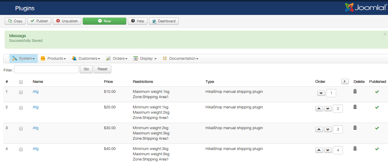

Actually the issue is that your shipping methods weight limits are not correct for what you want to do. Because one shipping method maximum weight is the same as the minimum weight of the next one, in some cases, you have two shipping methods displayed and that's why you get that behavior as it doesn't know which one to pick and let you pick it yourself.
I've changed the weight limits for your shipping methods so that they don't overlap and it works just fine now:
take.ms/WblLD
