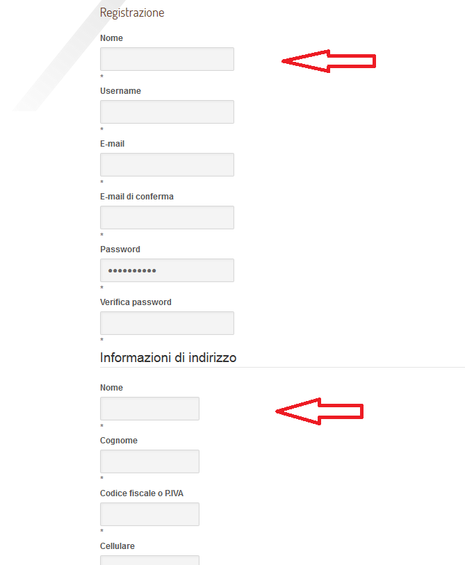

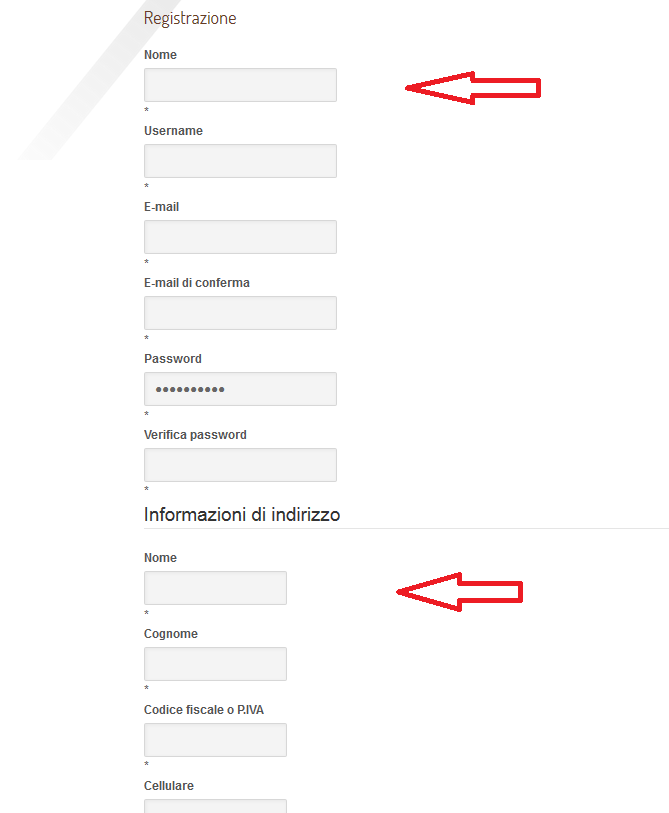

Good morning, I would like to modify the name field on the registration page because it is double
You can be removed from the registration page?
sending a picture of the current situation
thank you
  • Posts: 86089
  • Thank you received: 14195
10 years 11 months ago #215800
You can manage your address fields via the menu Display>custom fields.
Also, if you want to remove the first one, you'll want to add custom CSS on your website like that:
.hikashop_registration_name_line{ display: none; }

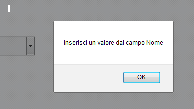

  • Posts: 22
10 years 11 months ago #215882
Thanks Nicolas, but it remains a problem! the field is hidden but the field "name" is required for registration and joomla is required (see picture attached).
How can I set that the field is completed by the "name & surname" or something?
  • Posts: 86089
10 years 11 months ago #215899
Then, change the "registration" setting of the HikaShop configuration to "simplified registration with password".
That will remove the name and username fields from the form automatically for you and the system will auto complete them.
