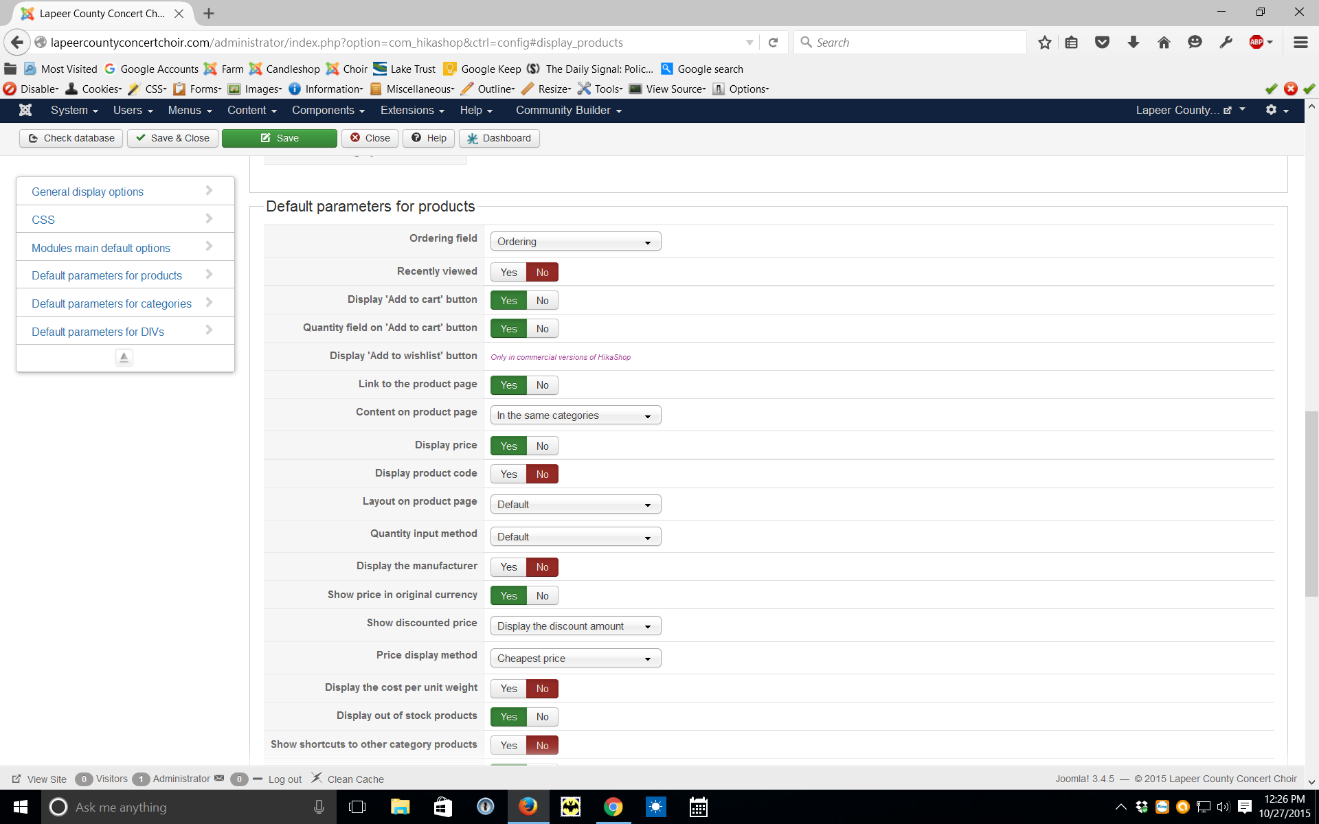

My "Add to Cart" button disappeared - It was there a few months ago but I checked it recently and now it is gone. We only use the program for seasonal events and now it is missing?
Tried the error reporting and the ****??PRICE_BEGINNING_0??$10.00 ** each**??PRICE_ENDING_0??****
showed up on the front page screen. I will need it back in a few weeks.
The Hikashop starter is installed now - I may want to use the Hikaserial if things work out - it is used for selling tickets.
10 years 10 months ago #218586

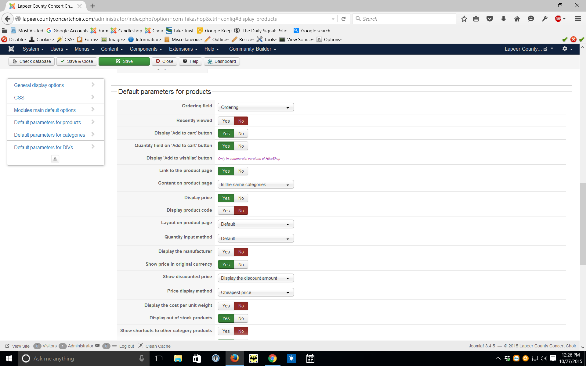

Please check that the option "Display 'Add to cart' button" is enabled in Configuration > Display > Product.
Which "Quantity input method" are you using ?
Do you have view overrides on the view "product / quantity" ? If it is, please back it up and remove the override.
To check if it is an override issue, you can too try to use another template temporarily.
  • Posts: 254
10 years 10 months ago #218634
"Display 'Add to cart' button" is enabled - see attached image

Can you make sure that you didn't turn on the "catalog mode" setting of the HikaShop configuration ?
  • Posts: 254
10 years 10 months ago #218684
Thank you - That was the problem.

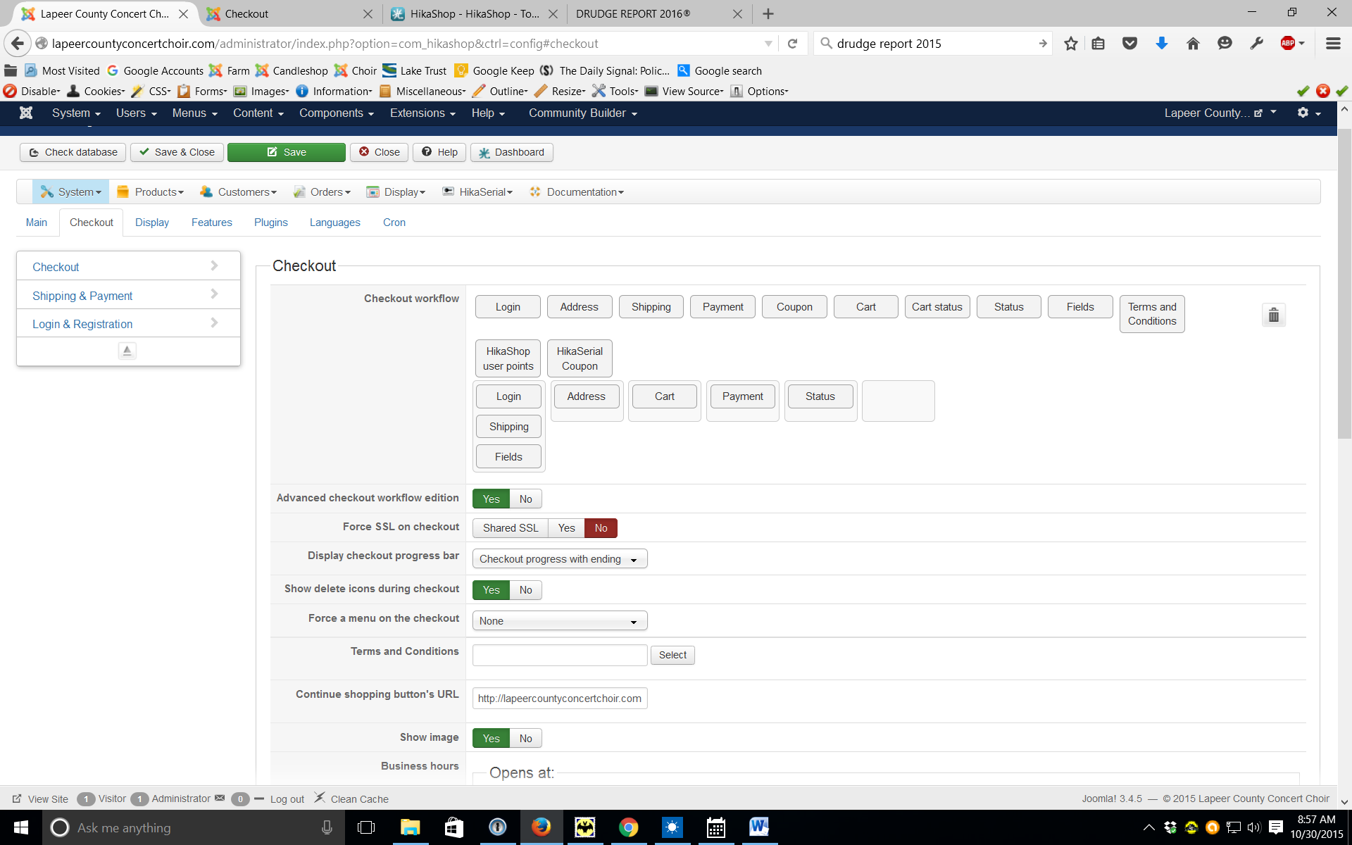

I am having and issue now with my checkout. The cart works fine until I get to payment and the only one I am using is Paypal.
When I try to go past payment, the page goes back to login.
Here is the page in question lapeercountyconcertchoir.com/index.php/c...concert-tickets.html
I have not done any setup with HikaSerial yet. But this is the same problem I was just having with hika starter.
10 years 10 months ago #218925

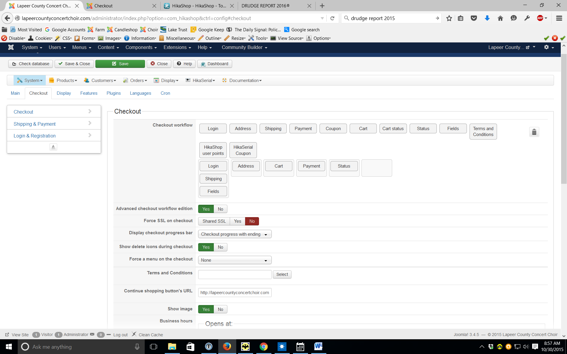

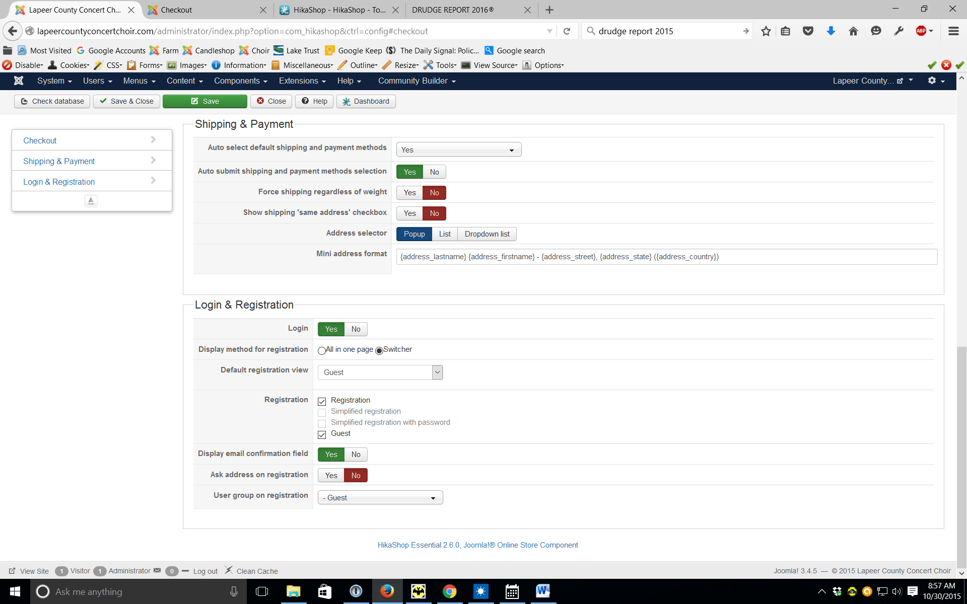

Please give us screenshots of how you set up your checkout workflow and other settings related on the checkout in Configuration > Checkout. This will help us to find the issue.

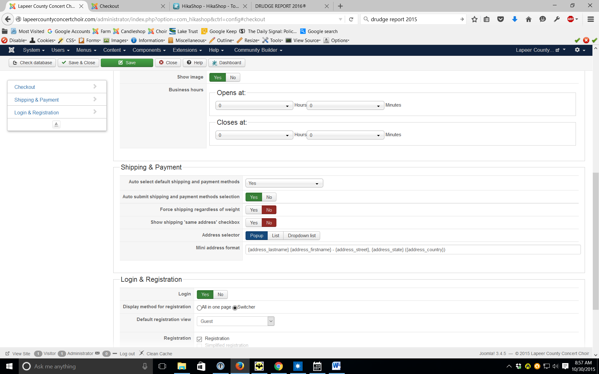

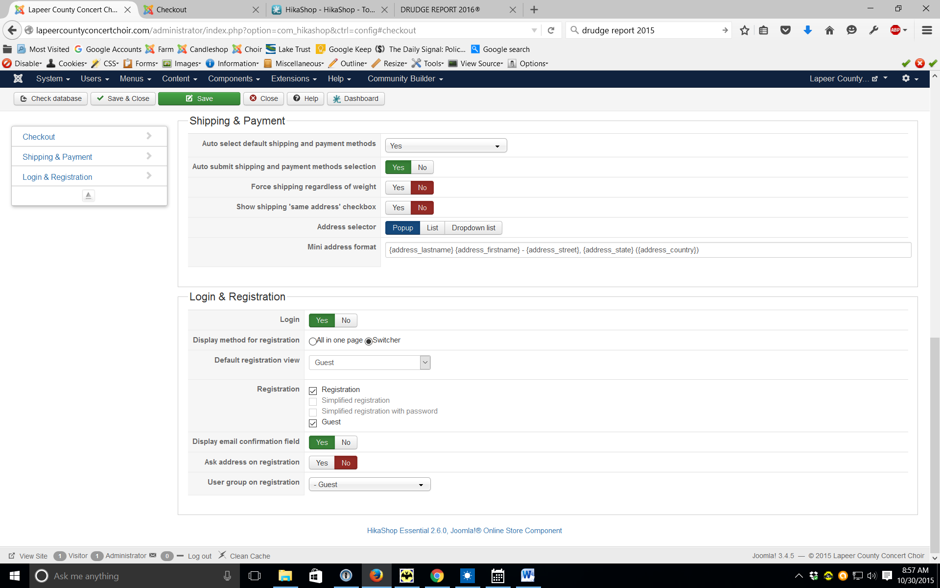

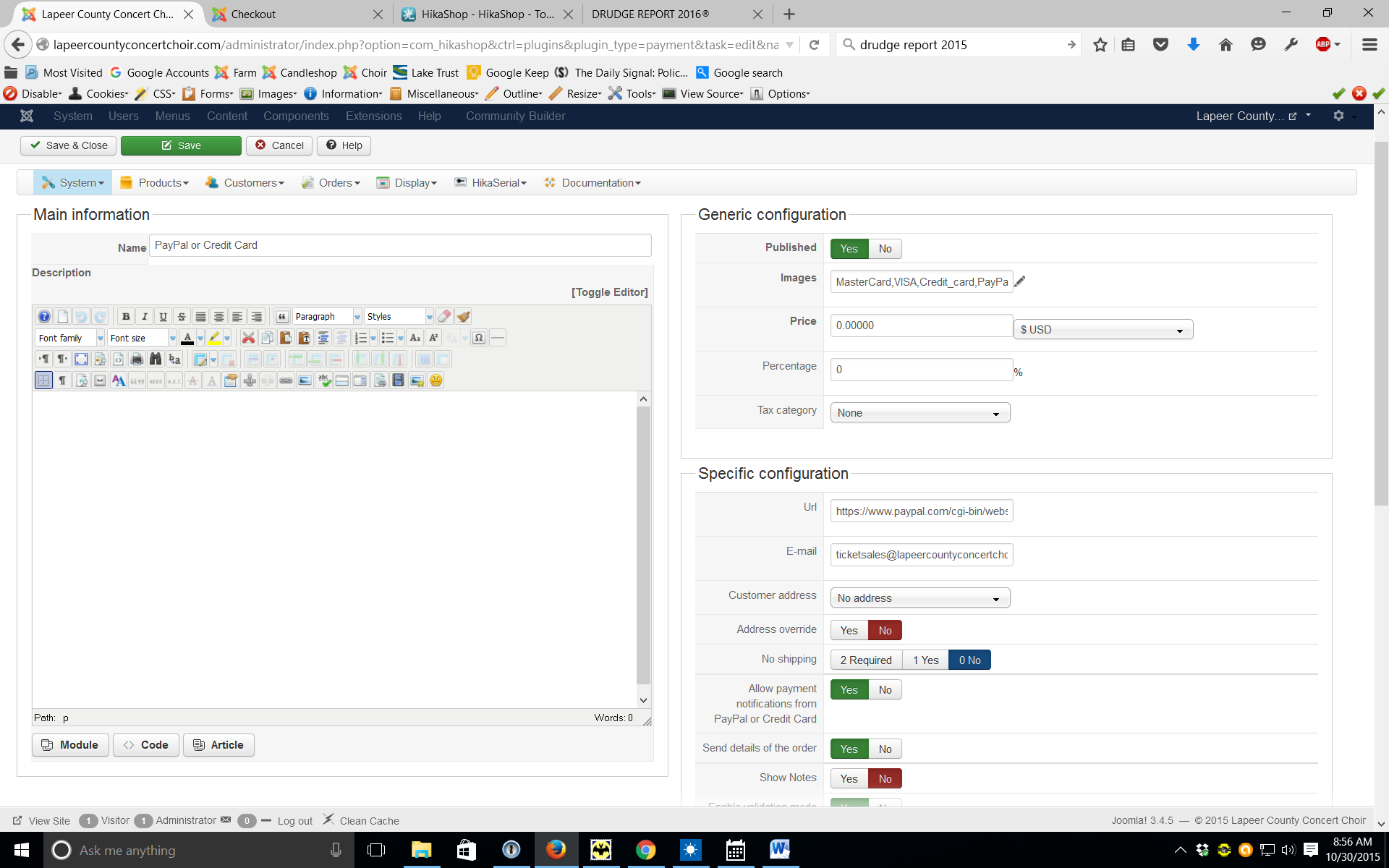

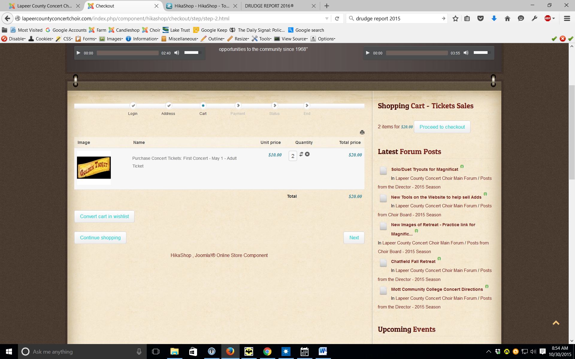

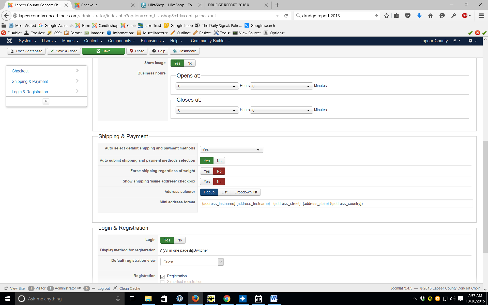

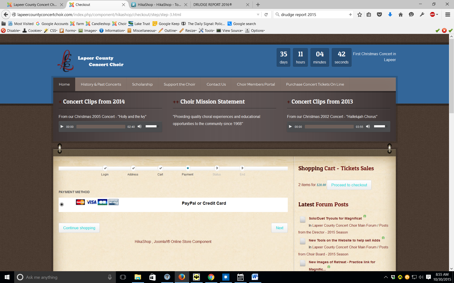

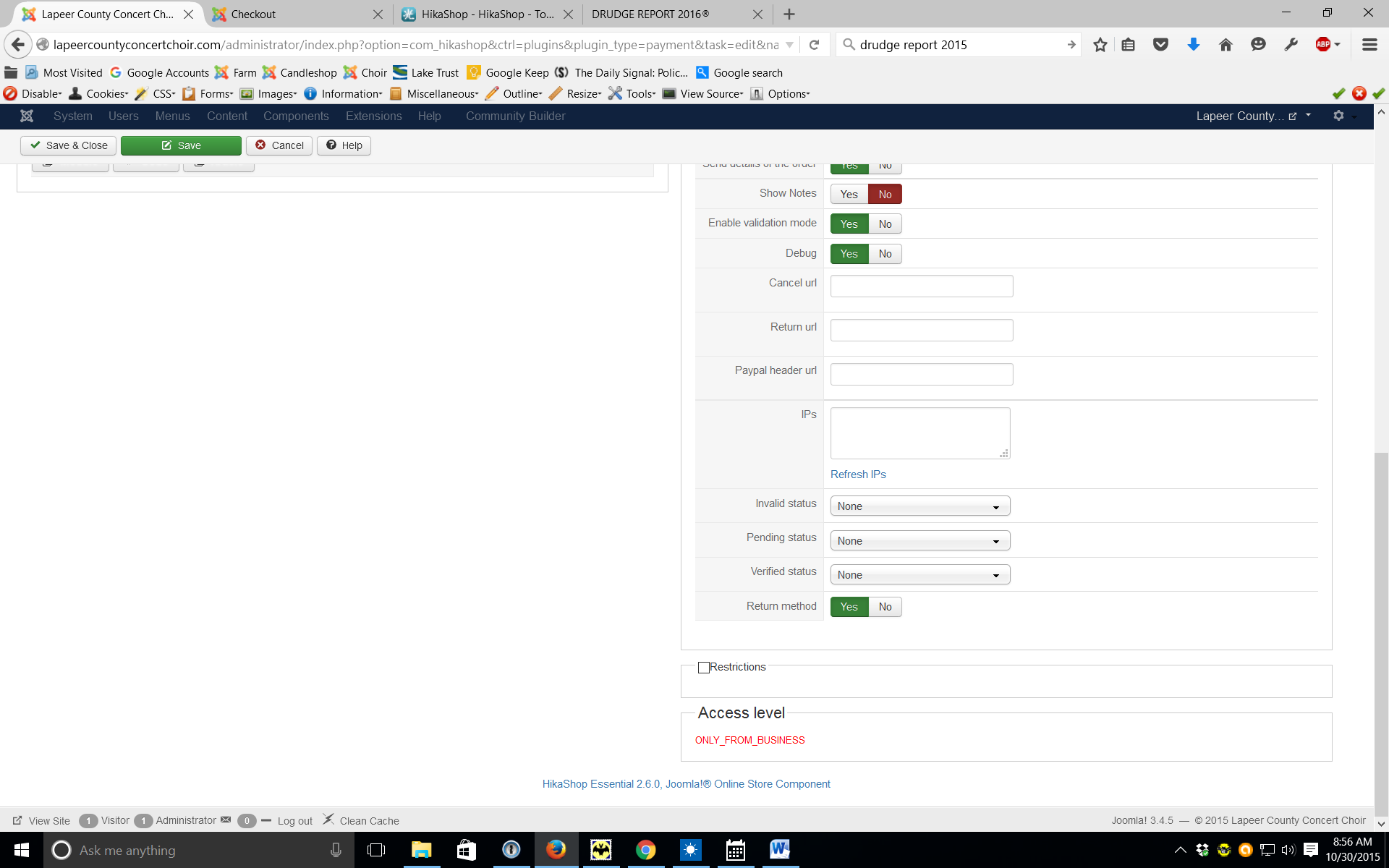

  • Posts: 254
10 years 10 months ago #218955

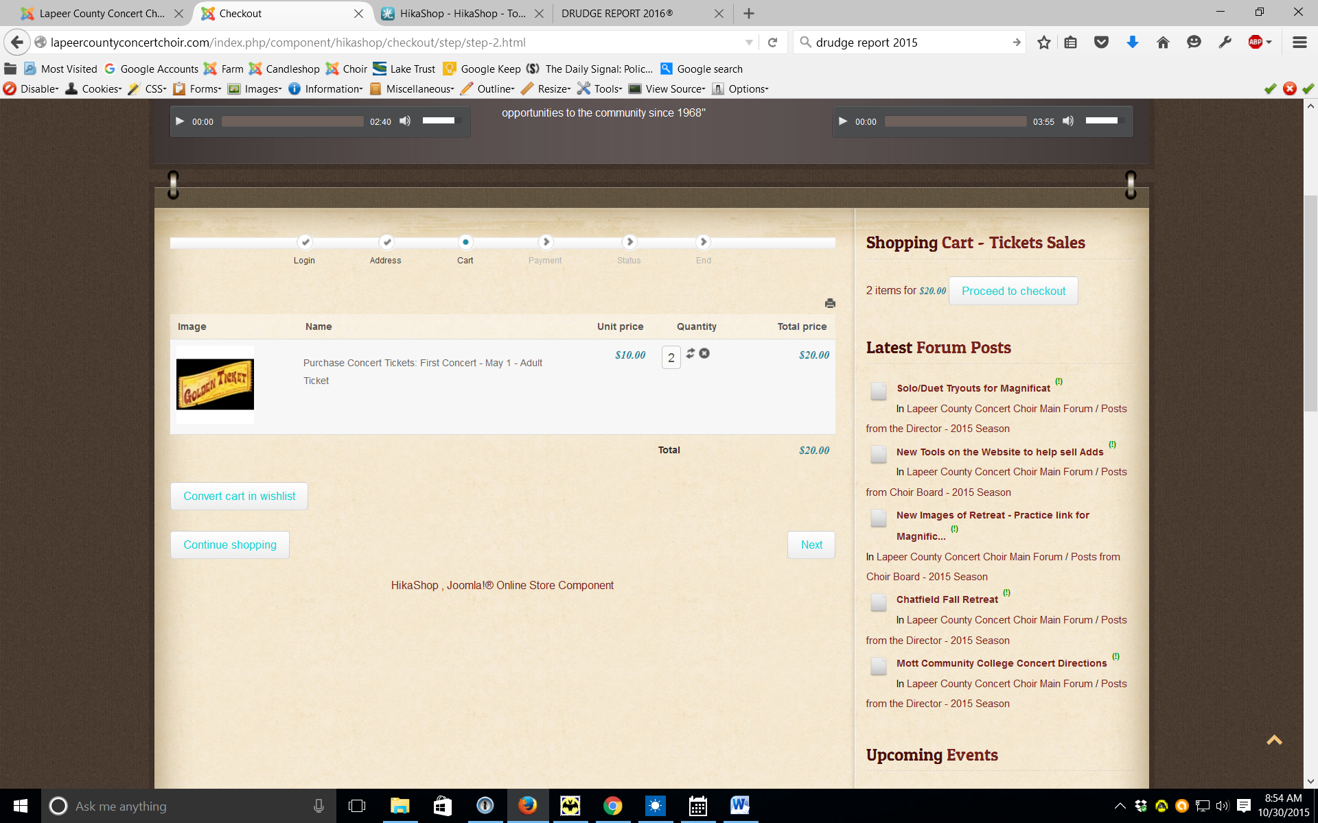

Here is what is happening:
The product page comes up just fine:

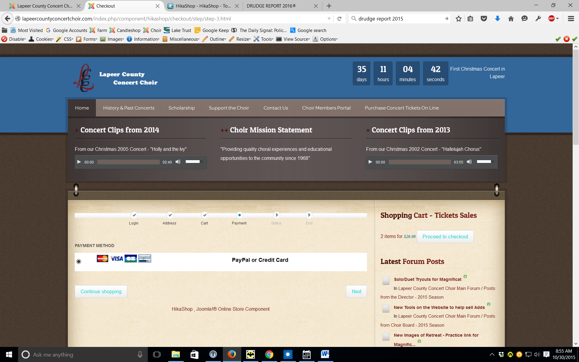

The Paypal page comes up just fine:
Then when I select next this page comes up:

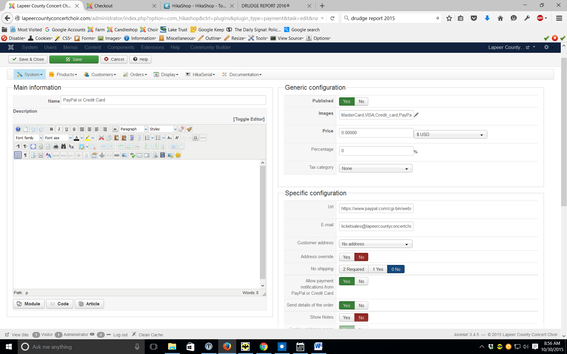

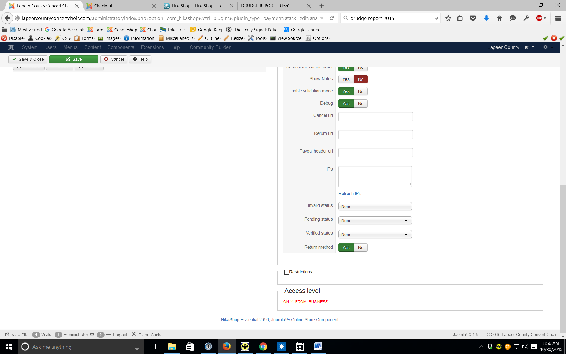

Heck are copies of my checkout screenshots:
Last edit: 10 years 10 months ago by bigfoot. Reason: more screenshots
  • Posts: 86087
  • Thank you received: 14194
10 years 10 months ago #219057
The problem is that you have the address and the shipping views in the wrong order. The address view will reset the shipping selection (since the shipping usually depends on the address) so you're supposed to set the shipping view after the address on your checkout.
Do that and it should work fine.
