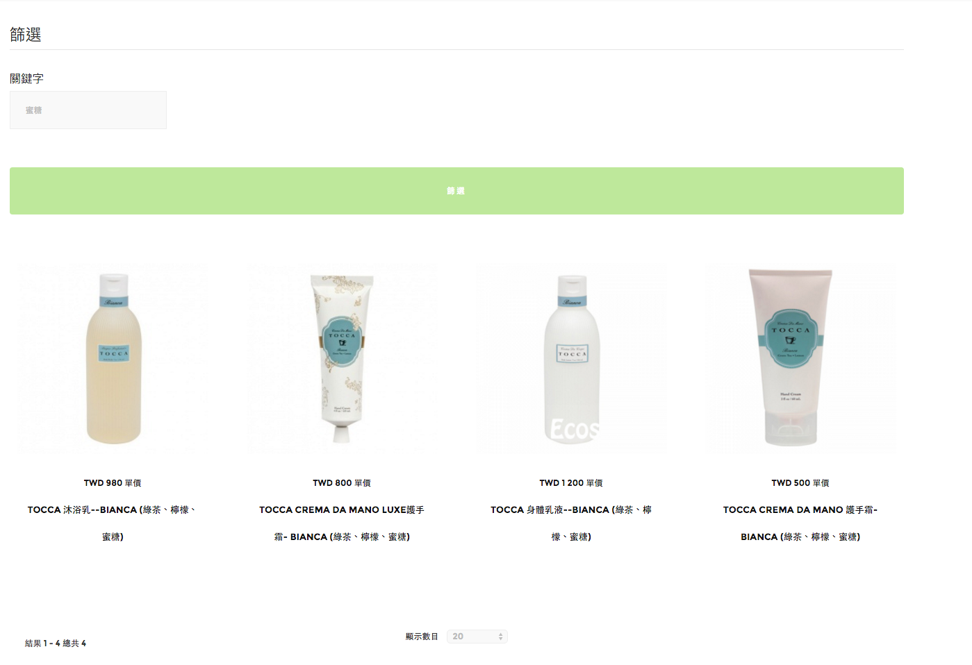

Hello ,
My client's website using Balboca's gravex template.

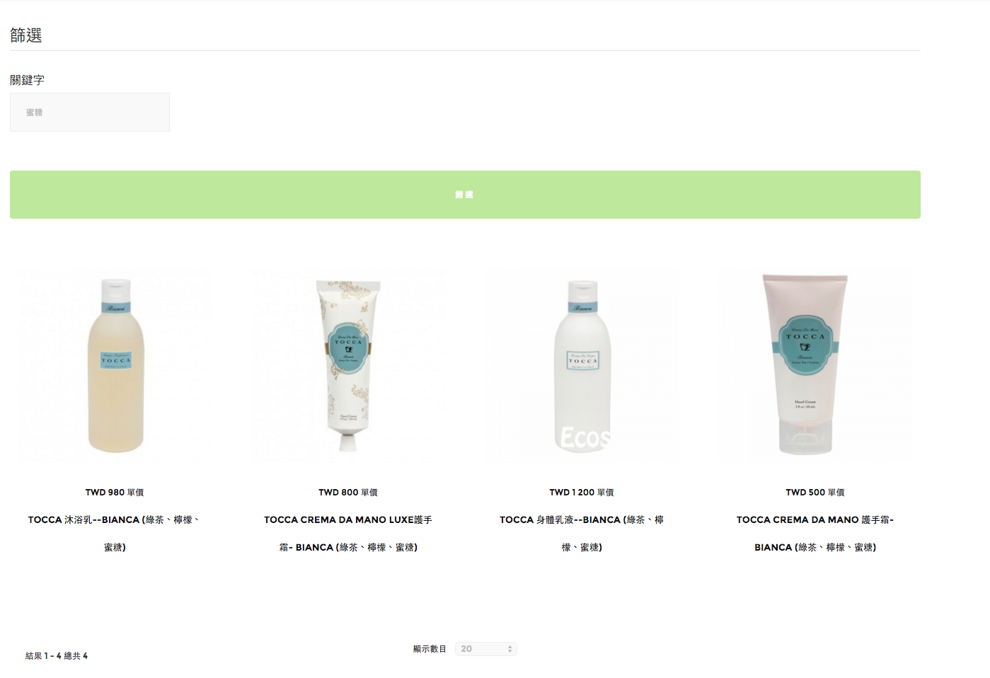

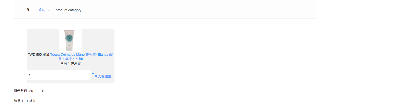

While using the filter function from menu item setting, there is no problem.
But when using the filter by module , the result page is different from gravex's.
You can check the attachments to know what I mean.
Or from the search page url: libelle.com.tw/zack/index.php/search
(PS: you can type "TOCCA" to search)
How to unit them to the same page?

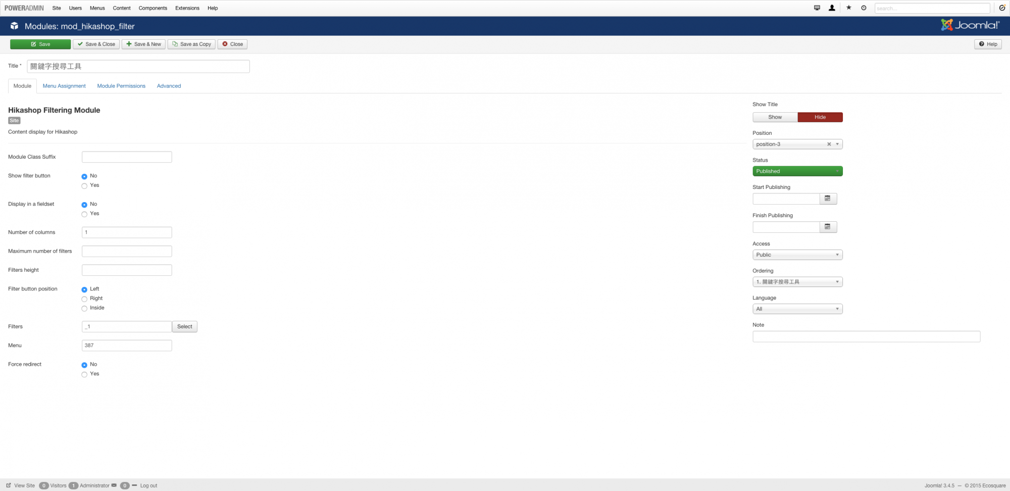

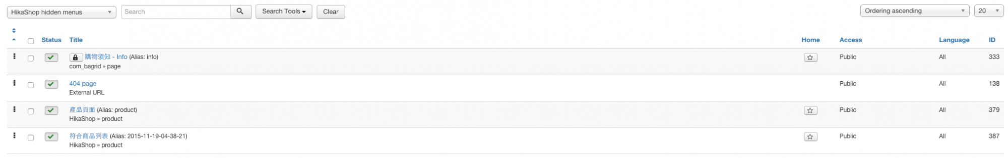

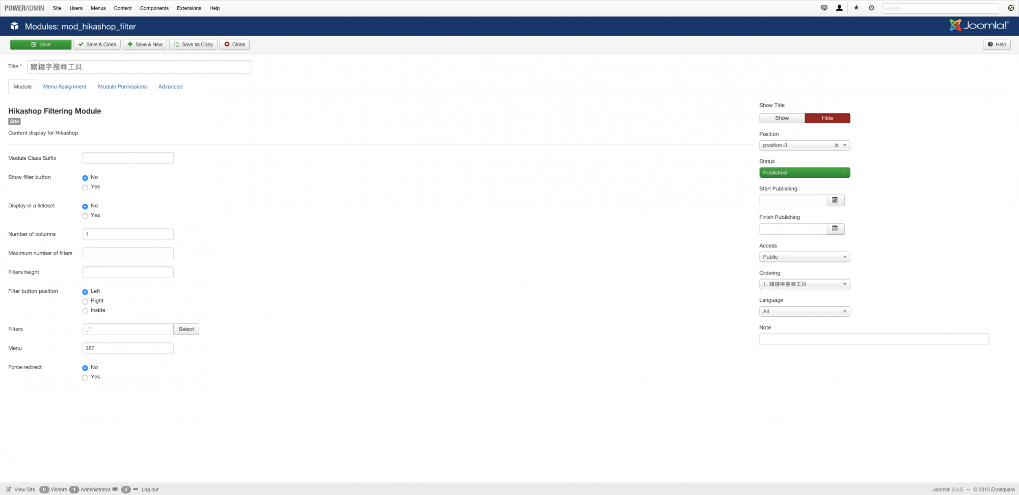

In your case the best solution will probably be to directly set the "Menu" option of your Filter content module configuration page to the ID of your product listing content menu where you want to be redirected after using your Filter module.

Hello~
Due to lack of step by step tutorial , I have to guess the settings.
I tried to do the settings but with no luck.
You can see the picture to check my setting if correct or not.
(PS:I have tried to set force redirect to true , but the page is wrong.That's why I close it)
While I close the force redirect , the page function seems what I want. But I have another question.
Normally , the search function should start with no result.Until user do a search , page come out the results.
I use hikashop products list to do the page , and set root category in order to check all products.
But I don't want to show all product at first time until search done.
How to implement it?

Then simply create another menu item of the type "joomla article" and in the article of the menu item, insert the HikaShop filter module:
docs.joomla.org/How_do_you_put_a_module_inside_an_article%3F
That way, when you access the menu, you'll see only the module, and when you use it, you'll be redirected to the products listing menu item for which you specified the id in the "menu" option of the module and you'll see the results there.
So it will work like the search system of Joomla.
