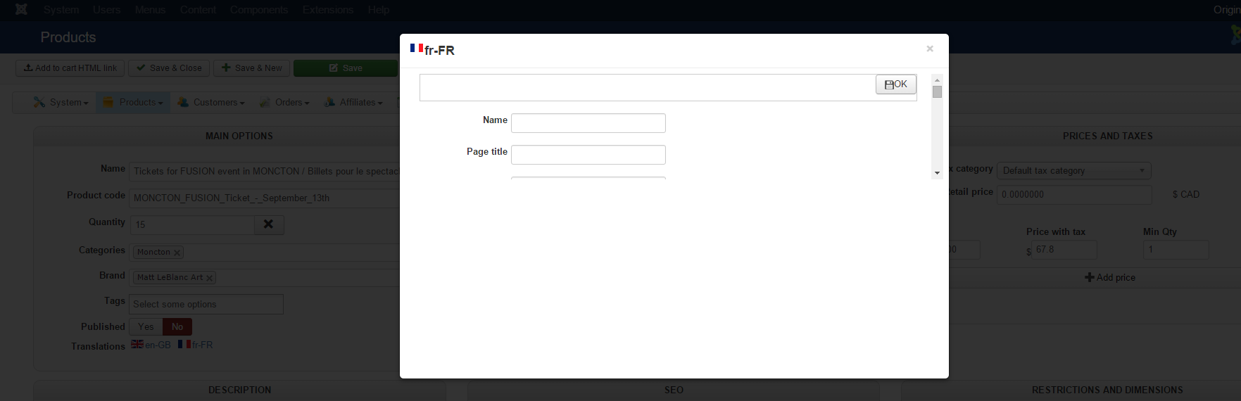

-- Error-message(debug-mod must be tuned on) -- : When clicking the Translation button inside the products page, the box comes up very small and need to scroll. FaLang (Stephane) said this popup box is from Hikashop. Screenshot attached
I have confirmed that if I install a fresh copy of Hikashop 2.6.0 and a fresh copy of FaLang 2.2.0 (both latest versions) on a new website, it does not cause this problem. It is currently assumed that something during the upgrade process went wrong and caused the problem.
so basically, the website has been using Hikashop for years and have always upgraded on each release without any error or obvious problems. Since 2.6.0 though, the Translation box from FaLang you click in the products page comes up with a popup that extremely small and require a lot of scrolling to work with (as shown in attached image).
I have work with Stephane from FaLang with this and he's concluded that the popup is coming from Hikashop so it is out of his hands to resolve. Quote" This popup is done by hikashop it's not the Falang quickjump popup."
So here I am reaching out for a solution. Something with the upgrade must have caused a conflict with old CSS of some sort which is causing the box to pop up so small.

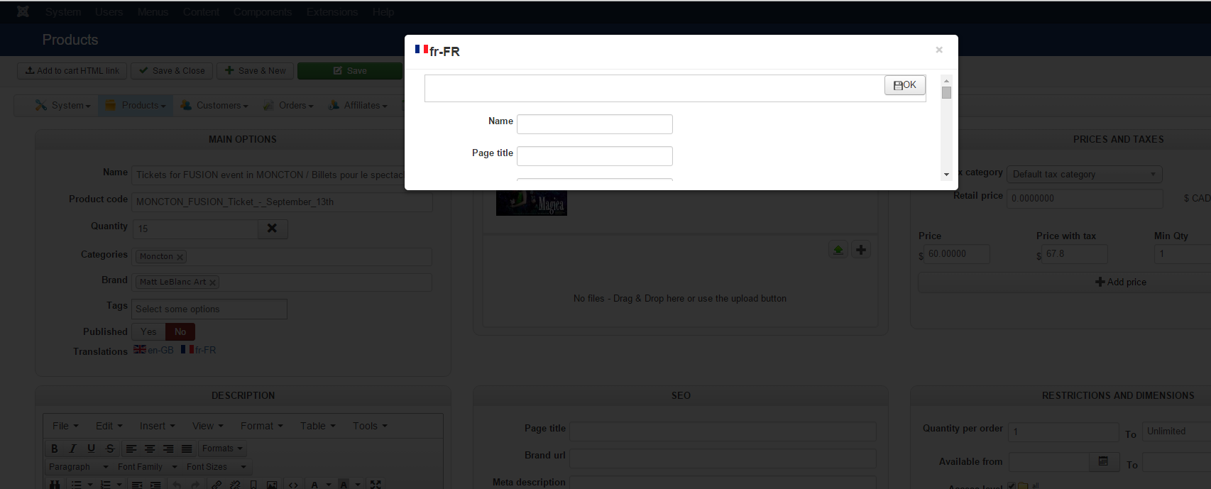

Well, it looks like we're heading the right direction but it still doesn't work. I have attached the end result. I made sure to test in Incognito.

Your issue is related to a Joomla 3.4.4/3.4.5 issue with the modals.
Depending if you have a github patch or not ; you can have an issue or not with the popup parameters.
In the first time, you can revert the Nicolas' patch.
Then you can override the view "backend | your backend template (isis I guess) | product | form" and replace
By
So it will remove the HTML content in the popup title and avoid that Joomla bug to skip the popup height and width.
And I'm counting the days before the next HikaShop release so we could finally stop using the Mootools Squeezbox and the Bootstrap modal !

Thank you, this seemed to have fixed it!!
I did end up changing the line
760, 480, '', '', 'link'
to
950, 800, '', '', 'link'
since I found the box still a bit small to work with. Looking good now!!
