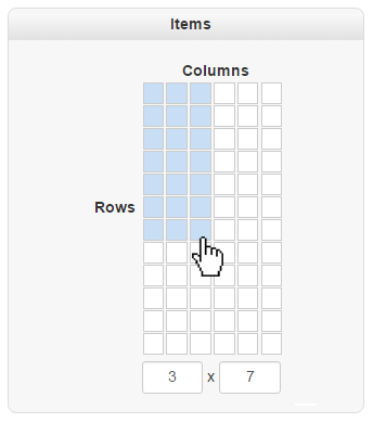

10 years 9 months ago #221645
1) To define the way to display elements go here:
- Menus -> HikaShop default menus
- here select the required item menu, click on Categories Options OR Products Options
- Click on desired layout type tab.
- See the Items part? This where you can define 1, 2 or more column etc...
As usual don't forget to save your changes!

  • Posts: 61
10 years 9 months ago #221733
In the module and menu its set to 4x5 and I still see one column.
If you check the entire site, since I enabled bootstrap everything is one column.
What could I be doing wrong?
[ps. I was enable to enable shadowbox]
