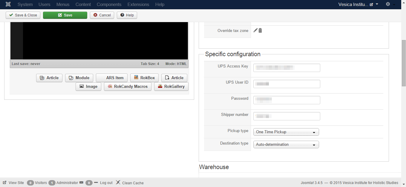

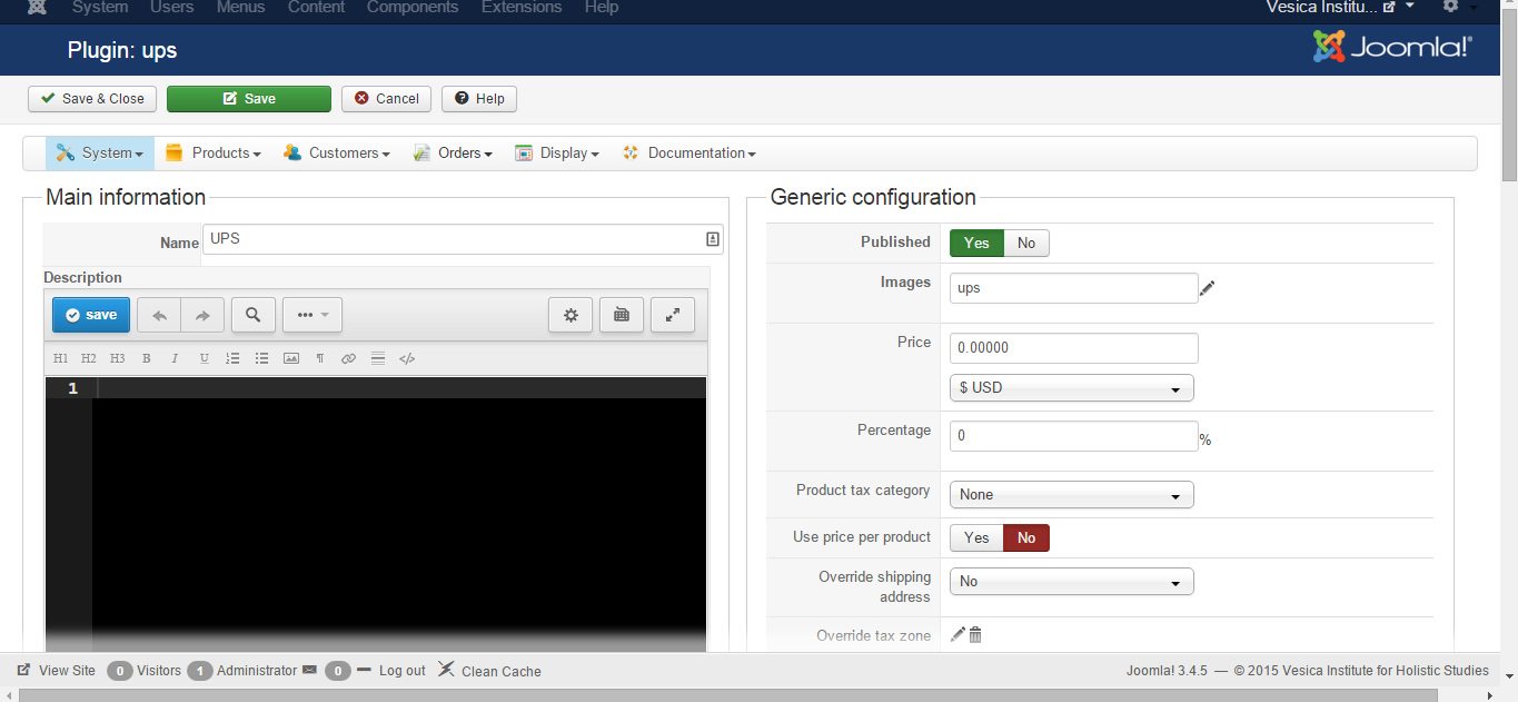

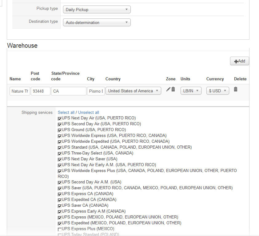

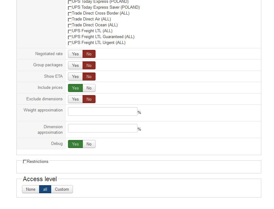

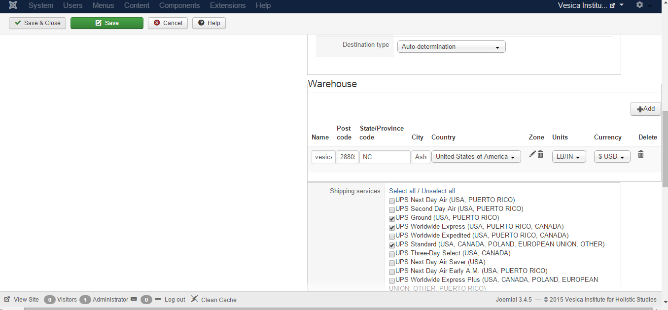

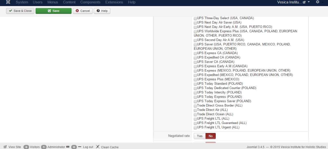

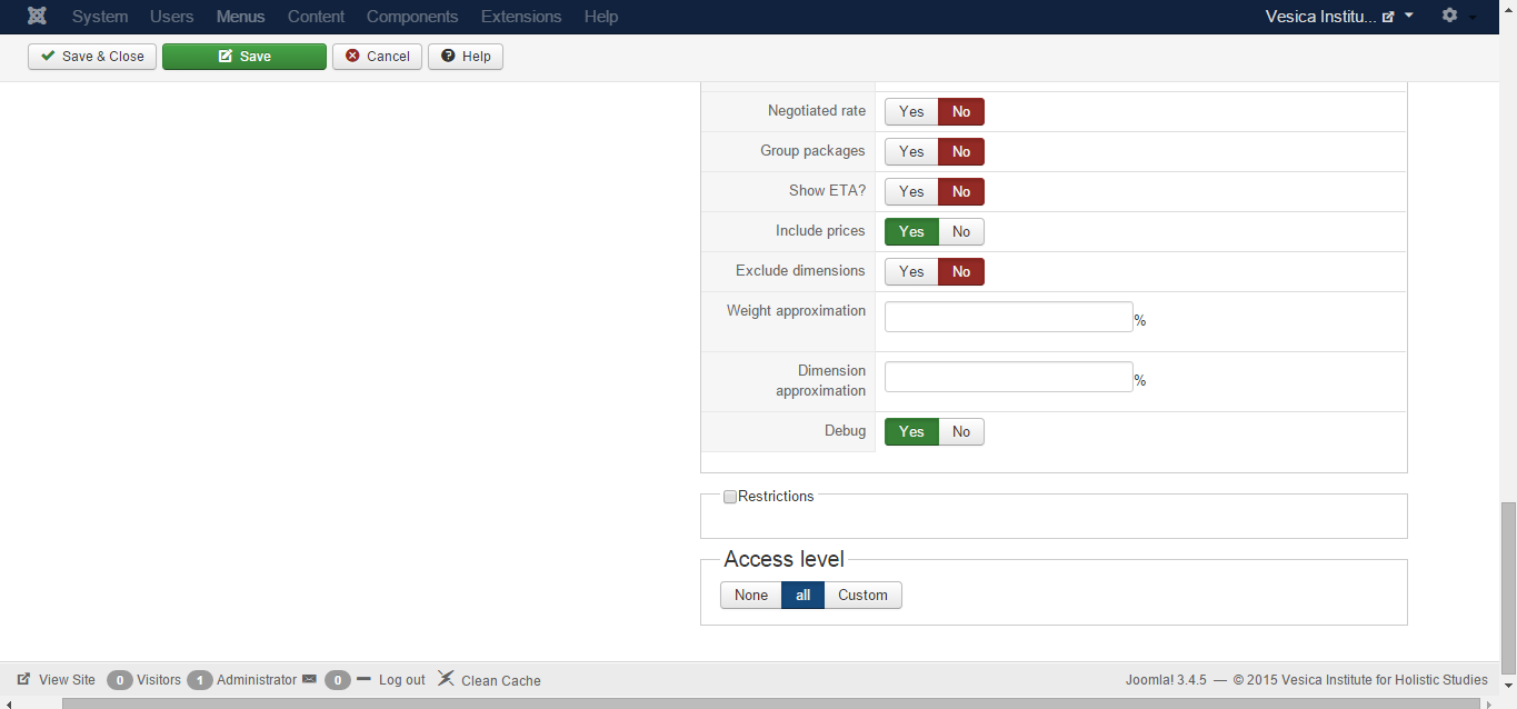

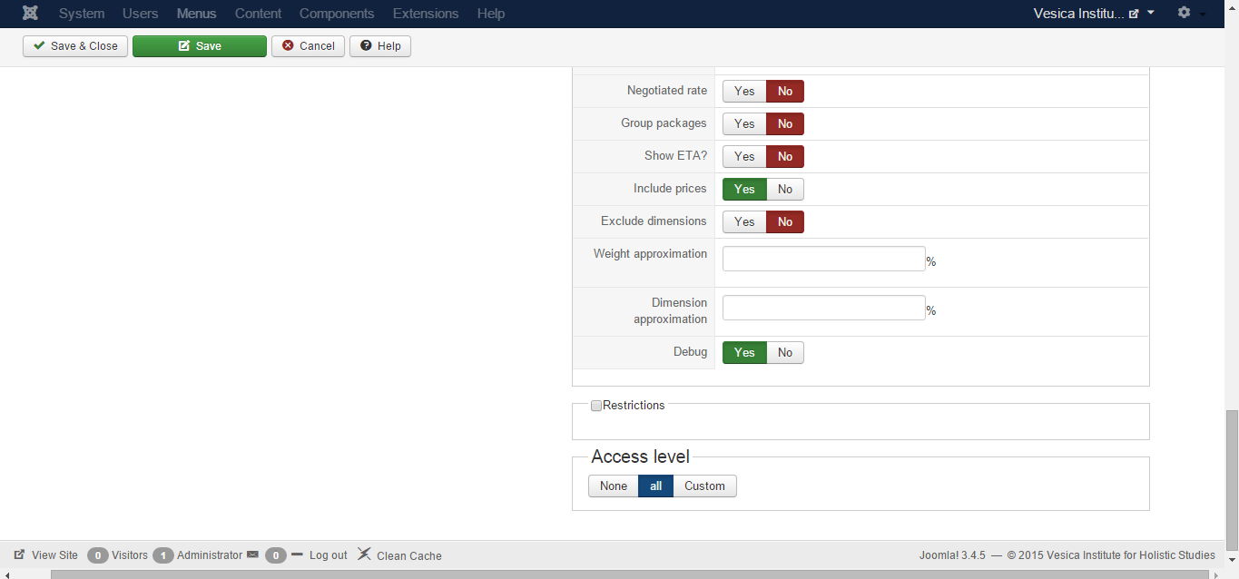

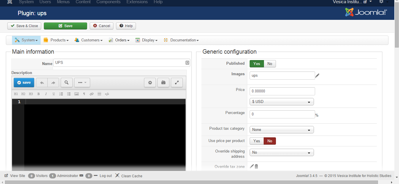

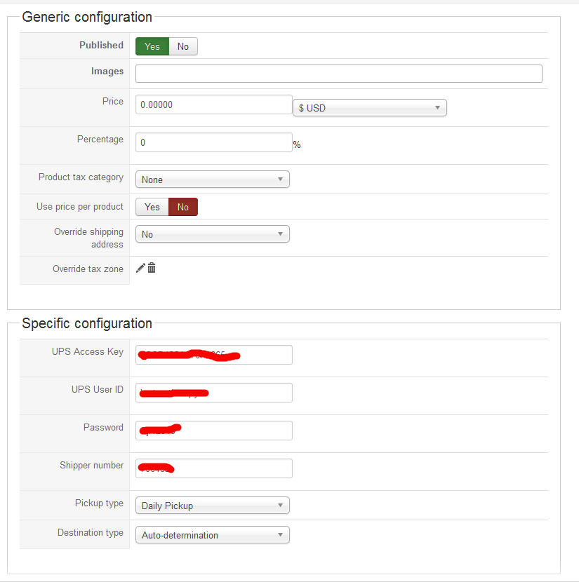

  • Posts: 162

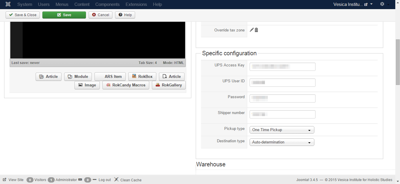

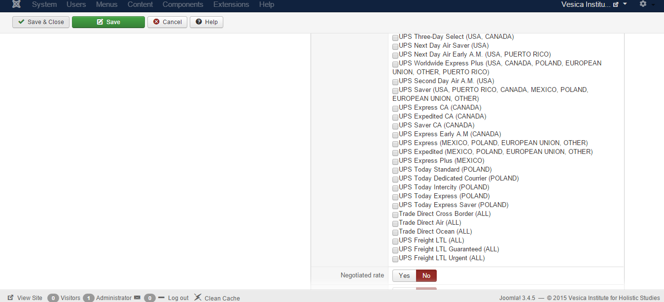

10 years 9 months ago #222203
I've attached to this message screenshots with all UPS plugin settings. Some private information like logins is blurred for obvious reasons, but if you need I can give you access to back-end.
thanks!
10 years 9 months ago #222226
Your UPS shipping method is correctly configured so you shouldn't have any retail rates with the "Negotiated rates" and "Group packages" options turned off.
Note that you can add a default price value to your UPS rates by using the "Price" option of your UPS shipping method, but in your case, your shipping method is correctly configured and is sending your product 1 by 1 with the "negotiated rates" option turned off.

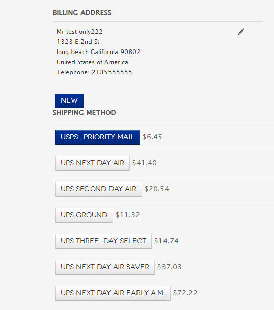

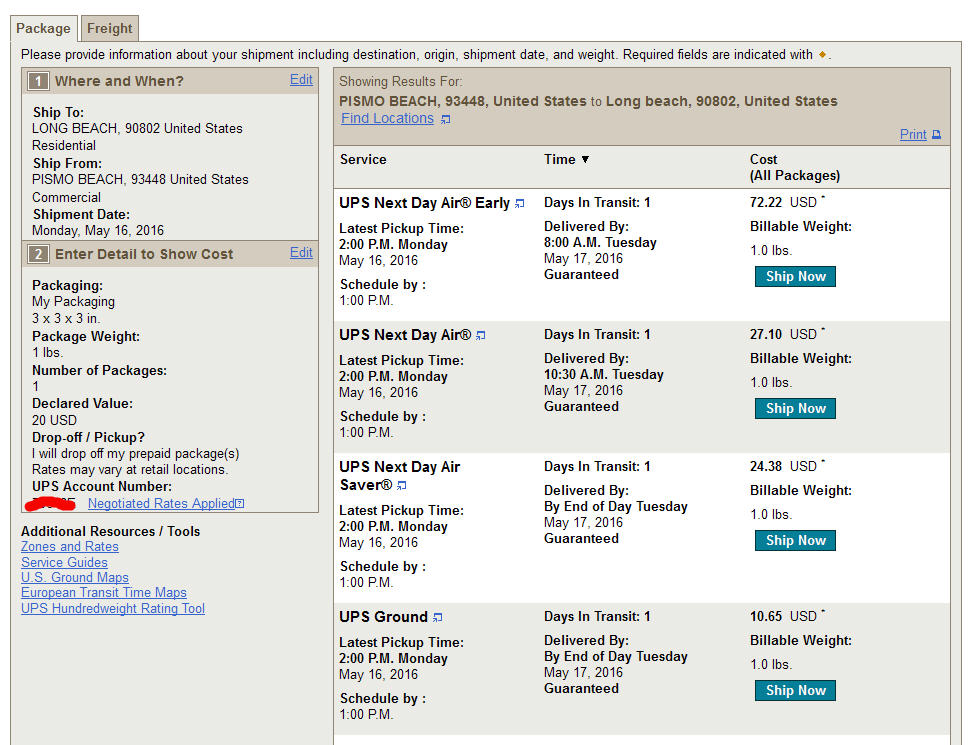

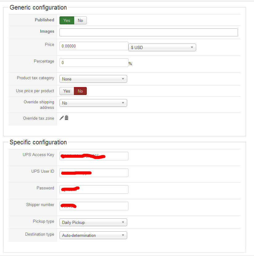

  • Posts: 14
10 years 3 months ago #240280

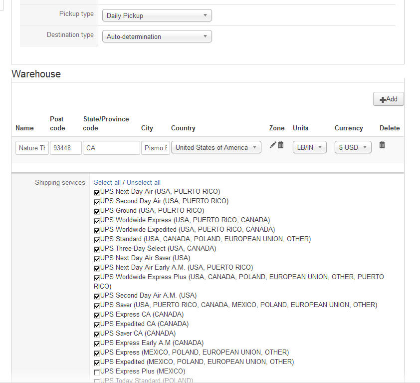

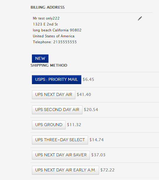

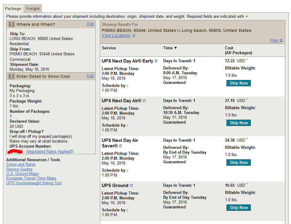

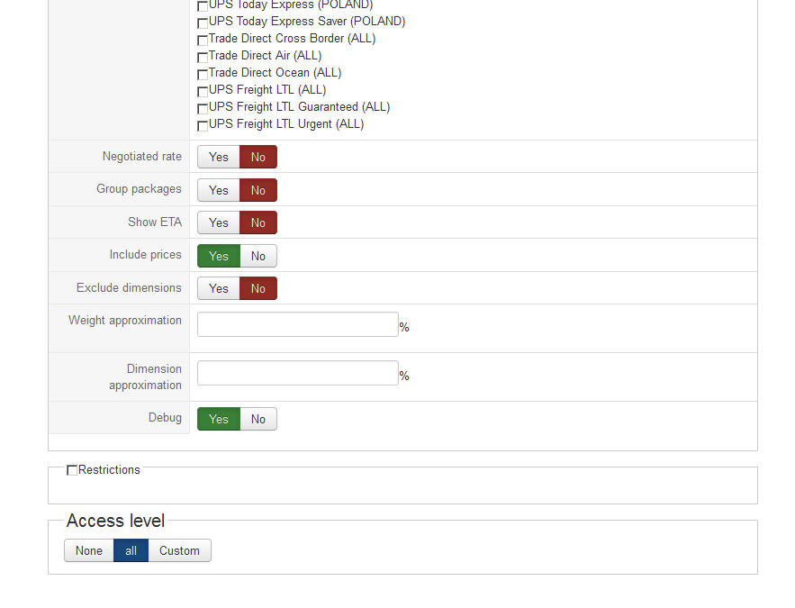

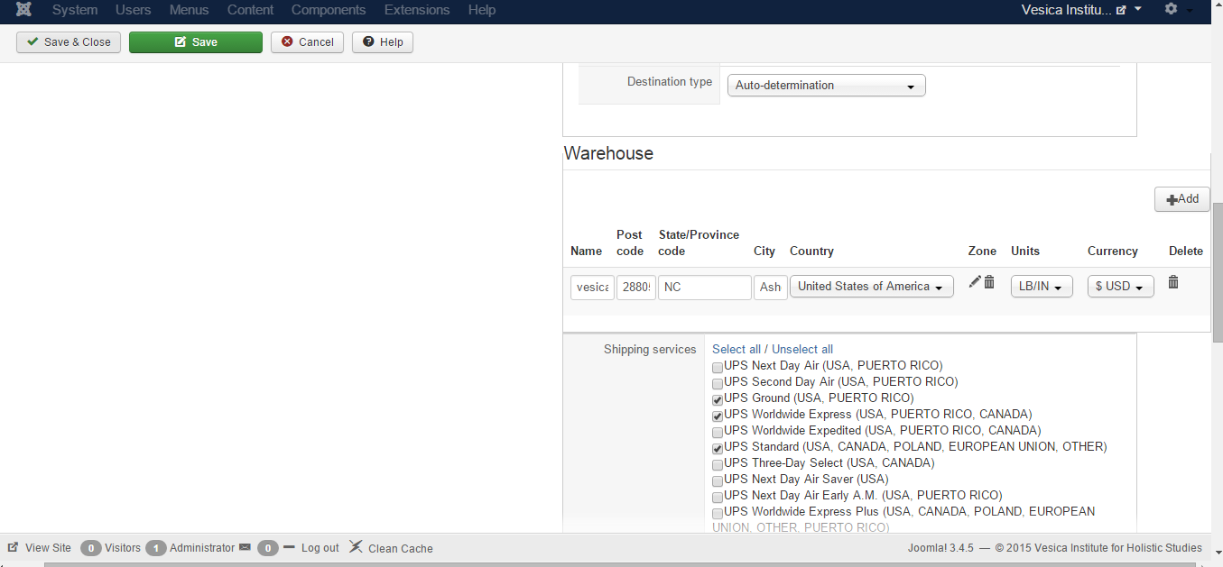

We have the SAME problem. The rates we're getting are not the rates from our UPS account. I've verified that the Everything is in production mode with UPS, too.
We're running Hika 2.6.2, Joomla 3.5.1 Below there are 3 sets of screen caps:
1) our backend (We have tried it WITH negotiated rates On and OFF - same prices!)
2) an order showing shipping charges
3) From UPS showing what our rate SHOULD be
10 years 3 months ago #240337
In your case the the price returned through your website is higher than the price displayed through the UPS website, so if using the "Negotiated Rates" option doesn't make any difference then you should directly contact the UPS platform to correctly enable it for your account.

  • Posts: 14
10 years 3 months ago #240370
We already know IT IS correctly setup on that end. We were using the exact same account with a Virtuemart store and it worked perfectly. UPS isn't the problem, the plug in is.

10 years 3 months ago #240704
I just checked what the plugin was sending to the UPS platform and no matter what I do It's correctly sending the "negotiatedIndicator" which means that the issue is probably coming from your account which doesn't have access to negotiated rates, so the best solution will be to directly contact UPS about it.
Here is what we send to the UPS platform in your case :

As you see we are correctly sending it so feel free to also show them what we send to their platform so that if they find something or have some tips, we'll gladly adapt our code.
Thank you !
