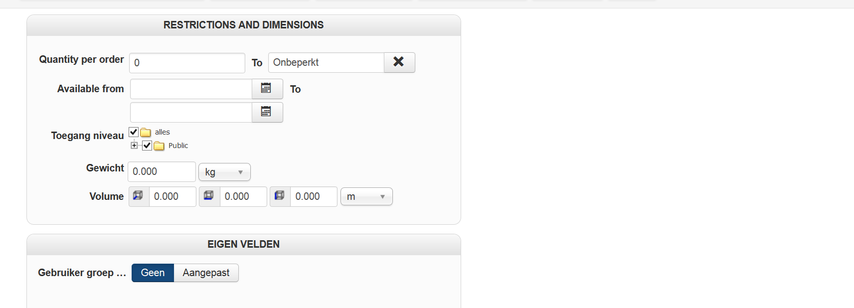

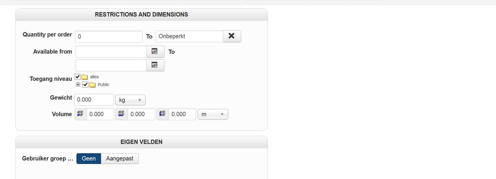

Hi after our update to the latest hikashop we noticed that all our prices at the productpage are €0,0. We always showed the price with product on our productpages. So we did some tests and this is what we know now:
1. When you look at the productlist the real prices are showing. ( this is productprice including tax)
2. The prices on the productpages are all €0,0
3. The price restrictions or ACL's are all klicked on. So everybody should be able to see the prices. (but its not)
4. Just to make sure we also onclicked all prices and tried to see what happend. Nothing happend all prices stay €0,0
5. When we fill in a retailprice this will show up at the productpage. This retailprice wich shows the description: normal price. and the price with tax with the description: our price.
So somehow we think the price with tax is not showing on the productpage even when it should. All our prices are filled in at the price including tax box. The retailprice boxes we never used so they are all at 0,0 and we can not go into 3000 productpages and put a new price into the retailbox.

and attacht a screenshot of our settings in productpage backend and of our global settings

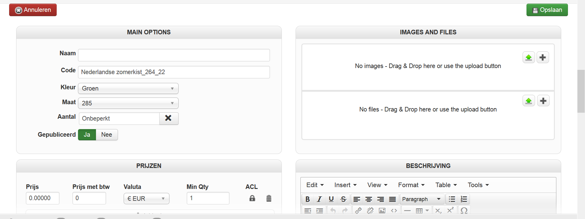

When you edit a product like this one www.astansa.nl/extreme-survivalwebshop/p.../category_pathway-46 , you have a tab called "Variants". There, you'll see a list of the variants of the product. If you edit one, you'll see the settings of the variants. It's a screenshot of these settings that I want.
  • Posts: 138
10 years 8 months ago #224813

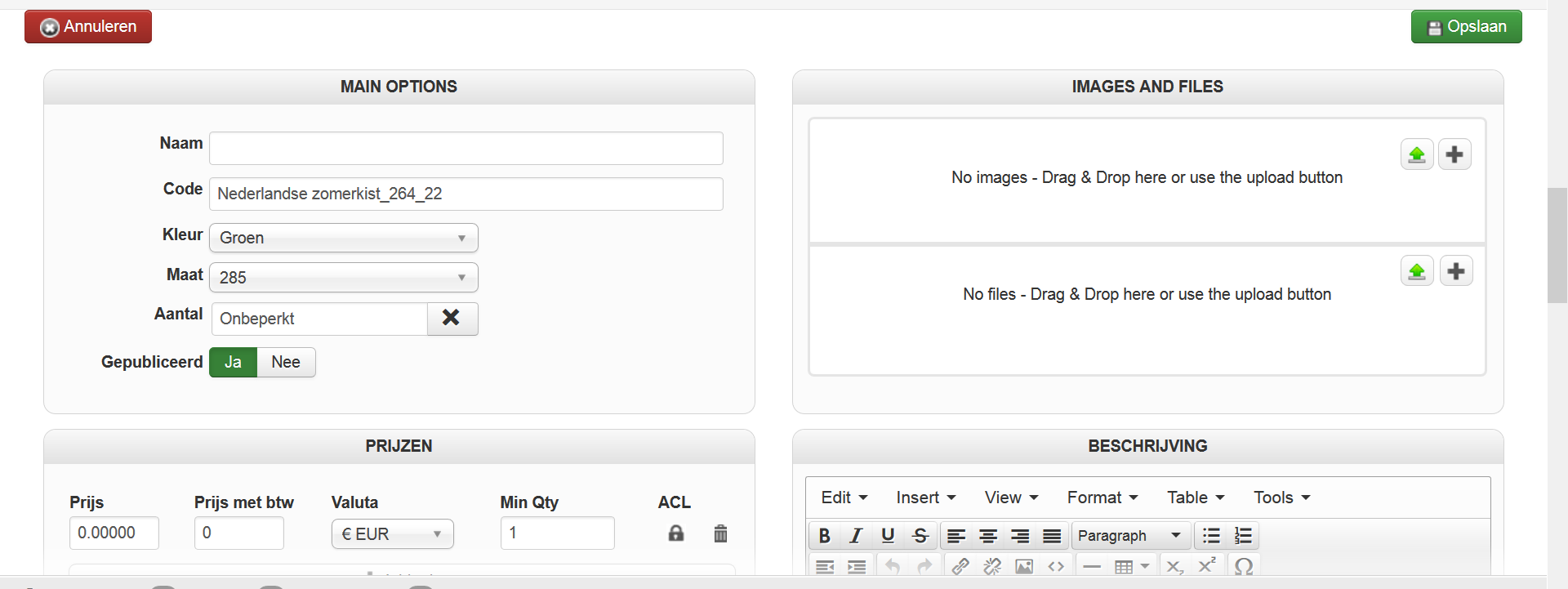

ok thank you for the clear explenation.:) Hereby the screenshots you asked for.
when i click on the pencil before a variant i get a popup screen and then an error.
Last edit: 10 years 8 months ago by extreme.
  • Posts: 86084
  • Thank you received: 14194
10 years 8 months ago #224875
So, for this variant, if you click on the bin icon for the price row that you see on your first screenshot and save the variant, does that solves the problem for that product ?

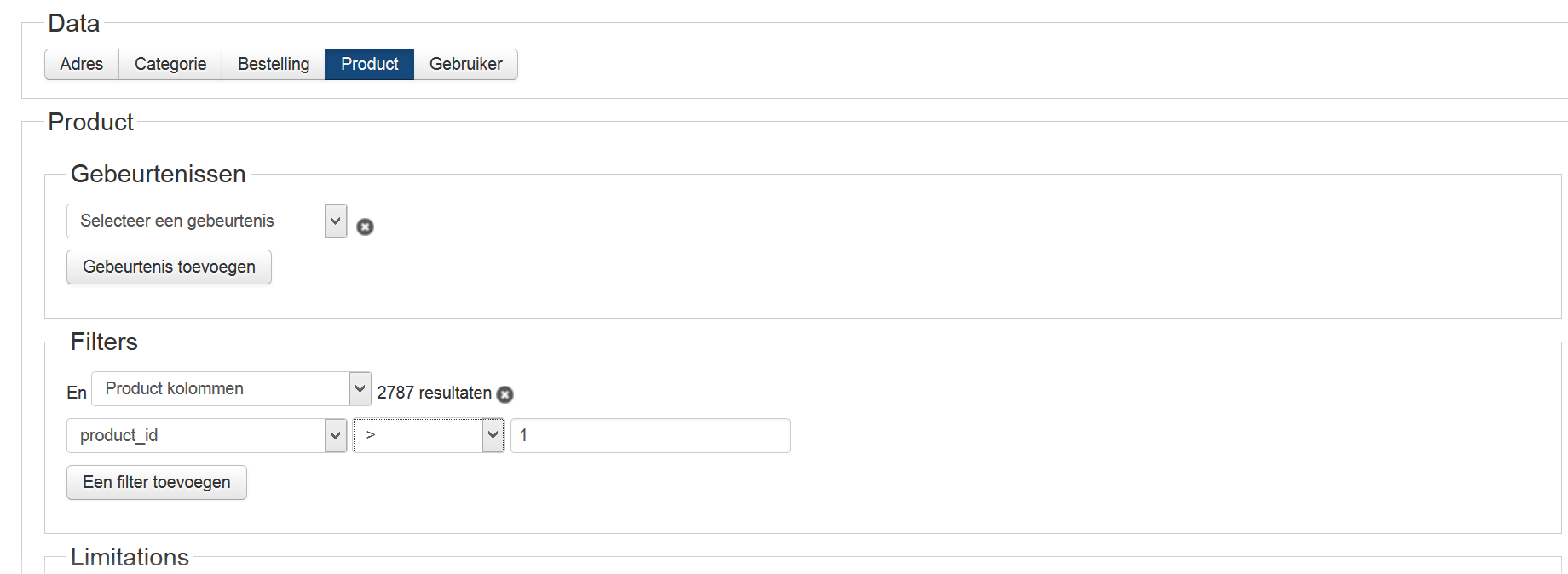

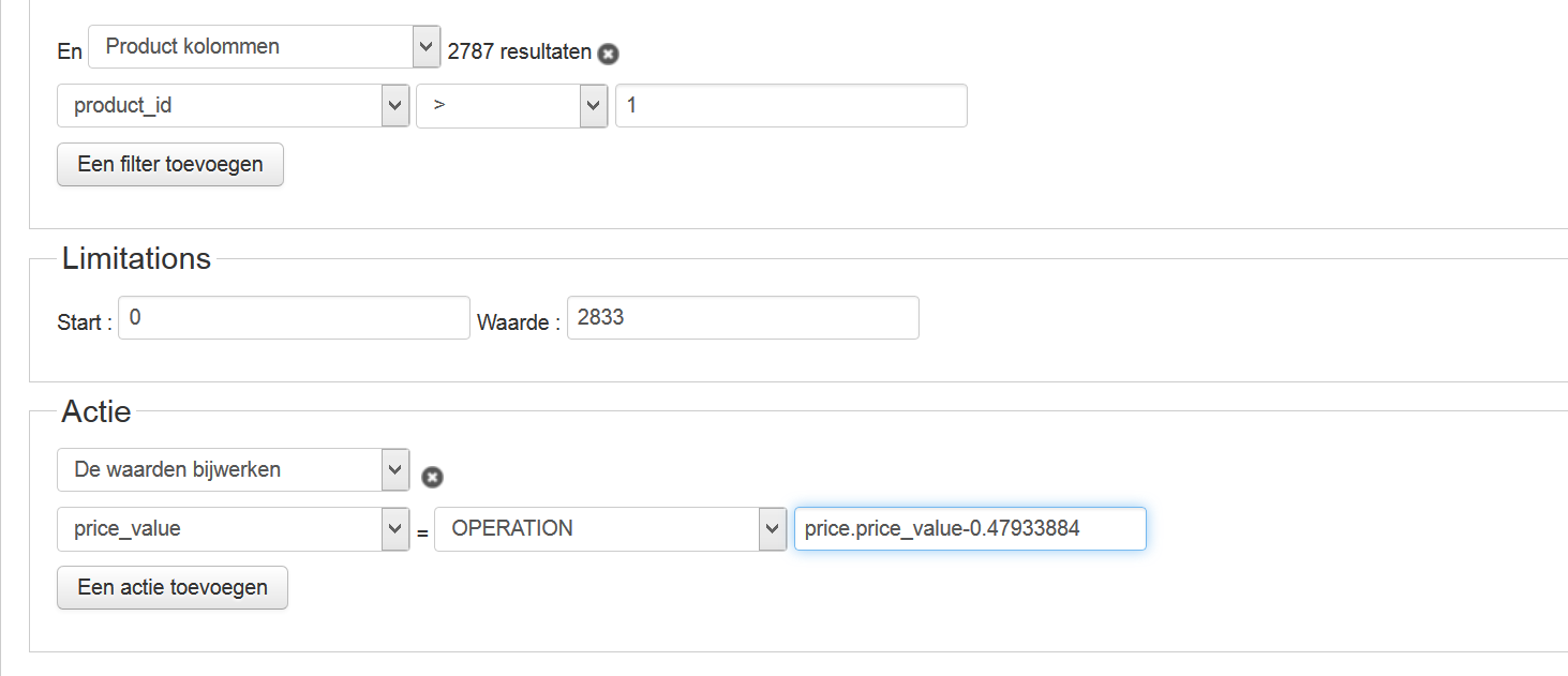

  • Posts: 138
10 years 7 months ago #226868

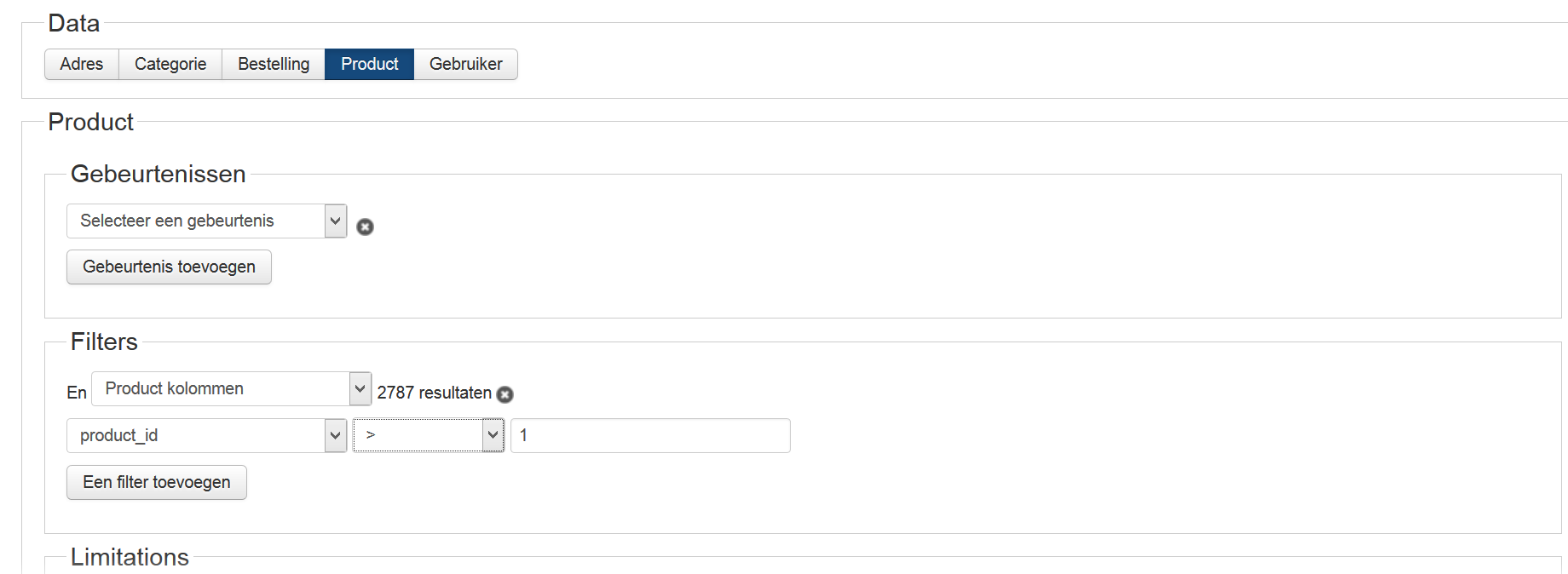

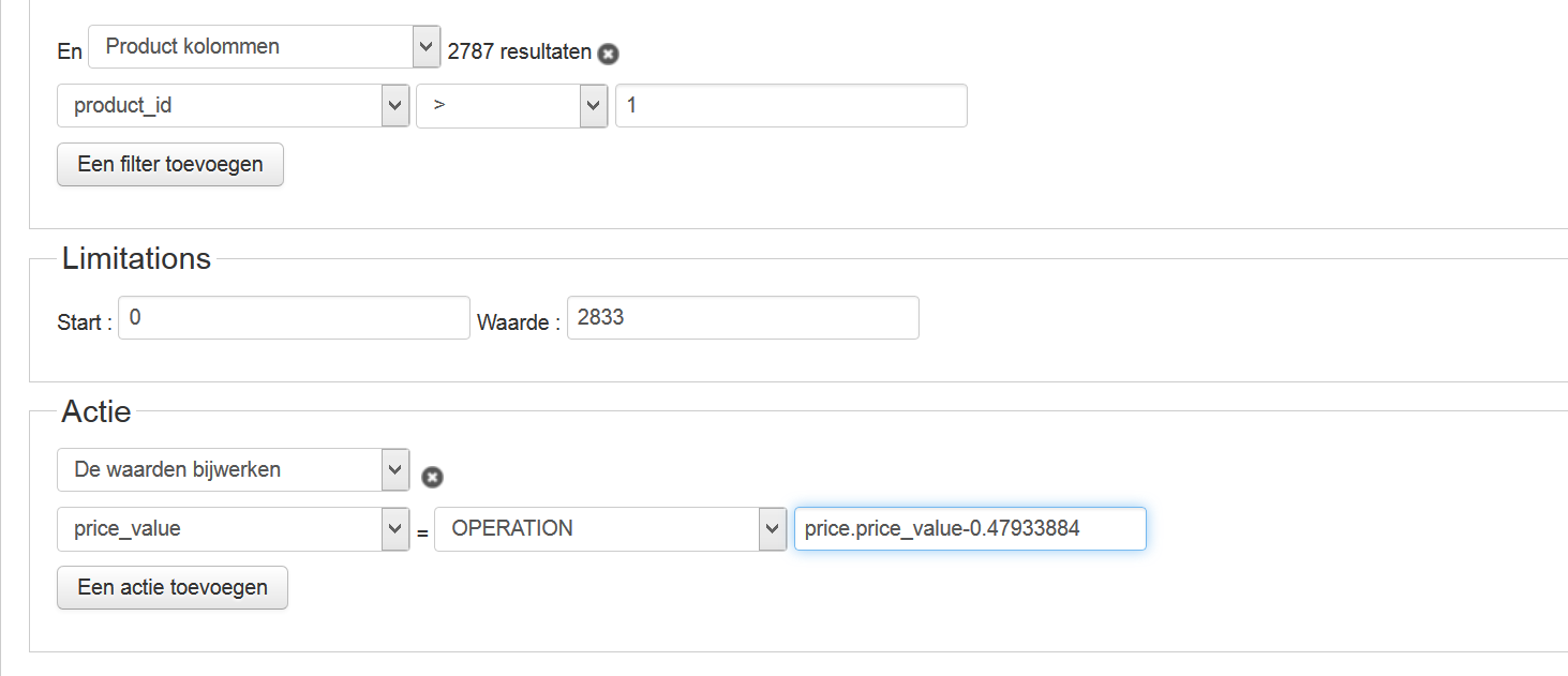

So we had to change al our prices back as it made our sales go down badly. So we did do a massaction and lowerd all prices.
We first tried it with one product. Product price got lowered perfectly and also on the productpage the price was fine. Then we did it for al products and bam on the productpages al prices where back to 0.
So we did the query again. But this time the query told us there were 0 changes made. So no cganges and all prices back to 0 on the productpage. For now we put the backup back but we need to lower al prices. Any idea why it makes the prices go to 0 when we do all of them and not when we do 1?

  • Posts: 138
10 years 7 months ago #226940
Hi Jerome,
We use joomla 3.4.8. Hikashop 2.6.0
The massaction is shown in attacht screenshot of the settings:
10 years 7 months ago #226945
Please update to version 2.6.1, we done some fixes on the mass actions.
I just tried your configuration on my local and it is working correctly.
What can be tried it to reduce the quantity of products handled via the limitation fields.
