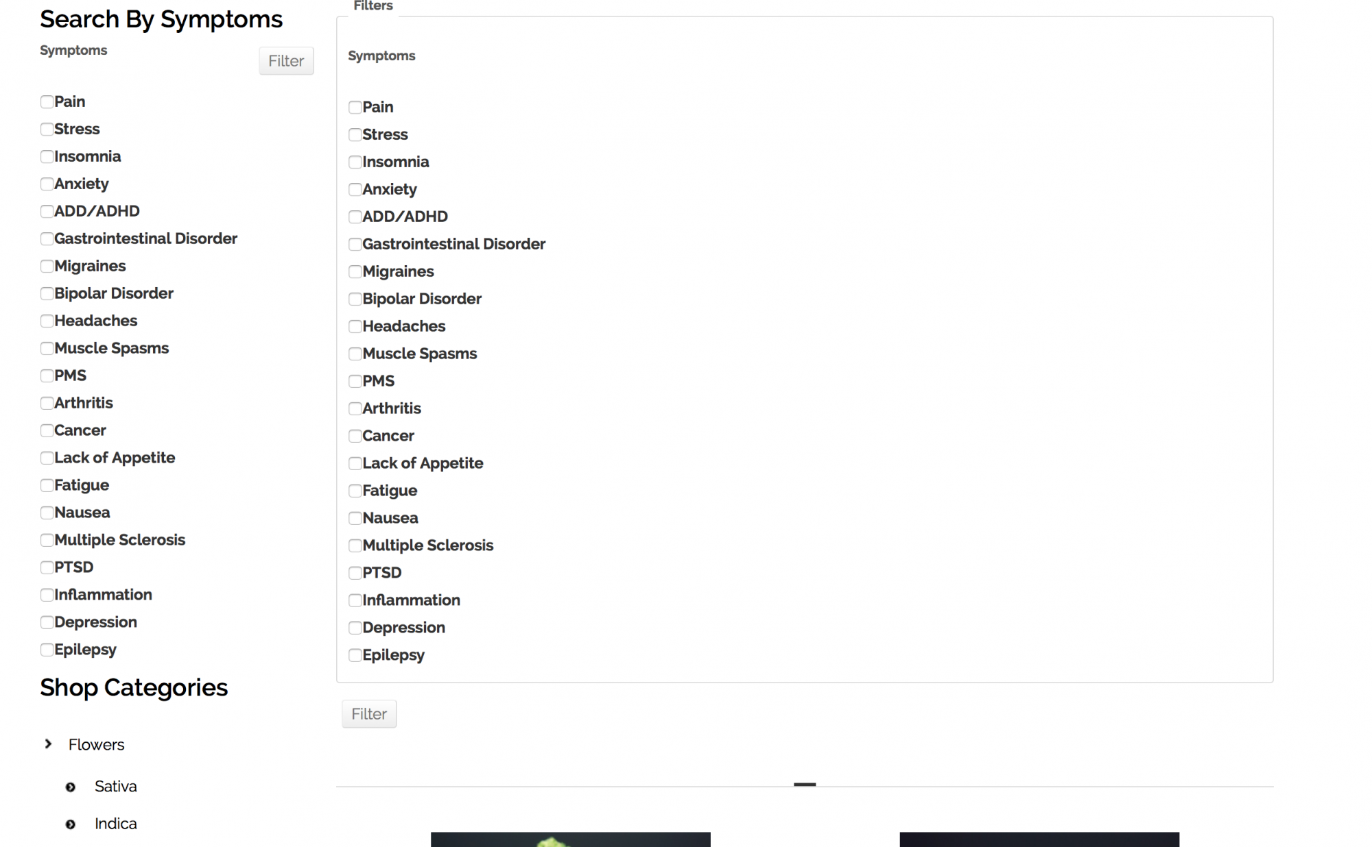

Been playing around with the custom product filters, but I have one small problem that I'm not sure how to change. I would like to have the filter search to be displayed in a module on the left sidebar. I have created a module and done this and that seems to be working. However the same filter search is being displayed on top of all the product listings/category pages. I wish to remove the one displaying over the product listings and just have the one on the sidebar displayed.
Hoping you can help sort this out for me. I've attached a screenshot to show you what I'm talking about.
Thanks for your time and help!

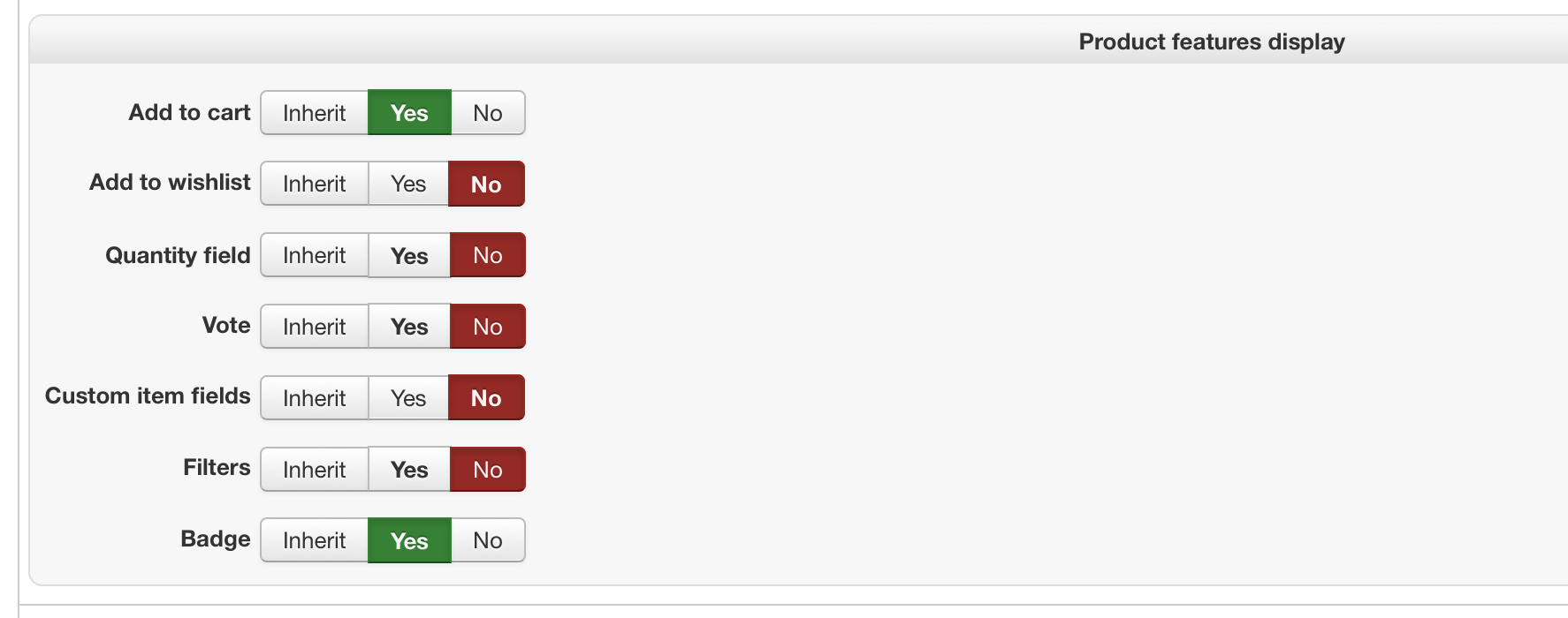

Thanks for your response! Went through and changed all of the option on the menu items to "No" but that did not have any affect. All of the pages are still displaying as they were. Added another screenshot so you can see how I have the options set.

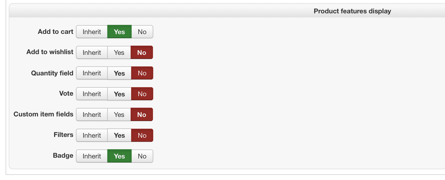

That's what I'm saying. I have the product display settings for menu item 413 and all of the other category listing menu items set not to display the filters or custom fields. (See attached screenshot from menu item 413)
They are all have the correct settings, yet I am still getting the filters displayed on those pages....
