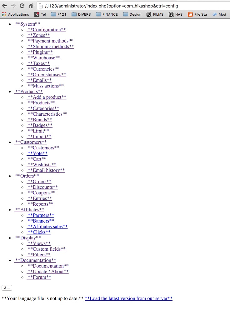

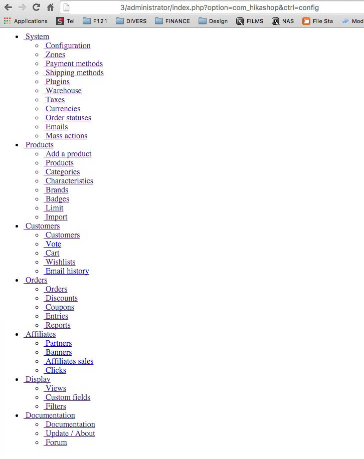

It solved my first issue, but after the upload, the Hikashop Configuration page displays only links (like a site map) and further the "Configuration" link doesn't work, so I haven't access to all the configuration section of Hikashop :-(

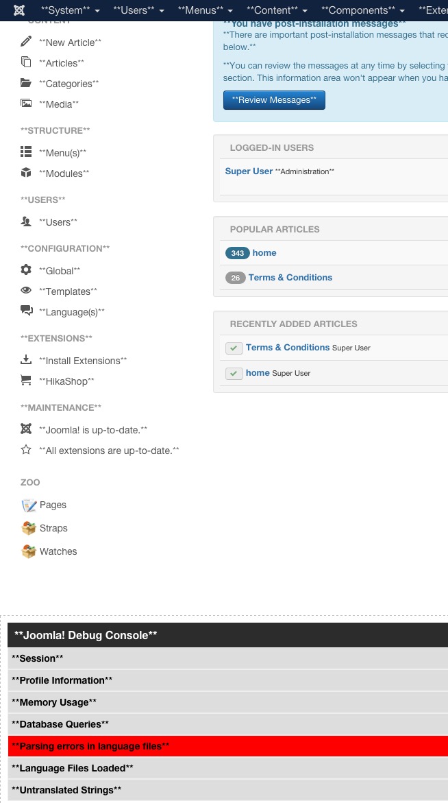

- Test it again so that you can see if it display an error message which will help you to understand from what your issue is coming.

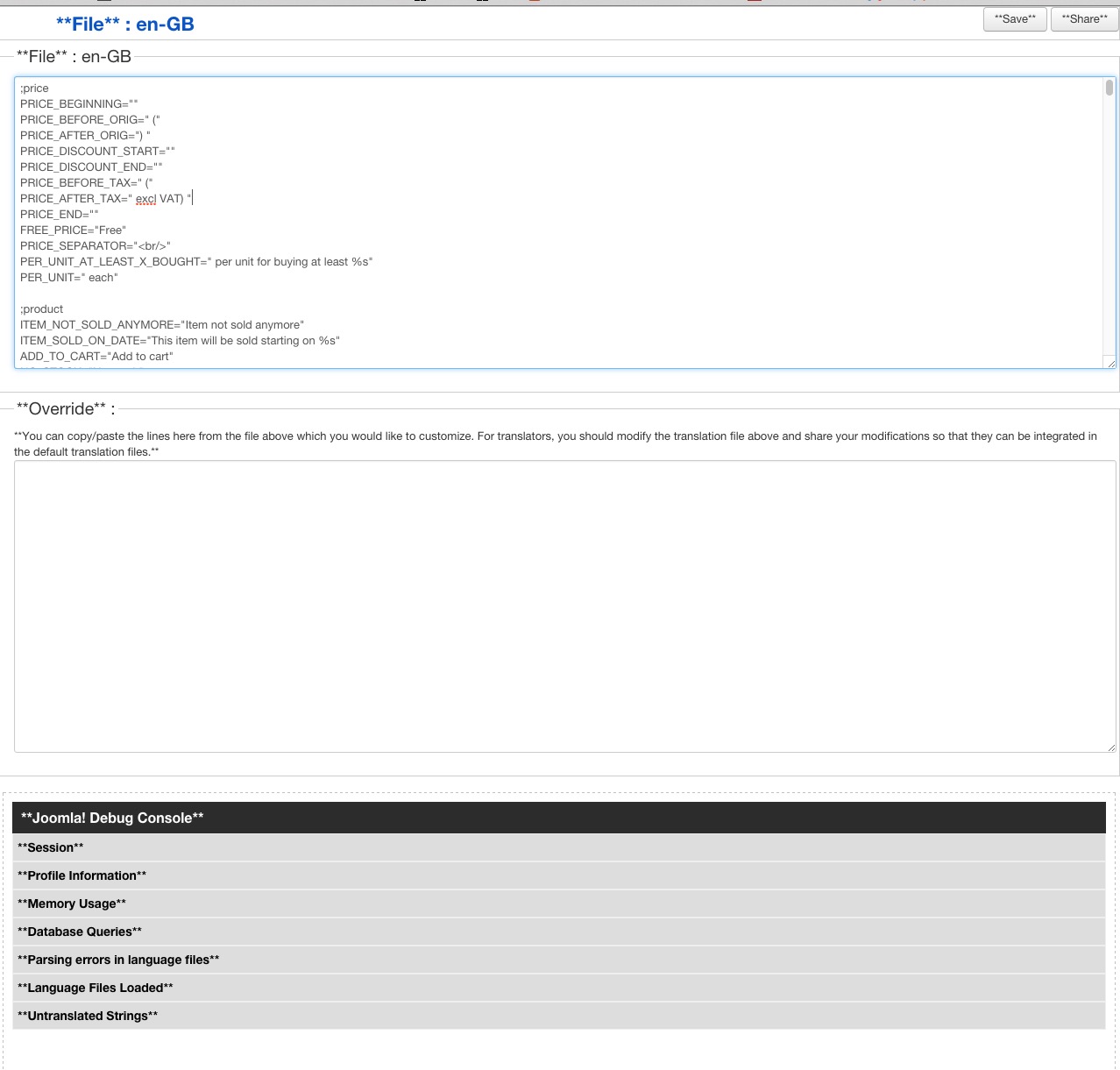

You activated the language debug mode ; unfortunately, that's not what we need
Set the "error reporting" option of the Joomla configuration to "maximum"
