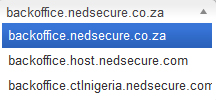

Hi Philip,
We tested the system with the new Hikashop and followed the instructions by the iVeri support service, but the gateway is not working.
As in underneath email I only have the option as in the attached picture
But in the attached pdf the iVeri service sent me the gateway for the website must be portal.nedsecure.co.za/

10 years 4 months ago #238492
That's quite strange because we update the Iveri payment plugins from what Iveri support told me...
Please note the part that is changing is the domain name, that means you only need to change the redirect url as stated below and there is no documentation that is required to make the change.
Iveri Support :
OLD URL
backoffice.iveri.co.za/Lite/Transactions/New/EasyAuthorise.aspx
NEW URL
backoffice.nedsecure.co.za/Lite/Transact...w/EasyAuthorise.aspx
And then, you told me that the Gateway must be portal.nedsecure...
Can you sends us the Iveri pdf via our "Contact us" form with a Url link to this topic.
Other solution, more quick for you, is to replace "backoffice" by "portal" in your file :
YourWebsite/plugins/hikashoppayment/iveri/iveri.php
Around line 20 :
'backoffice.nedsecure.co.za' => 'backoffice.nedsecure.co.za',
'backoffice.host.nedsecure.com' => 'backoffice.host.nedsecure.com',
'backoffice.ctlnigeria.nedsecure.com' => 'backoffice.ctlnigeria.nedsecure.com'
for :
'portal.nedsecure.co.za' => 'portal.nedsecure.co.za',
'portal.host.nedsecure.com' => 'portal.host.nedsecure.com',
'portal.ctlnigeria.nedsecure.com' => 'portal.ctlnigeria.nedsecure.com'
And process test in sandbox mode to see if it works.
Awaiting news from you.
Regards.

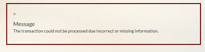

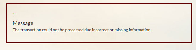

It seems the Iveri Plugin is not working anymore with the latest release of Hikashop. Could you please have a look into that!
Whenever I want to pay vie Iveri Gateway it throws the following error:
The transaction could not be processed due incorrect or missing information.
Thank you very much!

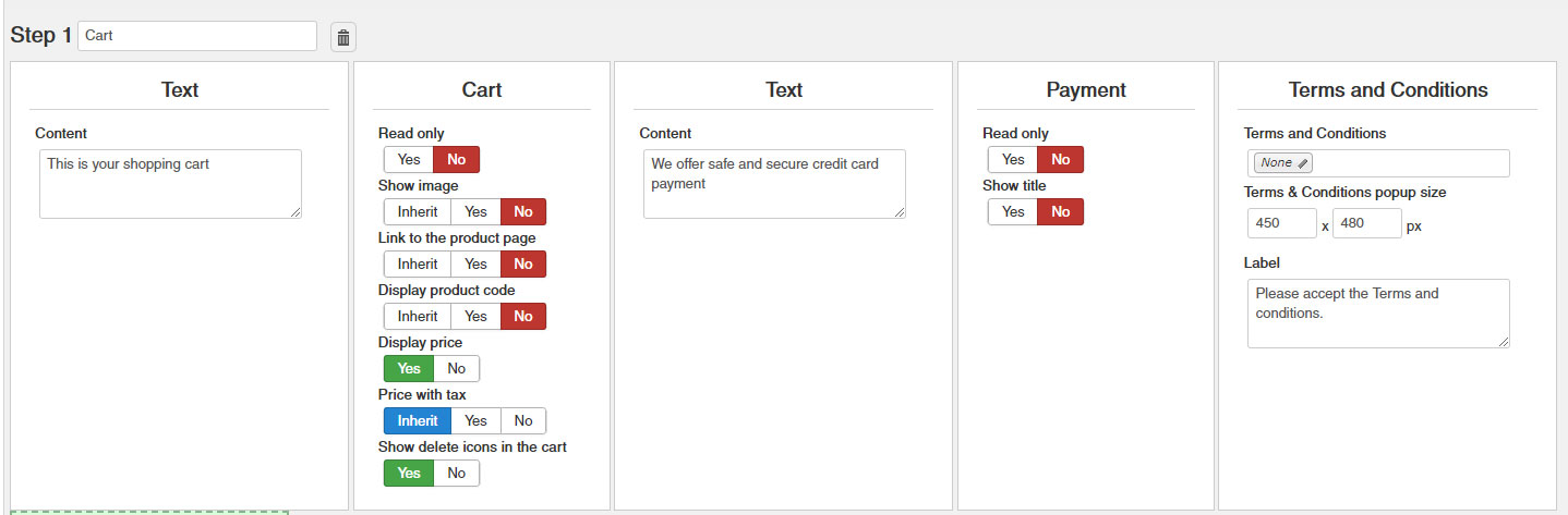

7 years 8 months ago #301617
Hi Phillip.
Here you can find the front end link:
www.tsumeb-gimnasium.com/win-a-hunt-in-n...hant-hunt-in-namibia

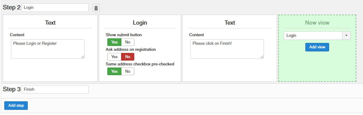

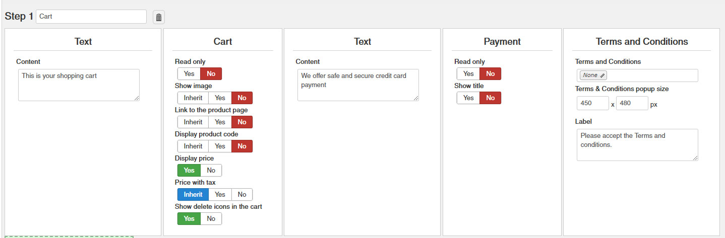

Attached three screenshots.
Step 1 and Step2 & 3 of the configuration
Error message
7 years 8 months ago #301621
I was able to reproduce your issue, and I noticed something, in your checkout workflow :
=> You have your Payment block before your Login block... In my mind, finished or validated an order without have a customer.
Plus, it seems more logical to login before pay, like this the customer will be more confident we think.
Does this can solve your issue, not sure and so can you add your payment plugin configuration screenshot.
Last edit: 7 years 8 months ago by Philip.

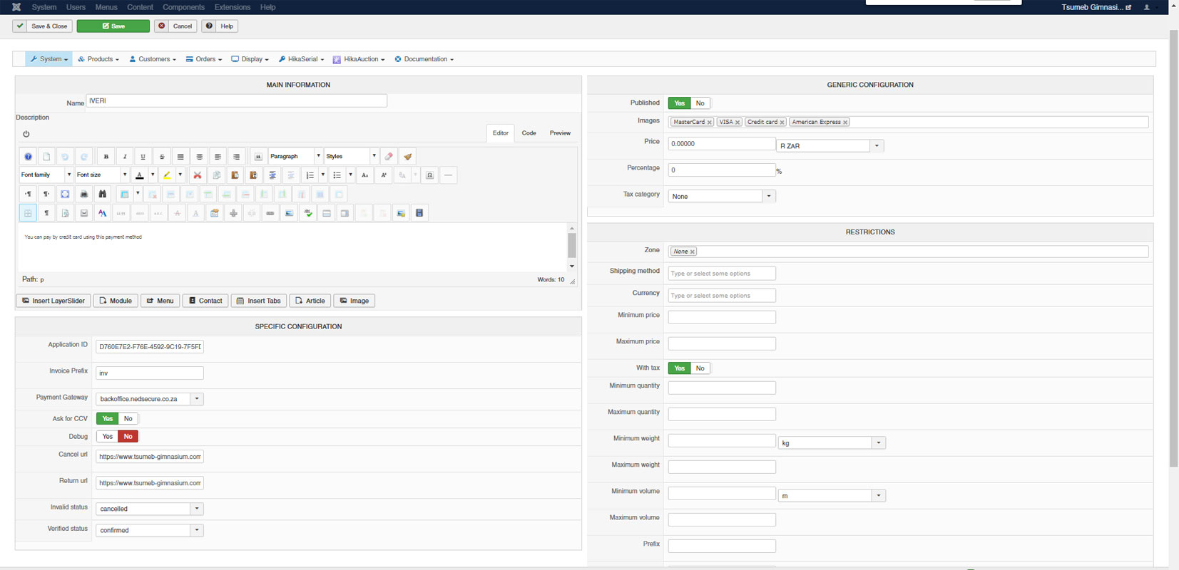

  • Posts: 23
  • Hikashop Essential

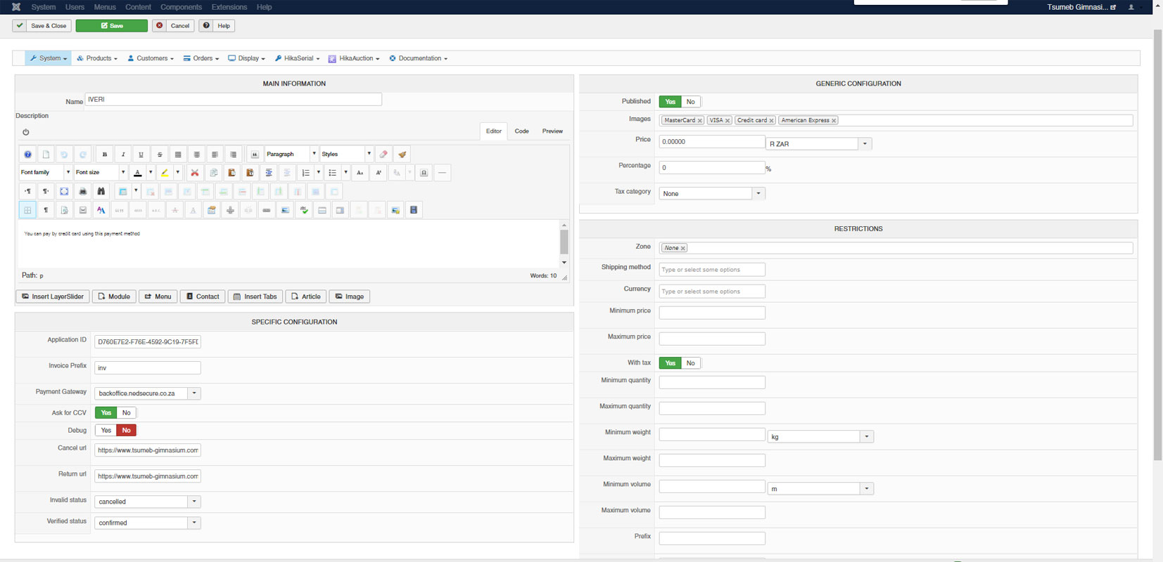

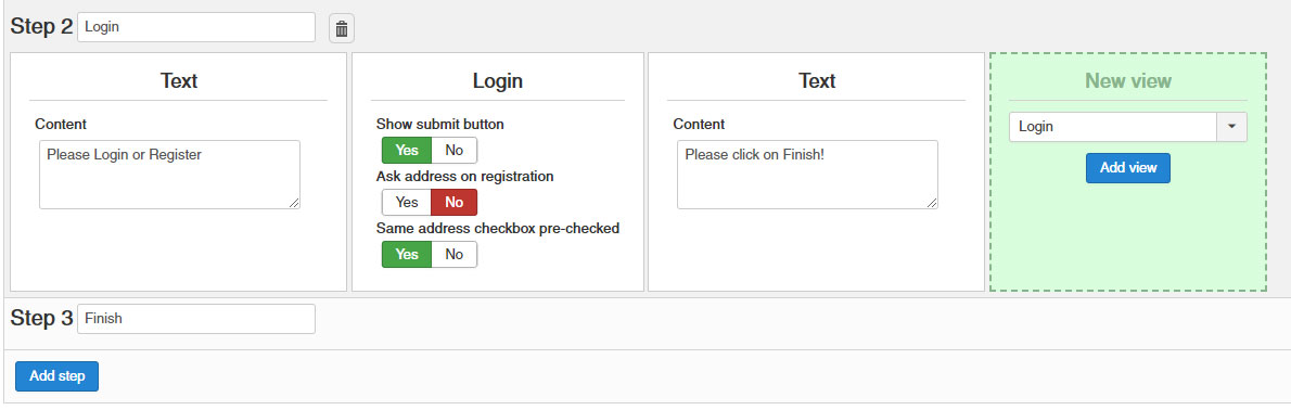

7 years 8 months ago #301667
Hi Phillip,
It worked before the other way round (first credit card and then login). In any case - I tried it now the with first login and then payment (please also check for me) and it is showing the same error.
Here's a screenshot of the plugin settings
Sebastian
7 years 8 months ago #301676
Did you contact your Nedbank payment support, so far and when I analyze your settings and your error message it seems that the error is a response from payment server, invalid merchant references ? Wrong redirection url (Payment Gateway), impossible to know more so far.
Contact Nedbank payment support, we hope this will bring more clue to solve your issue.
