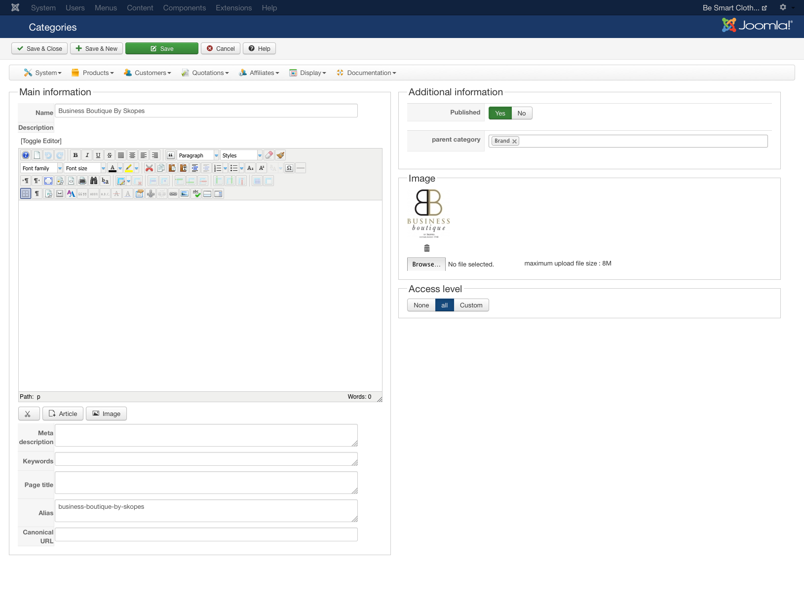

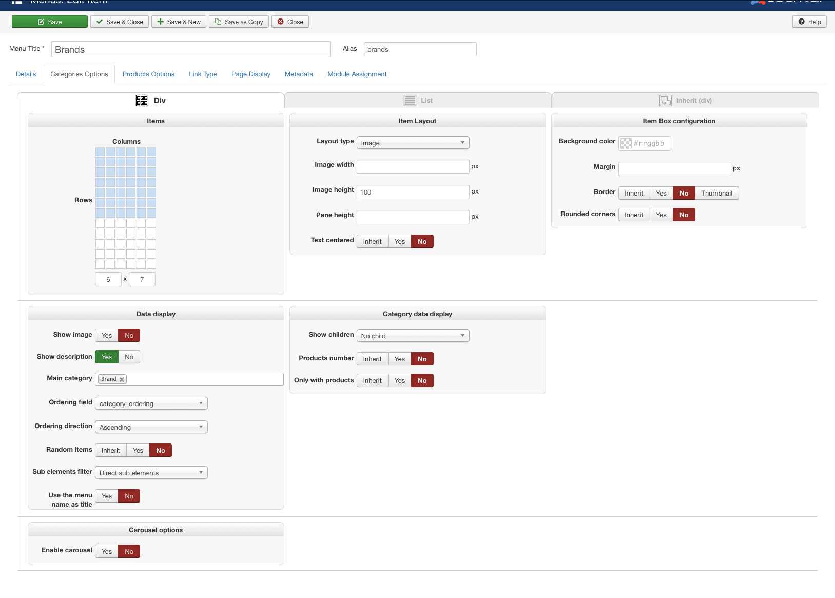

  • Posts: 100
10 years 6 months ago #229799
Sure, I've attached the settings for one of the brands, and also the brands menu item. I have also found something that could help diagnose the problem. We have added the brand logos underneath the product image on the category view page. When you click this, it goes to a non-SEF URL page of the brand. The menu items are set to go to an SEF URL. Not sure if this is a clue.

10 years 6 months ago #229841
Everything seems to be well configured... Can you provide us backend references thanks to our "Contact Us" form ?
