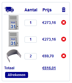

If I order a product, with the same variants and options, and use the add to shopping cart button two times or more the product will be added to the shopping cart as two or more separate items.
Even if I order the default variant twice or more it is added to the shopping cart as separate items. This is also true for the options, they are added to the shopping cart as separate items as well.
If I use the add to cart button, for a product with no options or variants, twice or more the shopping cart will increase the amount, of the same product, in the shopping cart and will only display a single product with the corresponding ordered amount 2, 3, etc.
Not sure if this behavior was already present in the 2.6 version, but I think that it was working like a normal, no variant product.
The attached picture shows identical items ordered twice.
No big issue but at least a bit strange.

The last item of €69,70 is a standard item with no options, I did use the add to cart button twice to add it to the shopping cart and it did change the total amount ordered from 1 to 2.
So it is not a part of the option(s) or variants of the other two items of €273,16
The first to items have variants and if I use the add to cart button twice for the same variant it will add two separate items to the shopping cart instead of showing just 1 item with a total amount of 2 ordered.

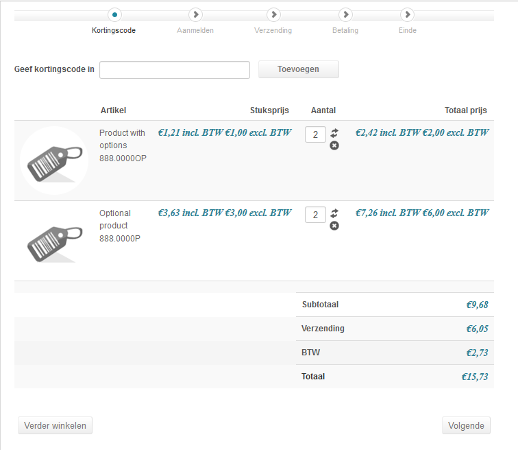

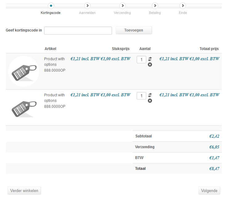

If you have a product with options and you only order the product without the options it will be treated a a single individual item. So each time you click the add to cart button it will add one extra line to the order.

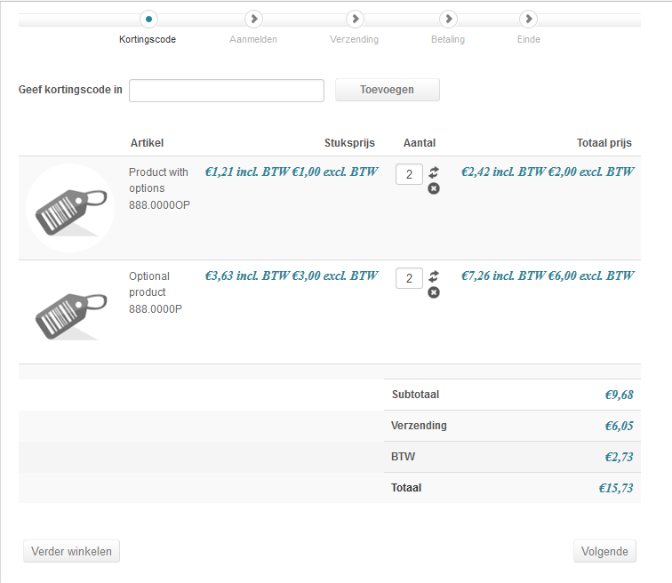

As soon as you order a product that has options and you order ALL the options that are available for that product then the total amount ordered will be increased but there will be no extra order lines.
So please note if you have 1, 2, 3 or more, options to a product you have to order them all to get the correct display in the shopping cart and the order.
If you have a product with options and variants you do need to order the exact same variant each time with all the options to get the correct display in the order.
The total order amount is correct in each case, so from the sales point it does not matter.
If you delete the main product from the shopping cart, or the order, then the optional product is also removed. So all is working as it should only the shopping cart display and the order will have extra item lines.

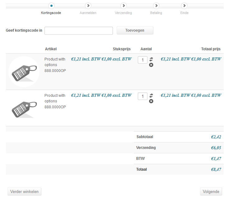

Attached two images, one for the product with options ordered WITHOUT the optional product (2 order lines for the same product 888.0000OP) and the other image when ordered WITH the optional product (2 order lines, one for the main product and one for the optional product but with the correct order amount for EACH product 888.0000OP + 888.0000P).
Regards, Rene

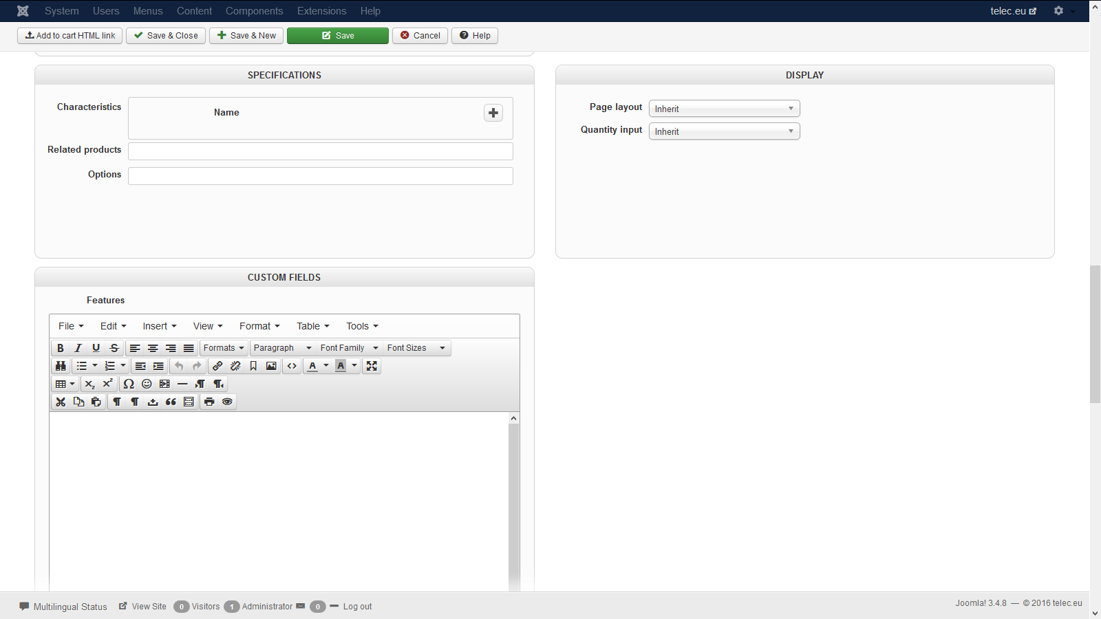

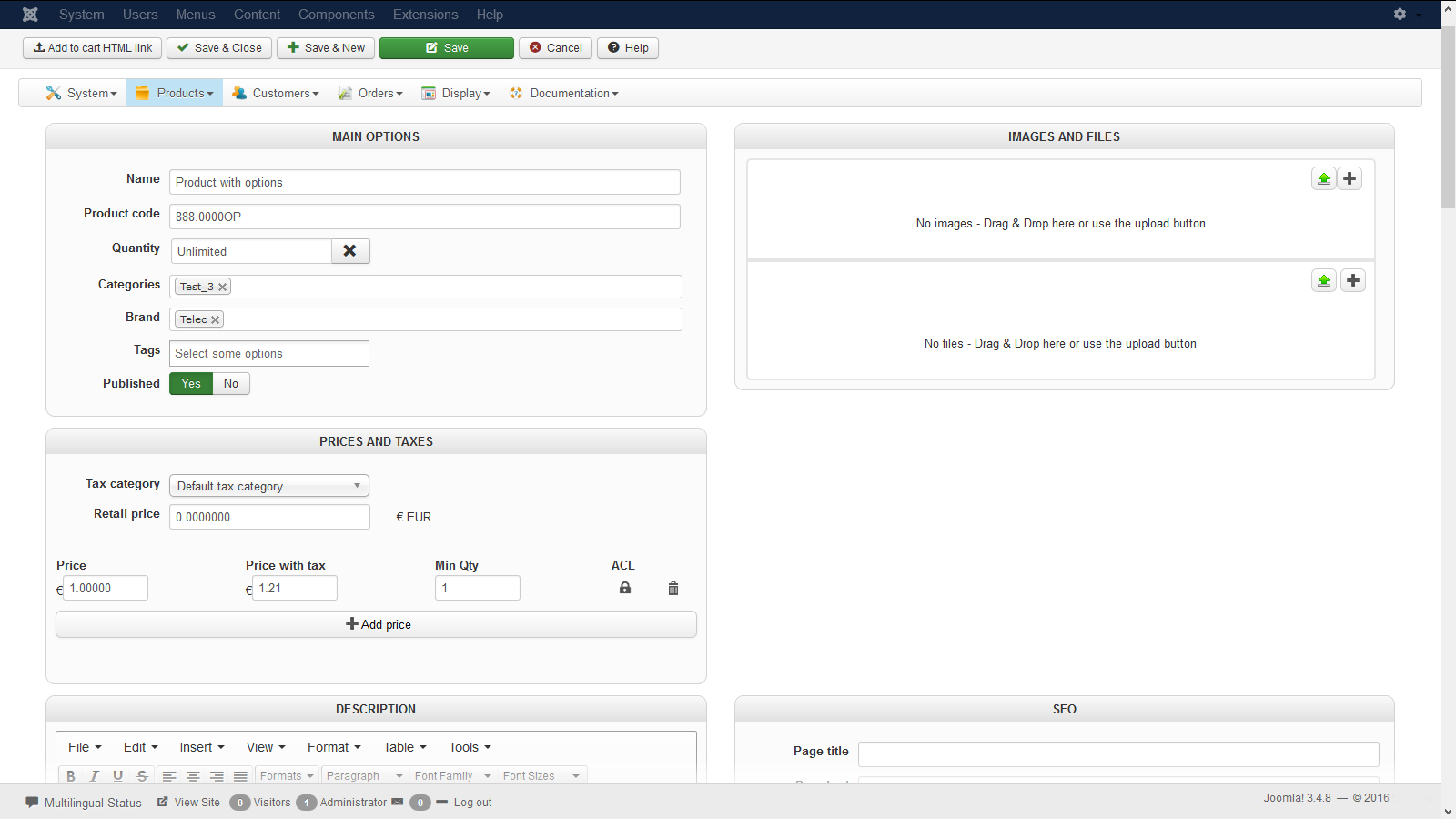

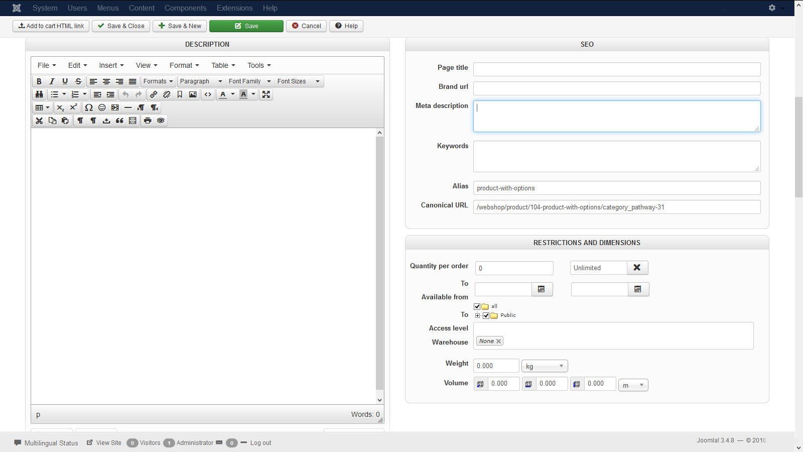

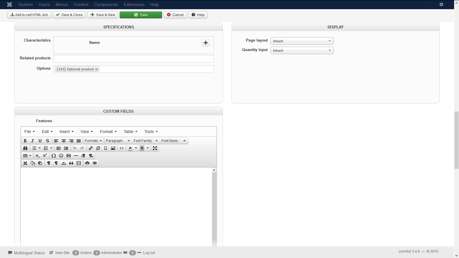

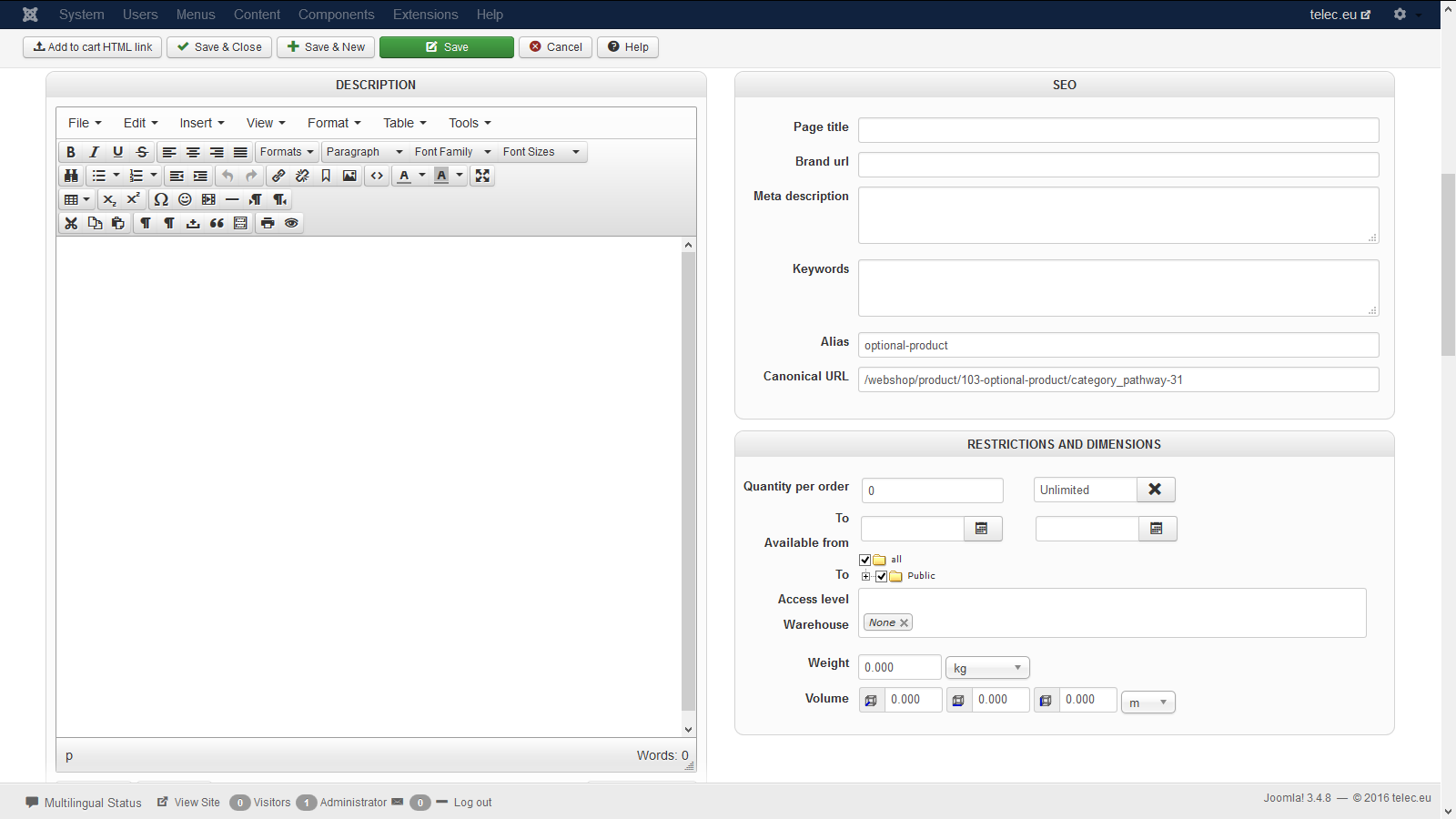

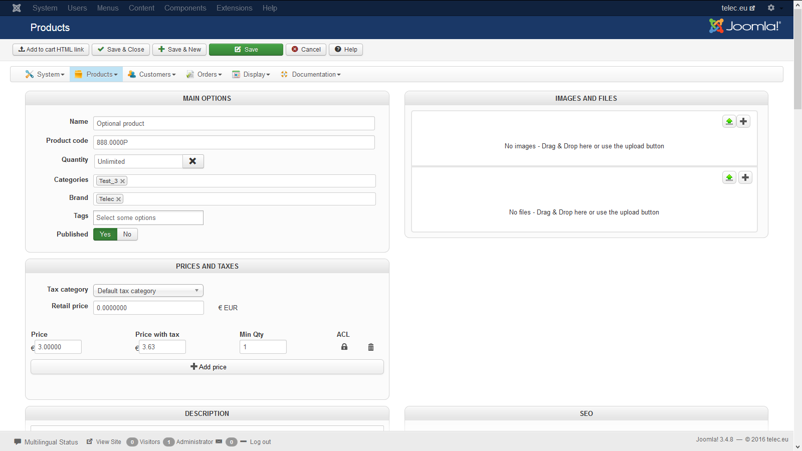

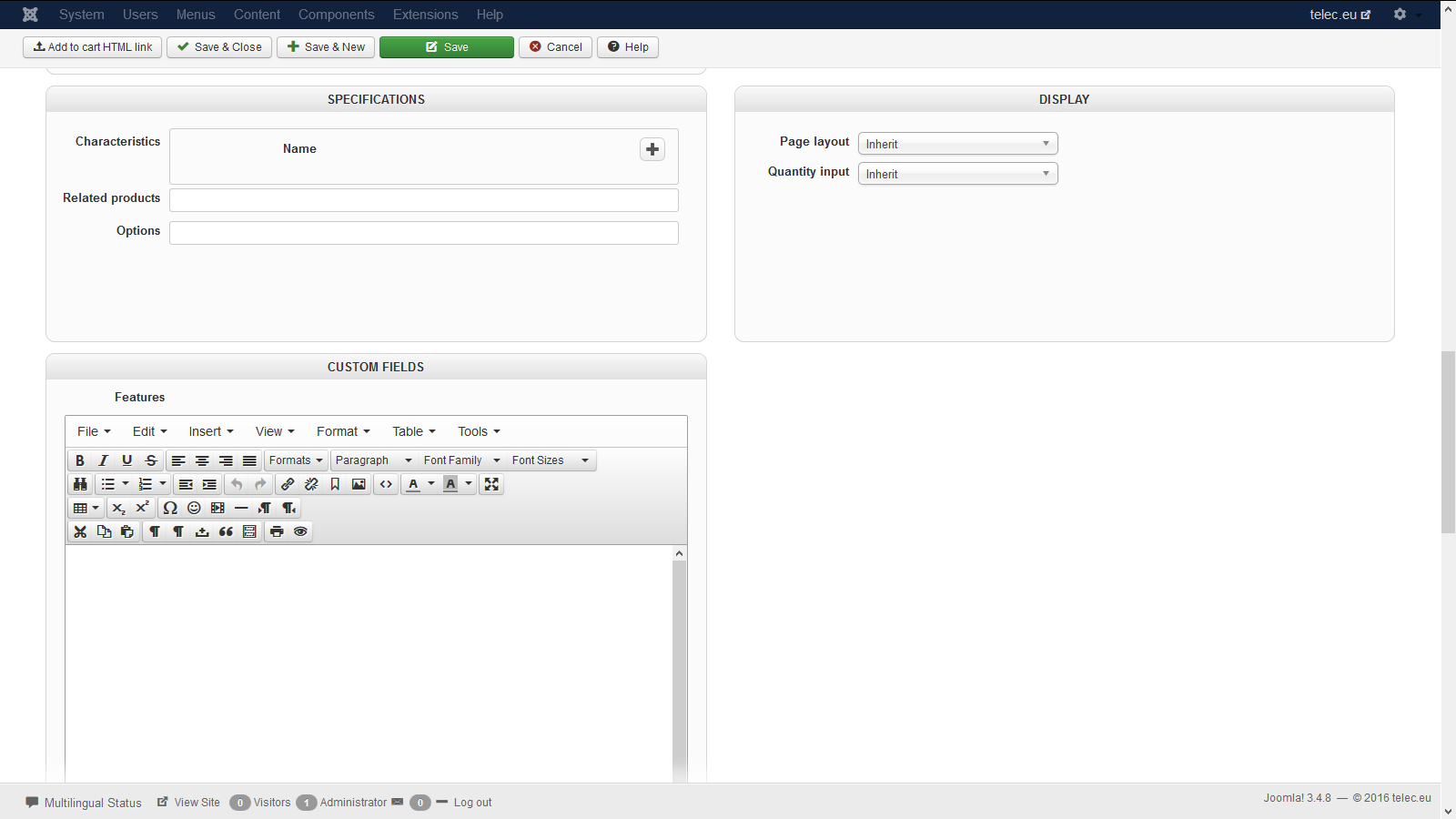

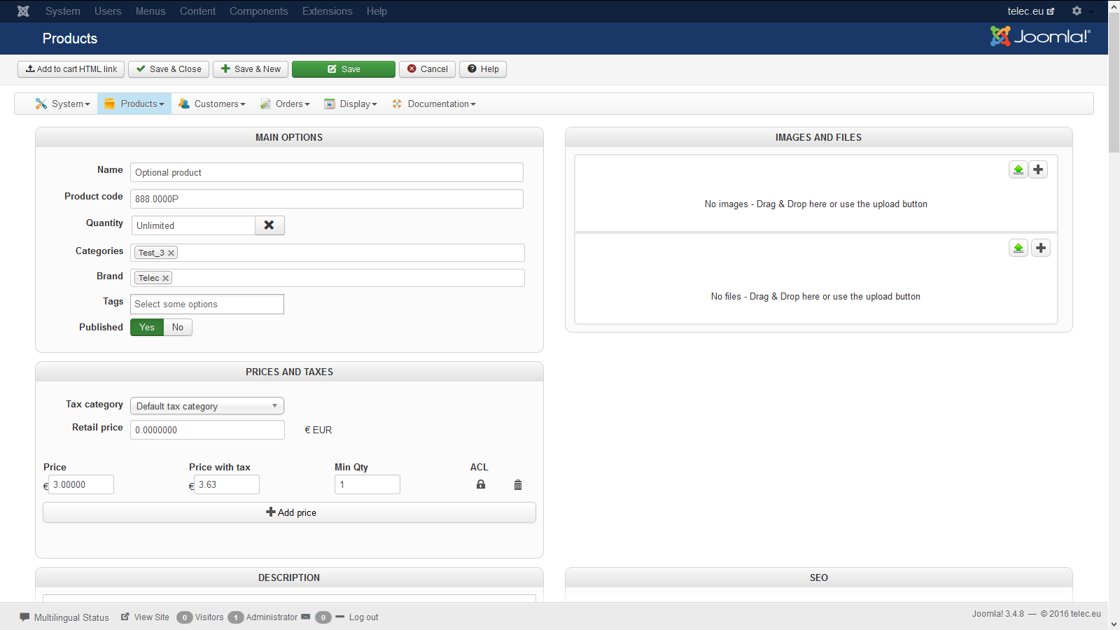

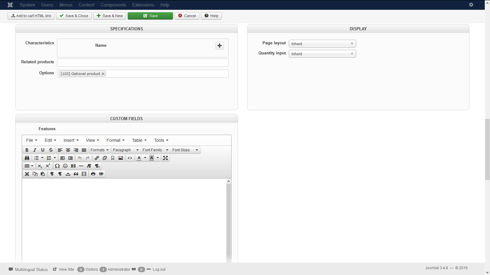

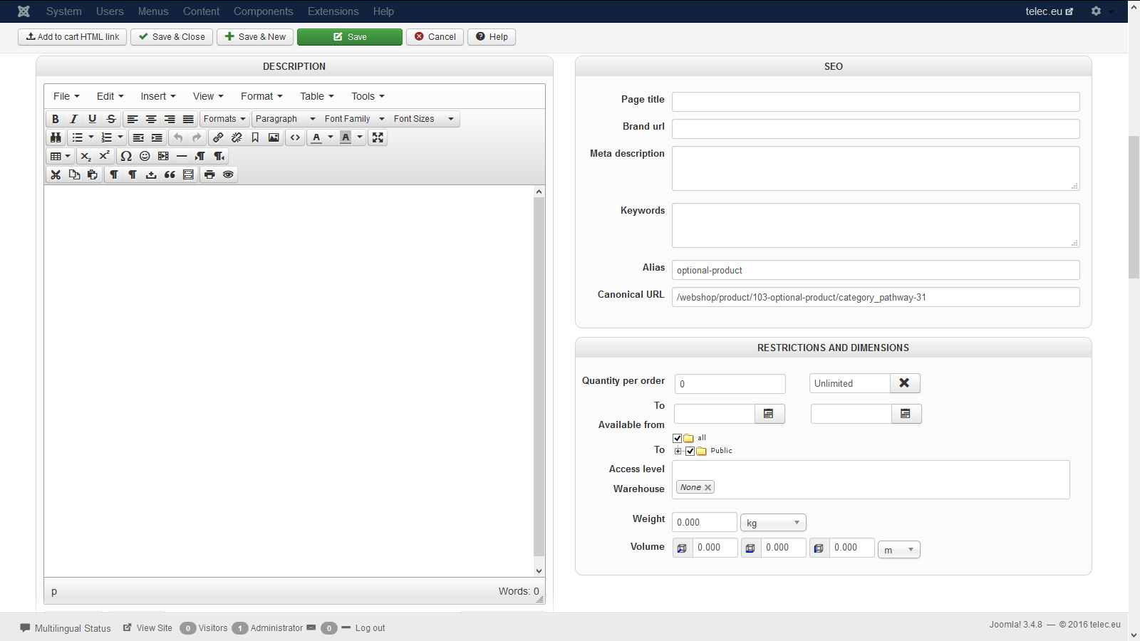

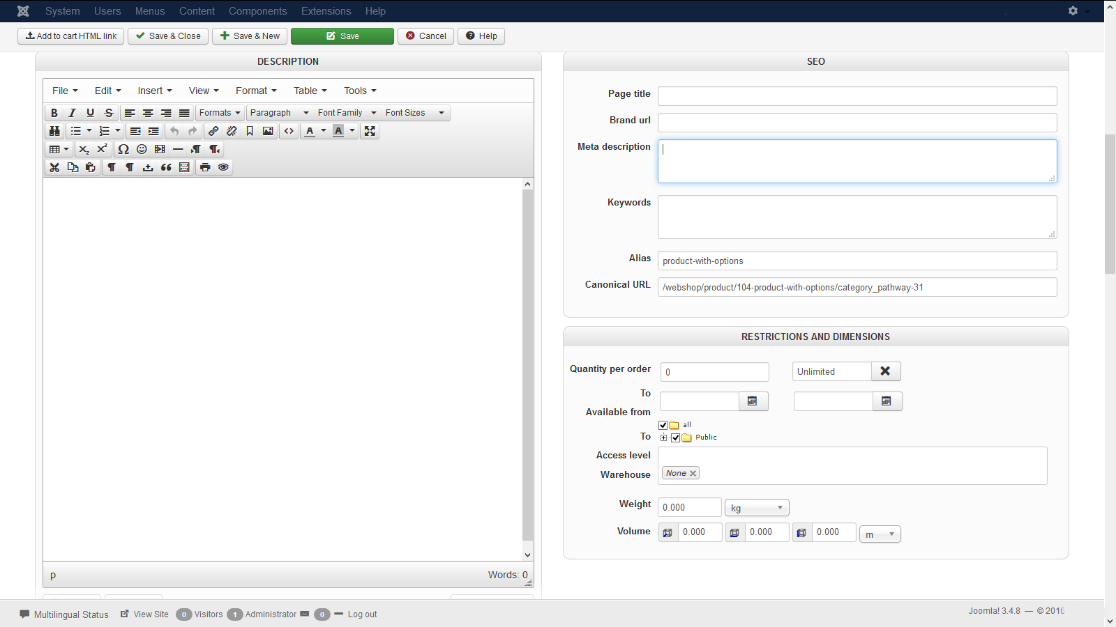

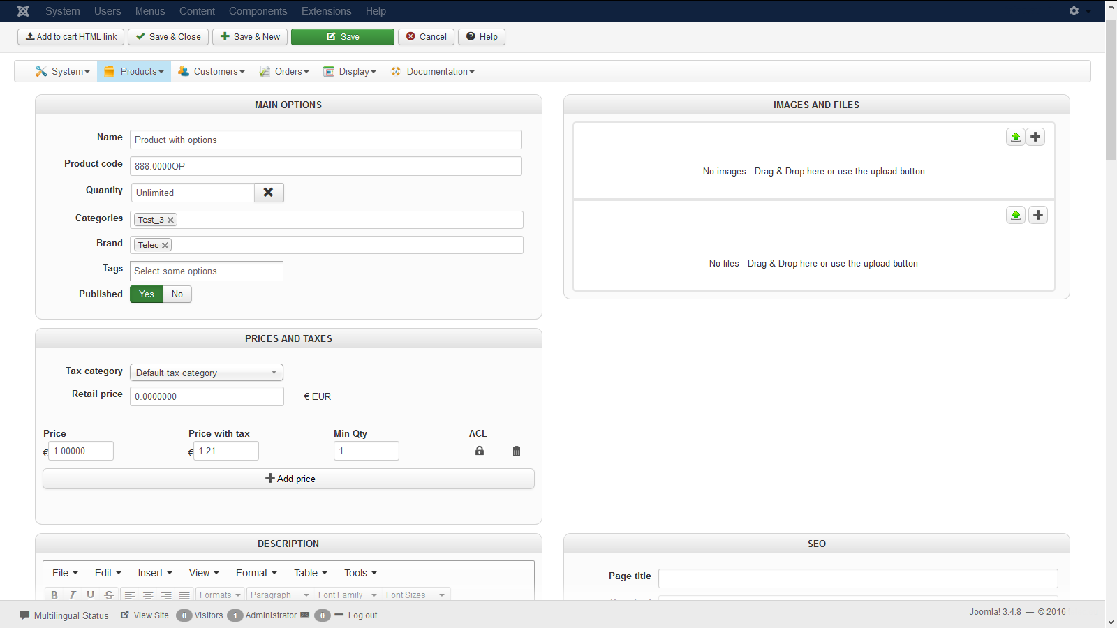

I did pm the link to the category with the 3 test items, if you find the time to look at it that would be appreciated.
Attached images are of the product with options and the optional product, basically I just entered a name, product code and price.
Regards, Rene
