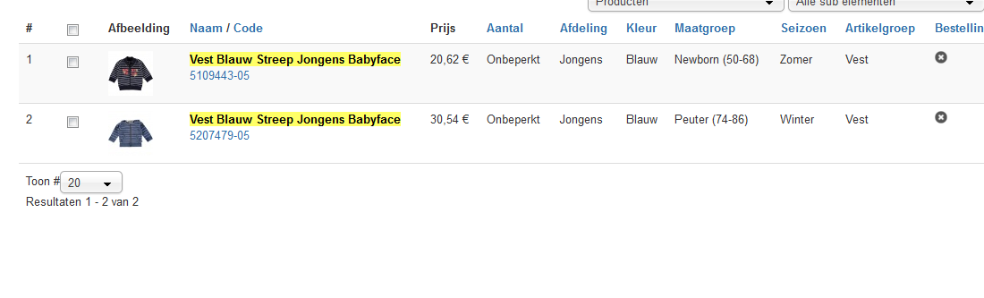

Since the latest update the order and invoice are showing the name of the product twice.
Instead of showing Name, size and Product code.
This is in the invoice.
in the back-end of the order the name is mentioned twice (see attached file) instead of name and size.
Can you tell me how to solve this?

10 years 6 months ago #230487
It seems that you didn't provide the correct screenshot as that's a screenshot of the products listing not an order or an invoice.
And we don't have the problem on our end. The name of the products in the invoices is only there once, followed by the product code.
So either it comes from a customization of your invoice, the fact that you have the product name as code in the product, or that there is a plugin of the group hikashop or system interfering with that.

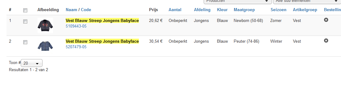

  • Posts: 252
10 years 6 months ago #230601
Is see I picked the wrong .png file.
Here is the correct one.
I didn't do any costumization in the past.

10 years 6 months ago #230843
We were not able to reproduce this issue on our end.
I see that you have fill the name of the variants with the same name than the product, this is maybe a part of the issue.
It is better to let it empty than filled with the same value as the main product.
Could you try to disable the option "Display the characteristics name" in Configuration > Main > Product ?
ps: the modification will be seen in the new orders only, it will not edit the old ones.

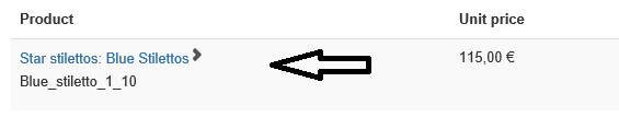

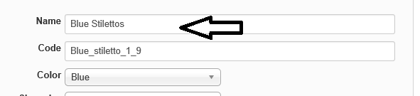

Later I looked in to the back-end of the demo site.
the demo site as well as our site have been filled with a variants name. (blue stiletto's).
The only difference is that there has been put in a color into the variants description.
There different things attending me
1st. In the back-end I don't see the description of the variants name (which was my first issue =double) double in the order
2nd It is of no use (it is more or less confusing) to put in there a name with color or a size.
