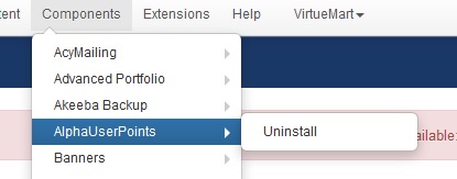

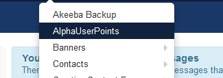

After updating to 2.6.1, the alphauserpoints becomes problematic. Firstly, the uninstall feature associated with the alphauserpoints component is gone (see the two attached pictures).

The attached pictures are below

1. The menu items is something handled by Joomla.
I suppose that there is a problem with the data structure of the menu items.
Try the "rebuild" button of the Joomla menu manager and install again AlphaUserPoints, or do it before the install of the update of HikaShop (if you can go back to the situation before the update).
