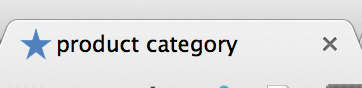

Also. I have "Product category" In the title. Even if I wrote letoilee.com into the options of te menu. How can I change it ?

1. Edit your menu item via the Joomla menu manager, and under the "product options" tab, check that the "sub element filter" setting is set to "direct sub elements".
2. Go in your categories listing in the backend, click on "root" in the category explorer, and then edit your "product category" category and change its name and/or page title.

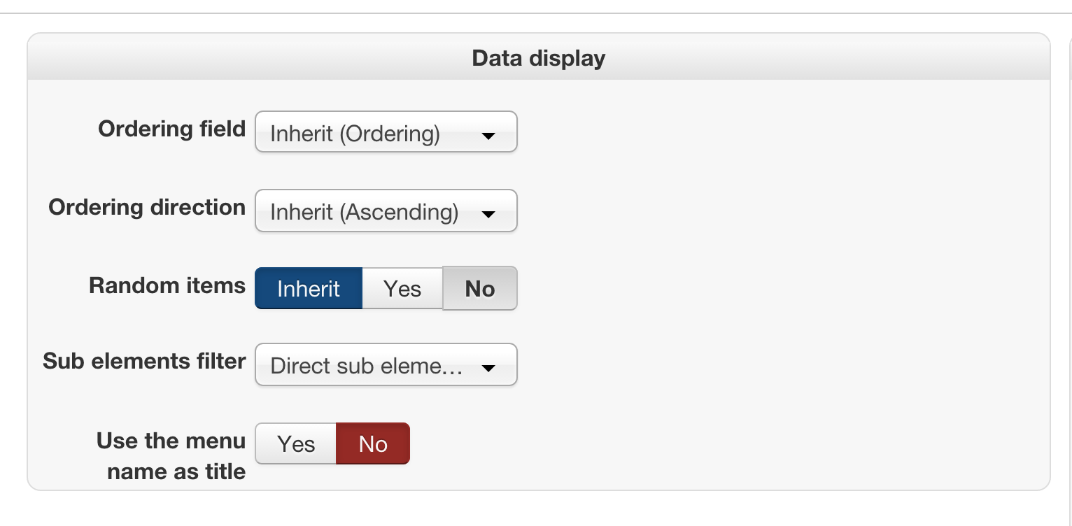

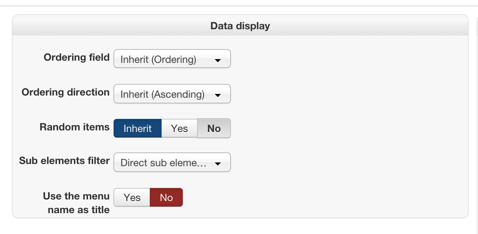

10 years 5 months ago #233338
Thank you,
1. I selected "direct sub elements" in the "sub element filter" of the "product options" tab but I still have products under my categories.
www.lemandragore.gestimark.info/fr/
2. It work good.

10 years 5 months ago #233341
1. Then please make sure that you didn't select the main category in the category setting of your products.
You should only have the sub categories directly linked to them in there.
