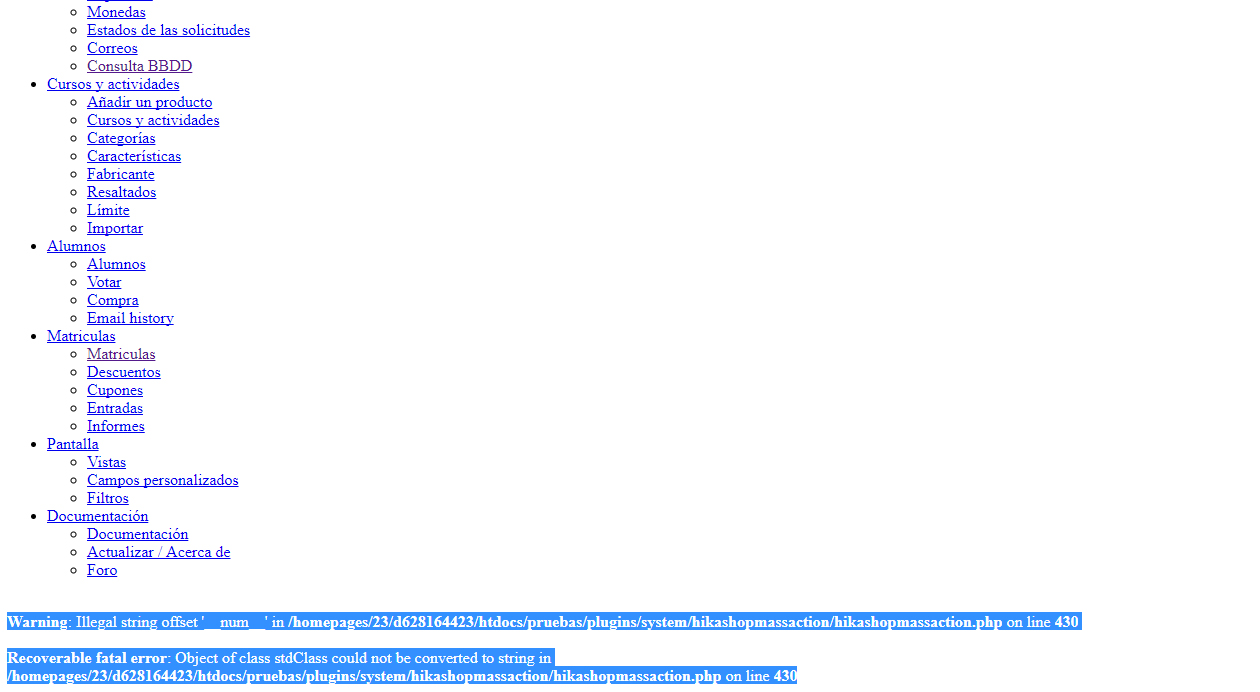

I have updated Joomla to version 3.8 and Hikashop to version 3.2, and I have found the following errors in mass actions:
1.- It generates the following screen (see image 1) with the error phrase in the debugger:
"Warning: Illegal string offset '__num__' in plugins / system / hikashopmassaction / hikashopmassaction.php on line 430
Recoverable fatal error: Object of class stdClass could not be converted to string in plugins / system / hikashopmassaction / hikashopmassaction.php on line 430 "
When I select the order tab
2.- If I set the status filter to "Matriculado" corresponding to namekay: confirmed, the wrong result that gives 0.
3.- If I set the status filter in "Proceso Iniciado" that corresponding to namekay: created, the wrong result that gives 0.
Thank you very much!
8 years 11 months ago #279429
Please open a new thread for that total different issue.
