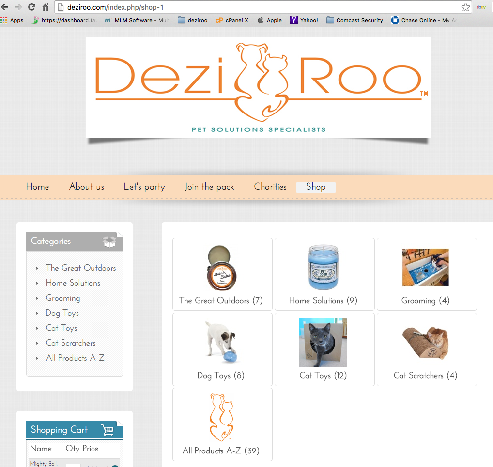

  • Posts: 38
10 years 4 months ago #235581
Attachment #1 is the screenshot of of the shop, that is where people are redirected after paying.

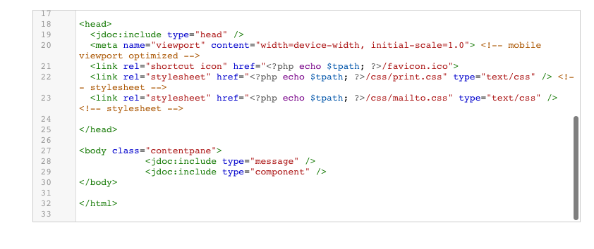

Attachment #2 is a screenshot showing the template's php has the <jdoc:include type="message" /> already in it
We are using Stripe for our credit cards.
  • Posts: 86083
  • Thank you received: 14194
10 years 4 months ago #235621
Can you make sure that the "return URL" field of your payment method is empty ?
Also, for the cart not emptying, can you check that the setting "Clean cart when order is" is set to "created" in the HikaShop configuration ?
