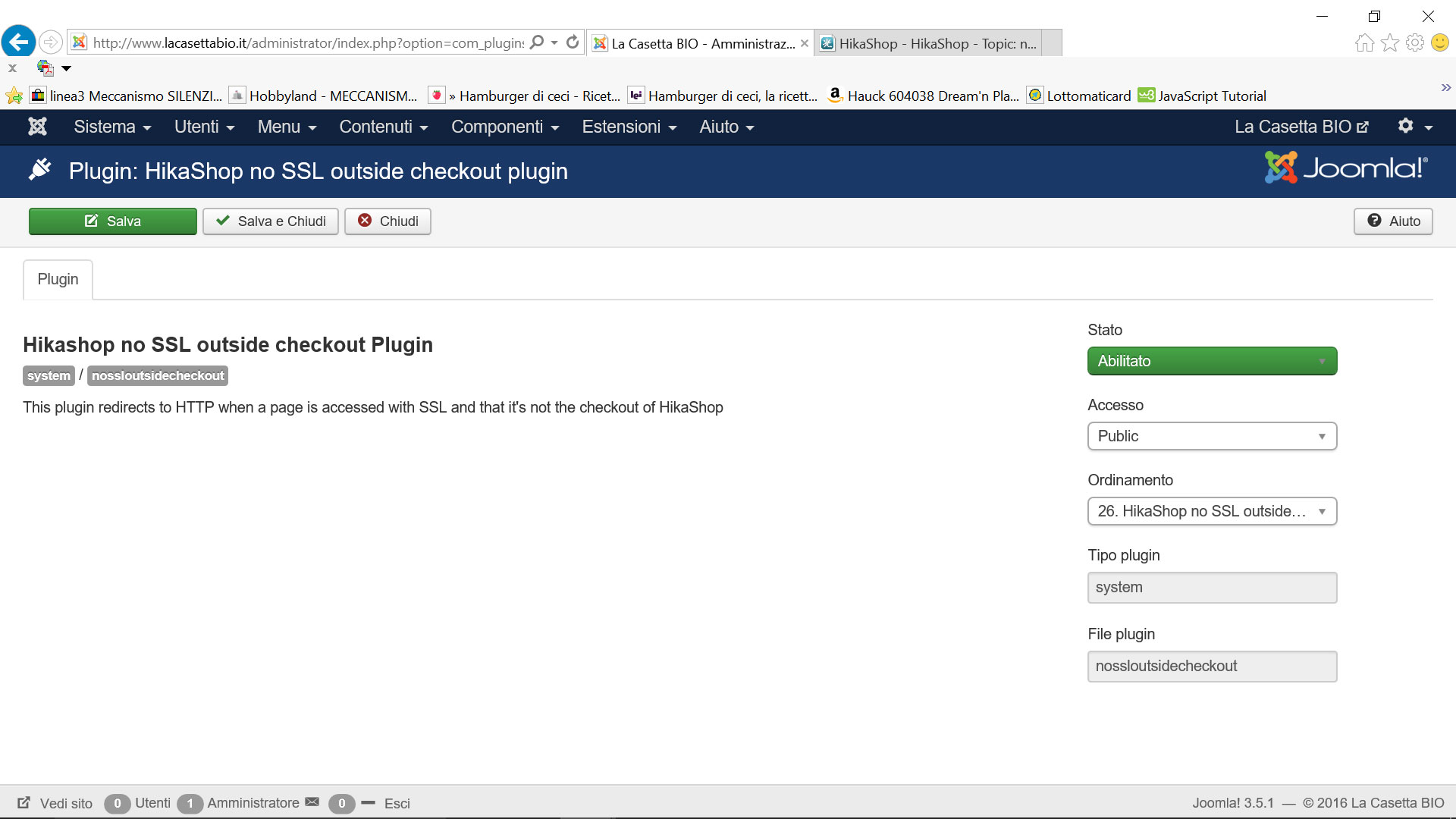

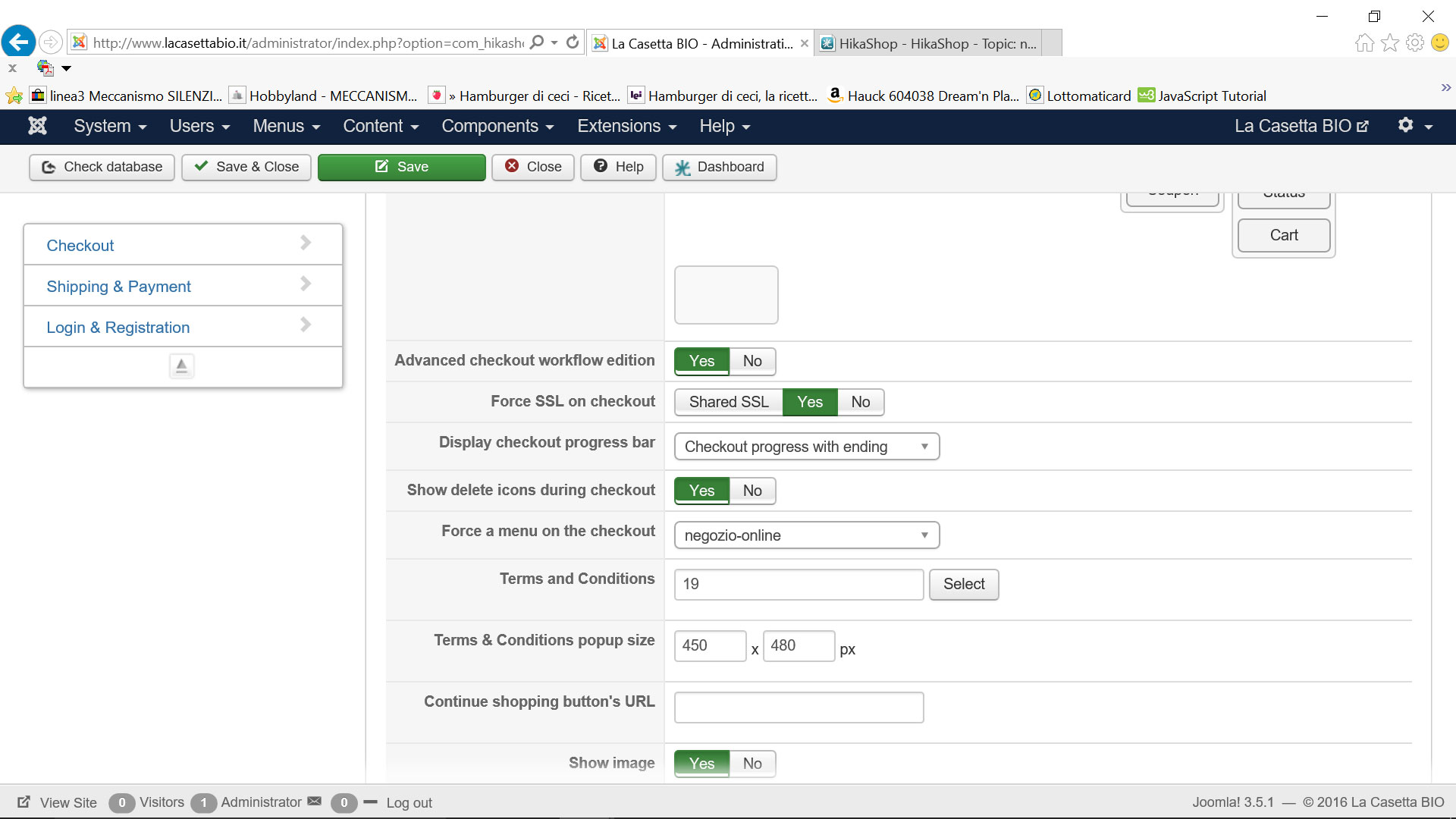

  • Posts: 719
10 years 4 months ago #236117
i send you two screenshot because my plugin has no setup. So i send a screenshot of my checkout configuration also.
Thanks, best regards
my site with Hikashop
www.lacasettabio.it
  • Posts: 86083
  • Thank you received: 14194
10 years 4 months ago #236145
indeed, there was a problem with the modifications of the plugin.
I've fixed it and tested that it works.
I've updated the package on our end with the modifications.
So you can download it again and install it again and that will display the option and the redirect will work fine.
