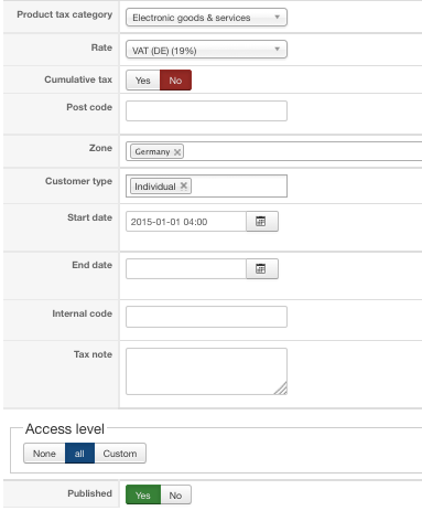

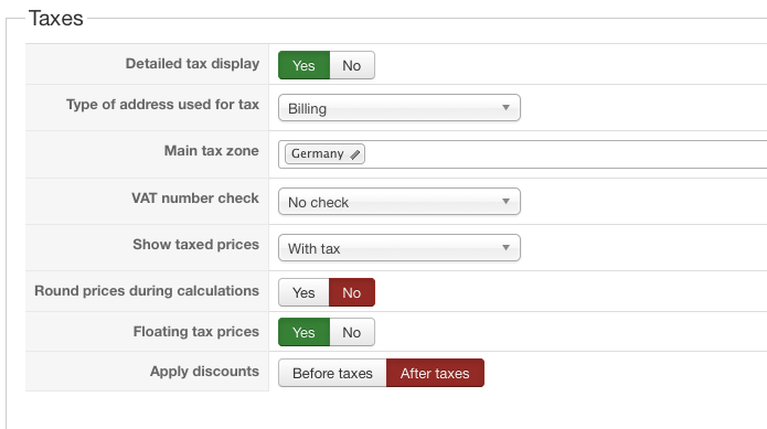

Please give us a screenshot of your settings in Configuration > Main > Taxes.
And of one tax rule configuration.
  • Posts: 159
10 years 4 months ago #236774
HI Xavier,
here are the screenshots:

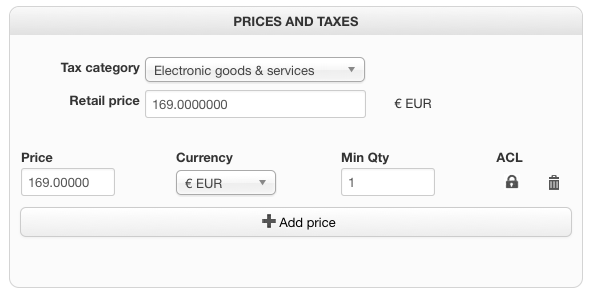

Please make sure that the "Electronic goods & services" tax category is selected in your products or the tax rules won't be used.

yes, the products are set to "Electronic goods & services" tax category. I checked the FAQ list again (I did it before I posted the problem) and can't find the reason, why the tax is not showing.

10 years 4 months ago #237081
The "default address type" setting of the HikaShop configuration wasn't set correctly.
I've set it properly and it's working fine now:
take.ms/fwjaO
