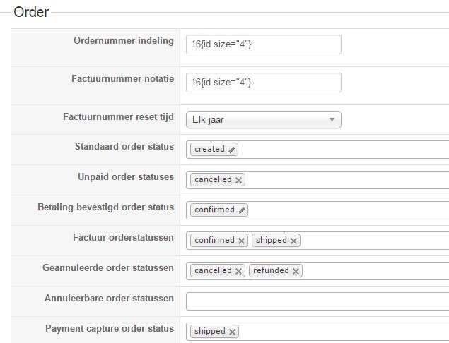

  • Posts: 5
10 years 4 months ago #238851
Now i have this.Look at the attachement
  • Posts: 86083
  • Thank you received: 14194
10 years 3 months ago #238880
HI,
If you put "id", it will take automatically order_id for the order number and "order_invoice_id" for the invoice number.
So if you want the same number, instead of "id", you should put "order_id".
The following user(s) said Thank You: Spijkertje
