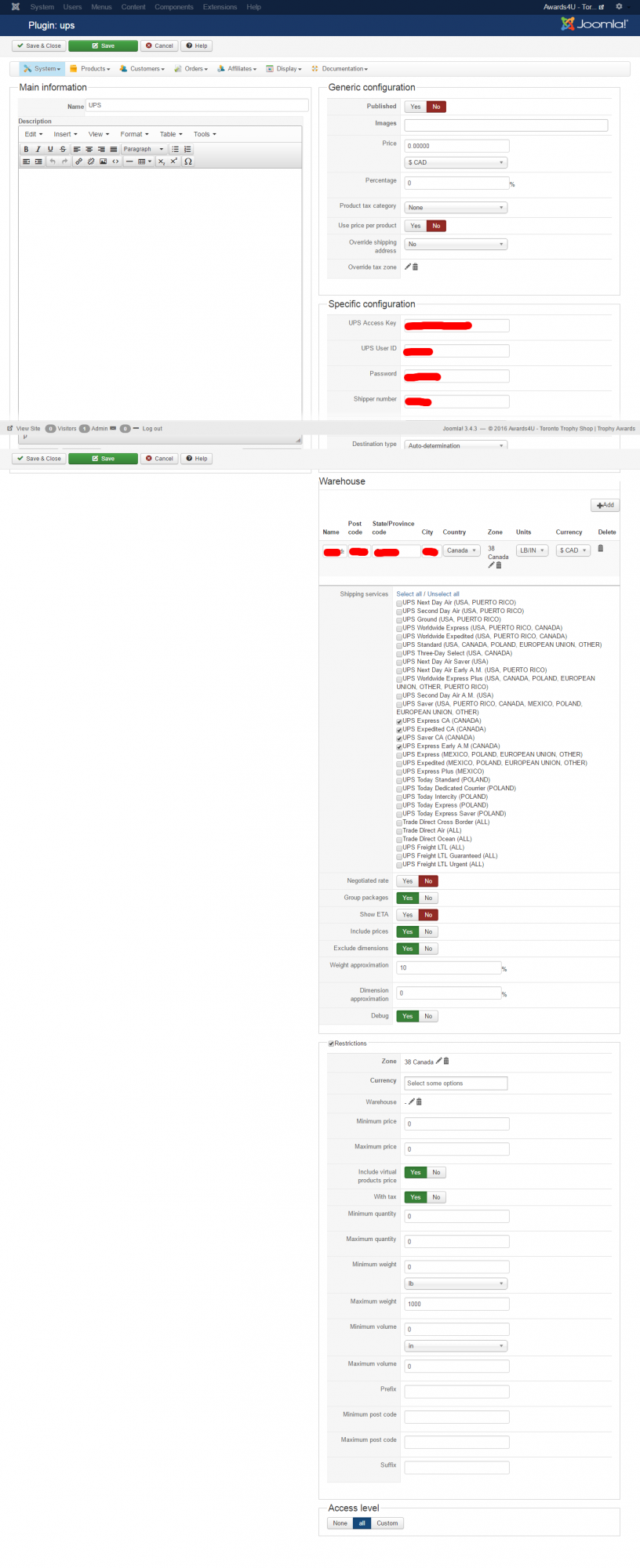

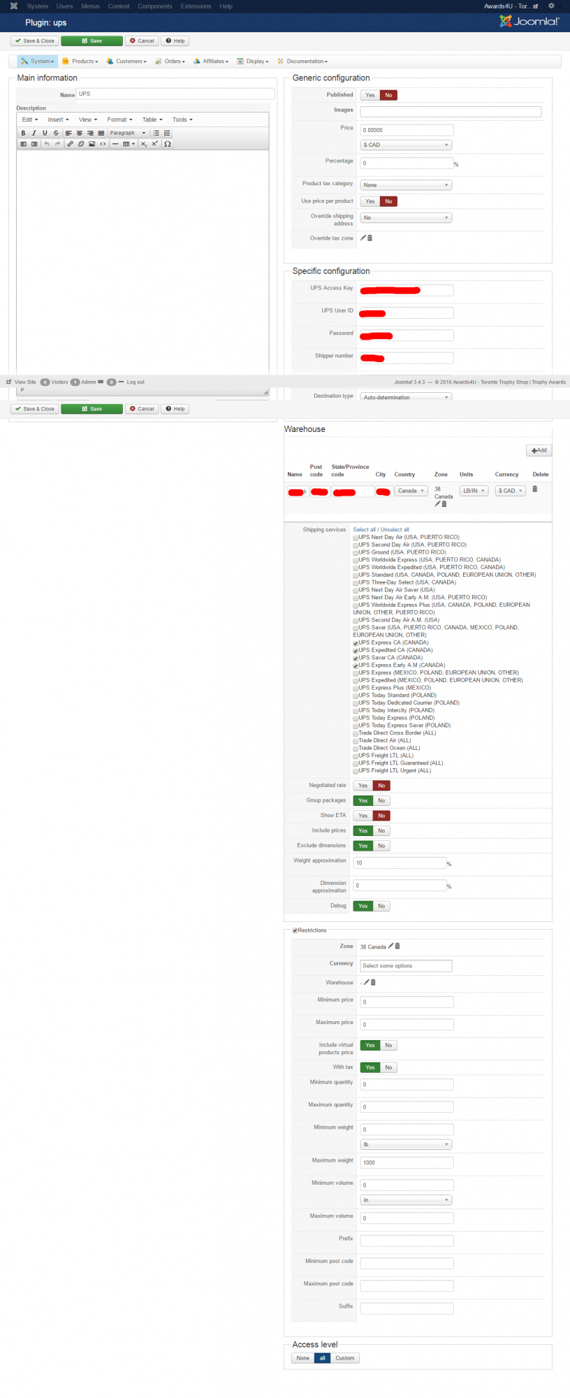

  • Posts: 89
10 years 3 months ago #239967
Here I have attached you the screen shot for your reference.
  • Posts: 86083
  • Thank you received: 14194
10 years 3 months ago #239999
Could you try remove the canada zone restriction and the canada warehouse zone which both restrict the UPS shipping method ? And then, if that doesn't help, try to also select the other shipping methods of the shipping method.
Also, note that the shipping methods can only be displayed once the customer enters his address as UPS needs it to calculate the shipping fees.

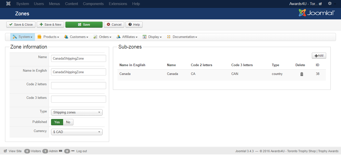

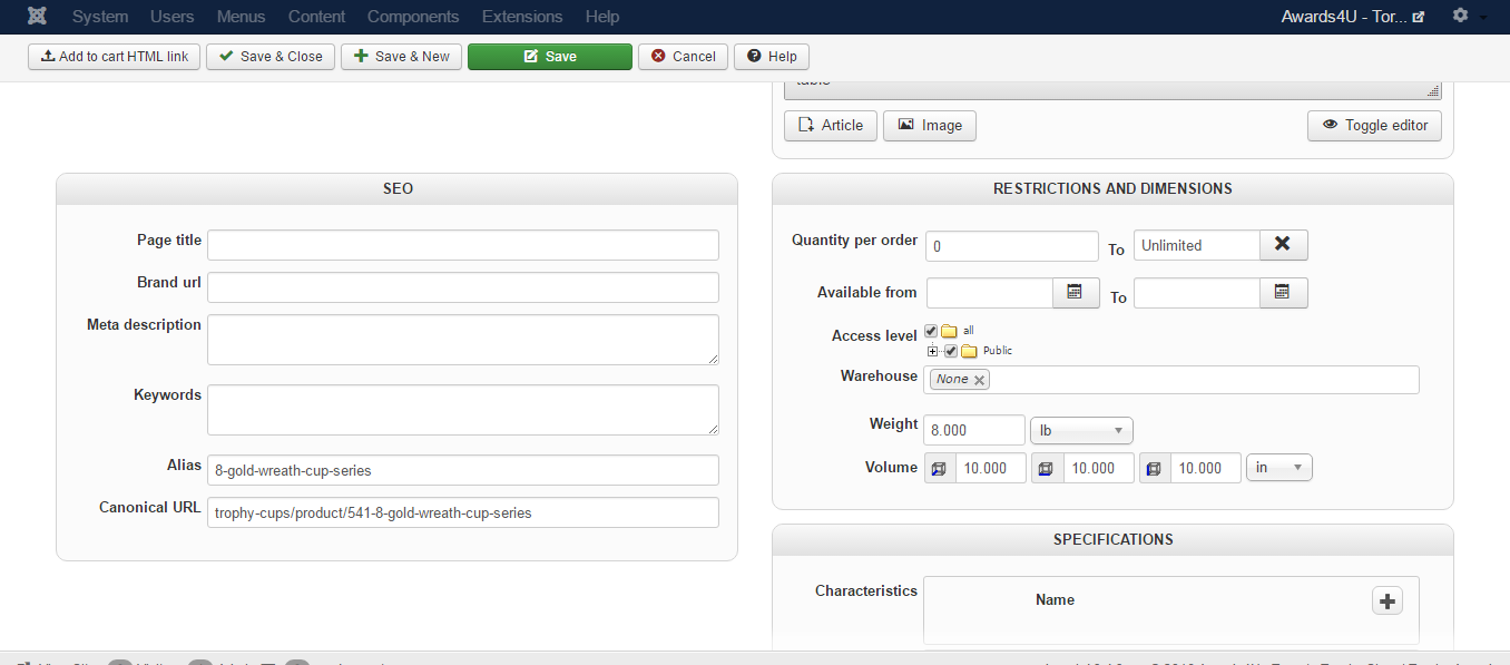

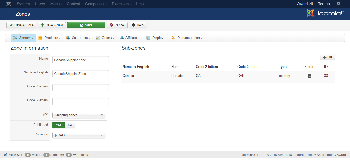

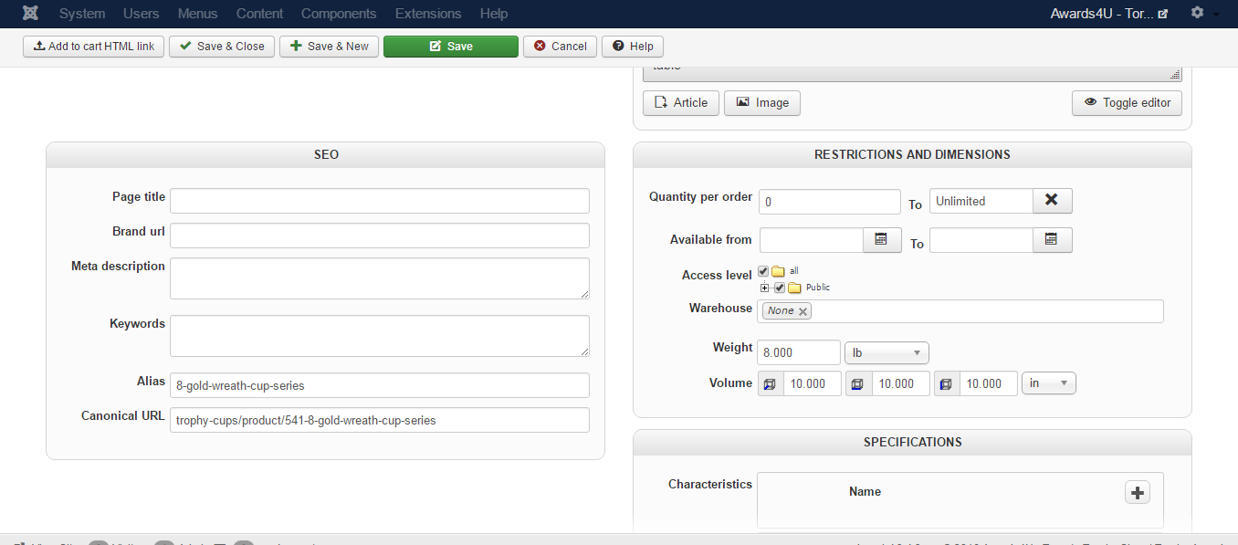

  • Posts: 89
10 years 3 months ago #240146
1. The error "No available warehouse found for your location" is coming after removing warehouse from UPS Shipping Settings as you advised. Also, the testing I used the address located near the warehouse.
2. On the product page, there is no warehouse added
3. Shipping zone, it just only one selected country as "Canada"
I attached you the shipping zone and product page screenshot for your reference.
Thank you!
  • Posts: 86083
10 years 3 months ago #240152
I think we got some misunderstanding because of the naming of the options.
There take.ms/HGwpo the warehouse need to be filled in your UPS plugin, but you need to leave the zone empty.
There take.ms/WBtEg both the warehouse and the zone should be left empty.
The "No available warehouse found for your location" error means that either you didn't enter your address in the first warehouse area, or that you didn't select a warehouse in the option of the restrictions area of the shipping method.
And you don't need to create a shipping zone since the zone fields should be left empty in the shipping method.
