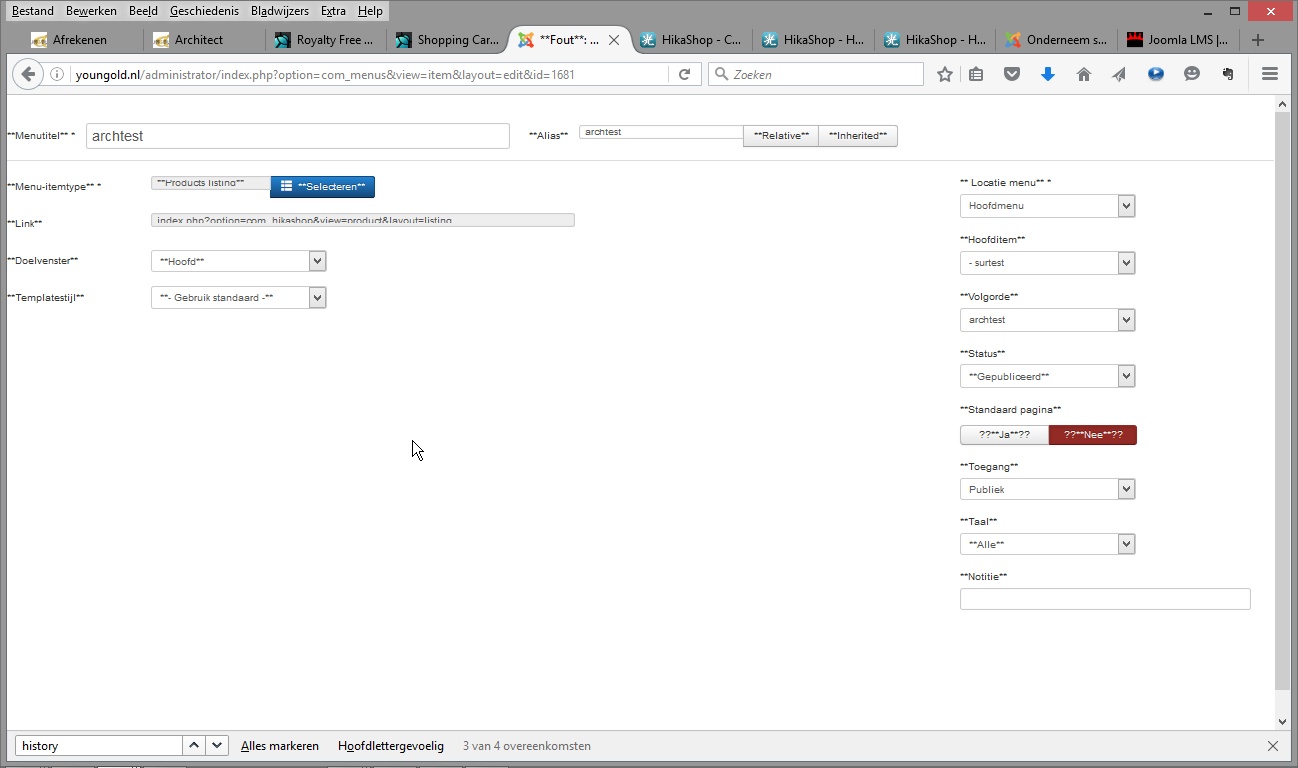

I have turned on debugging in the Joomla config page.
When I then select "product listing" in the menu-options, the debug infomation disappears from the screen; see attached picture.

10 years 3 months ago #240012
This looks like a fatal error.
Can you also turn on the "error reporting" setting of the Joomla configuration ? It should then display an error message at the bottom of that page.
