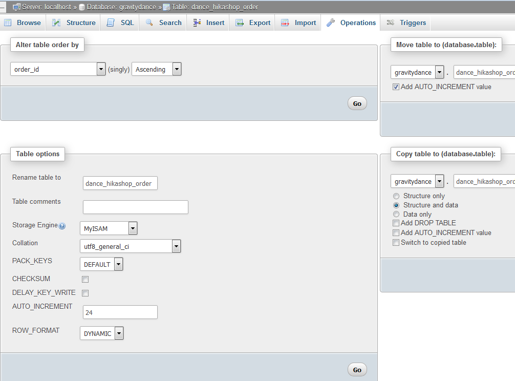

10 years 6 months ago #240089
by KelsoUSMC
Replied by KelsoUSMC on topic How to change starting point for order numbers?
10 years 6 months ago - 10 years 6 months ago #240108
by Jerome
Replied by Jerome on topic How to change starting point for order numbers?
See AUTO_INCREMENT setting in your screenshot

10 years 6 months ago #240143
by KelsoUSMC
Yes, Jerome.
That message I sent to Nano as he was the OP.
