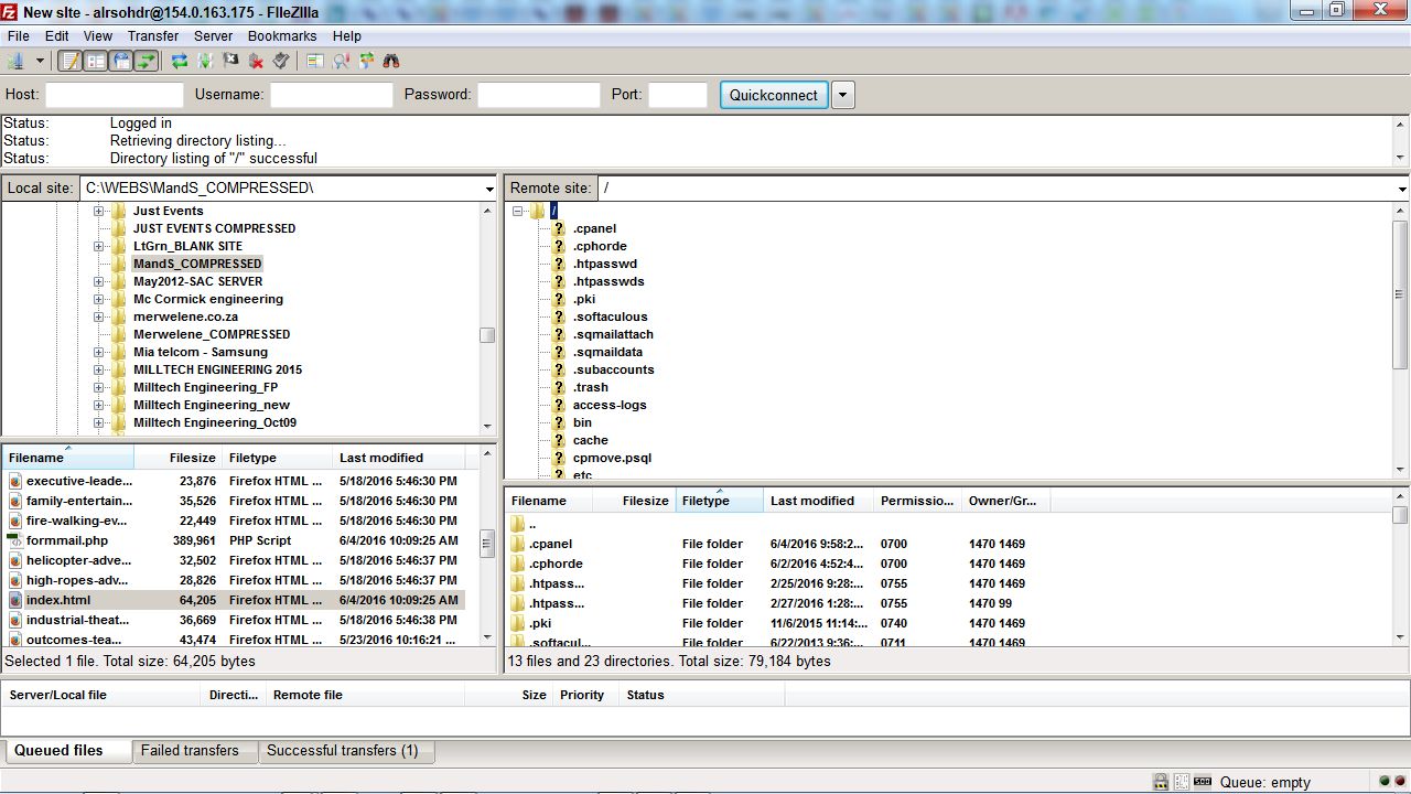

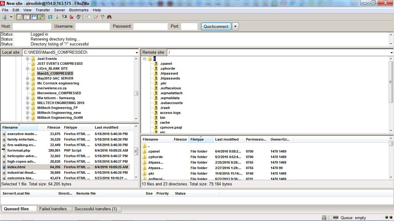

  • Posts: 78
10 years 2 months ago #241972
I have double checked and tested the ftp details with an entirely new connection and my webmaster has also tested the them.
We are not blocking any IP addresses either.
I can't understand how you can't get in.
Can you get into the Joomla backend?
Is there another way to do whatever it is you want to do?
  • Posts: 78
10 years 2 months ago #241984
