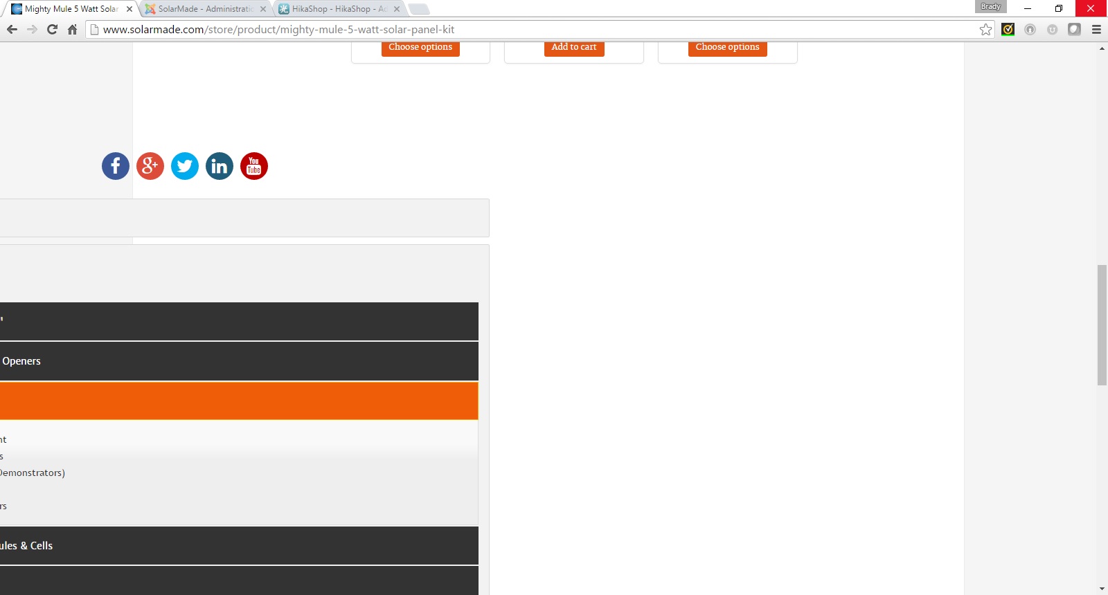

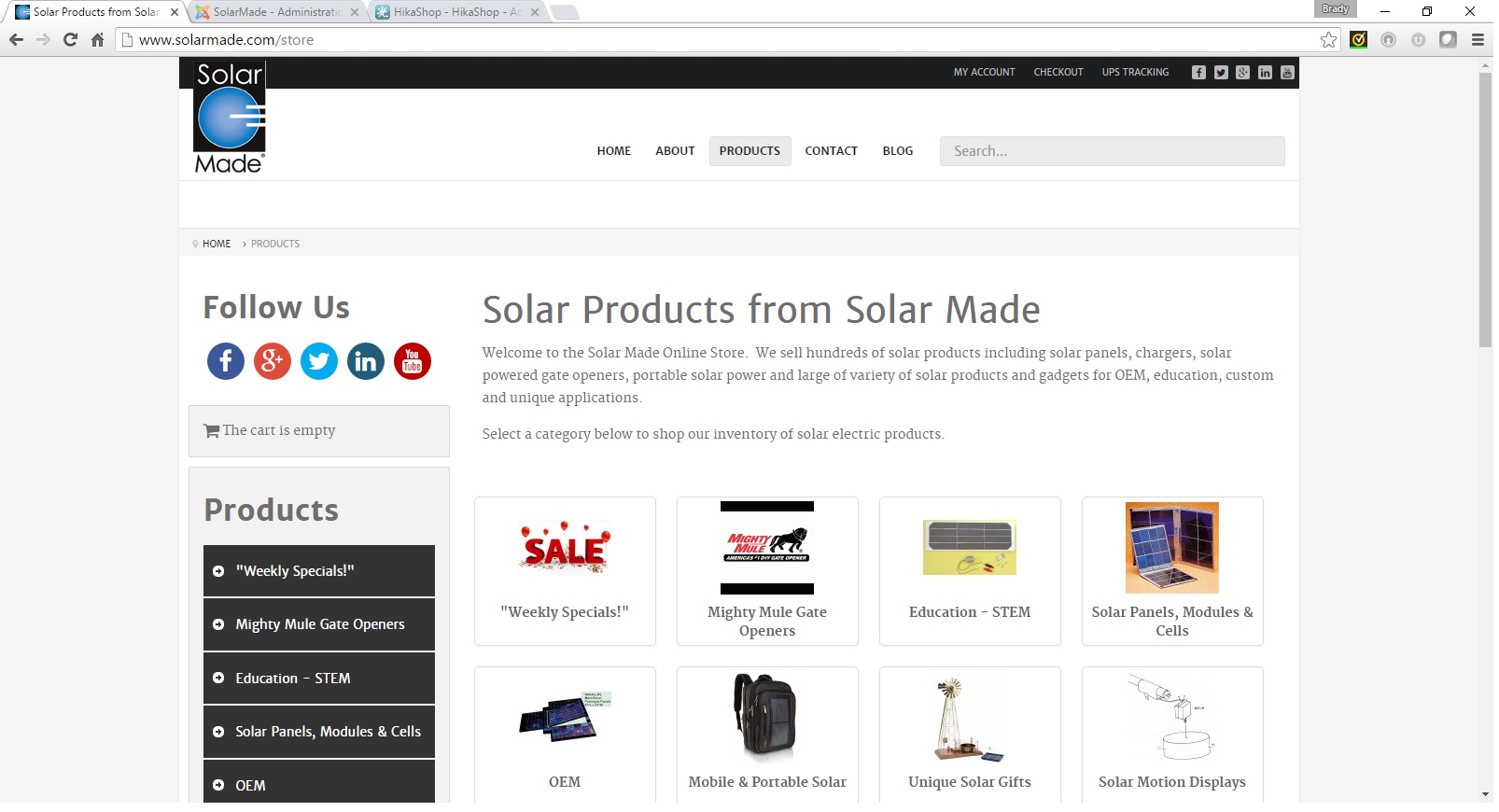

After installing the Hikashop 2.6.3 version, I noticed a small problem with how my category menu was being displayed.

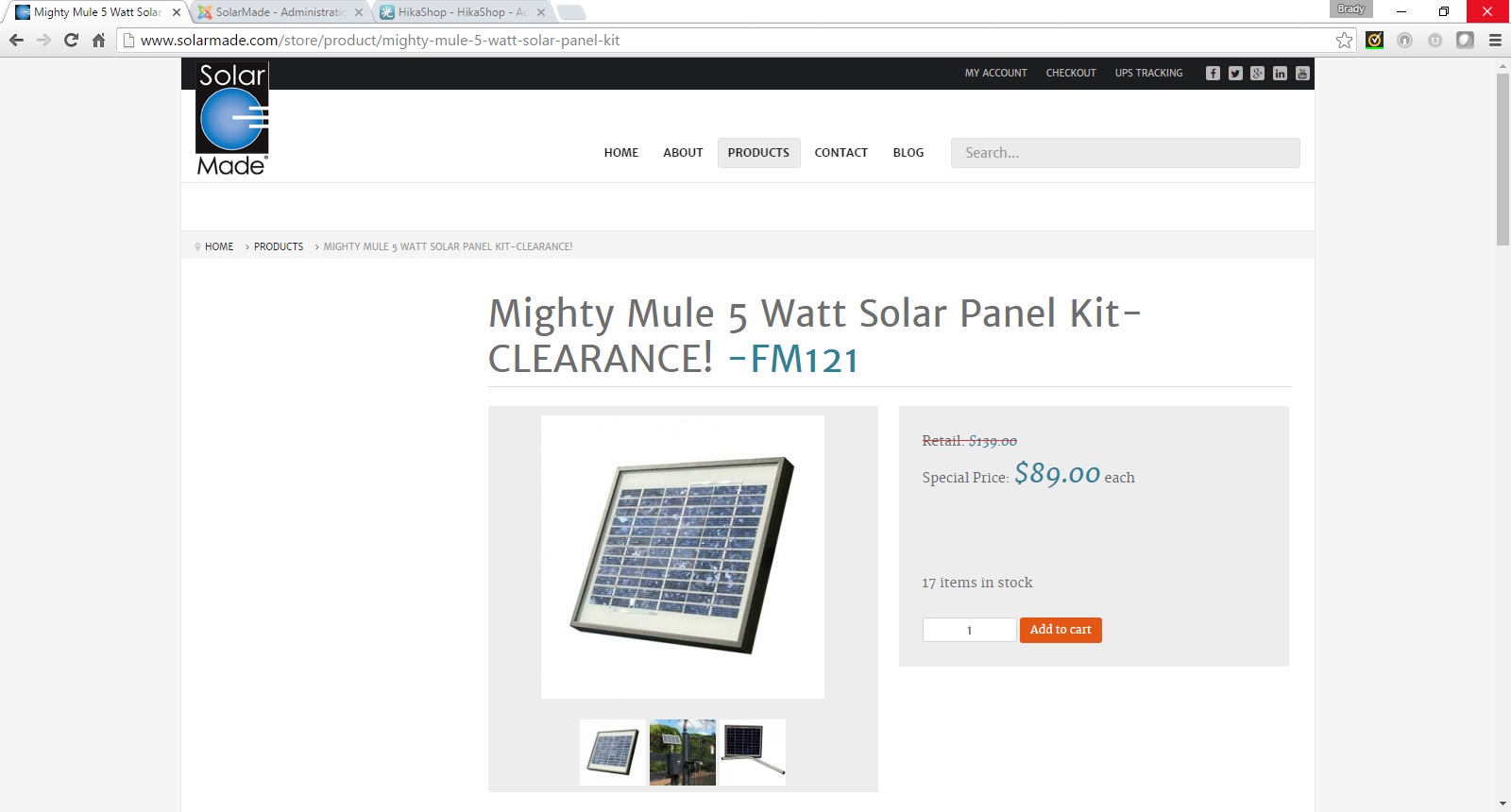

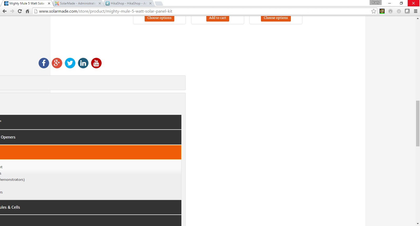

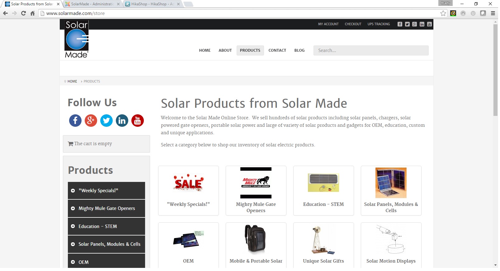

On the home page and category pages the "Category Menu" is displaying properly. However, once I get to a product page the category menu is offset and is located at the bottom of the page.
What settings do I need to change in order for the category menu to display properly on the product page?
I have attached some pictures so you can see what I am talking about.
Thank you for your assistance.

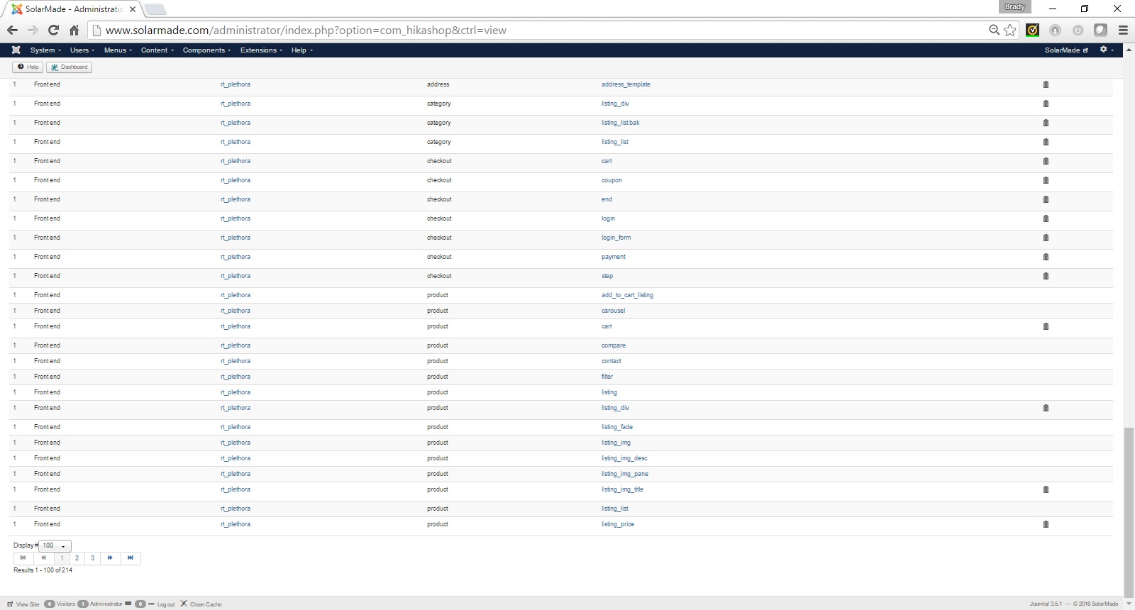

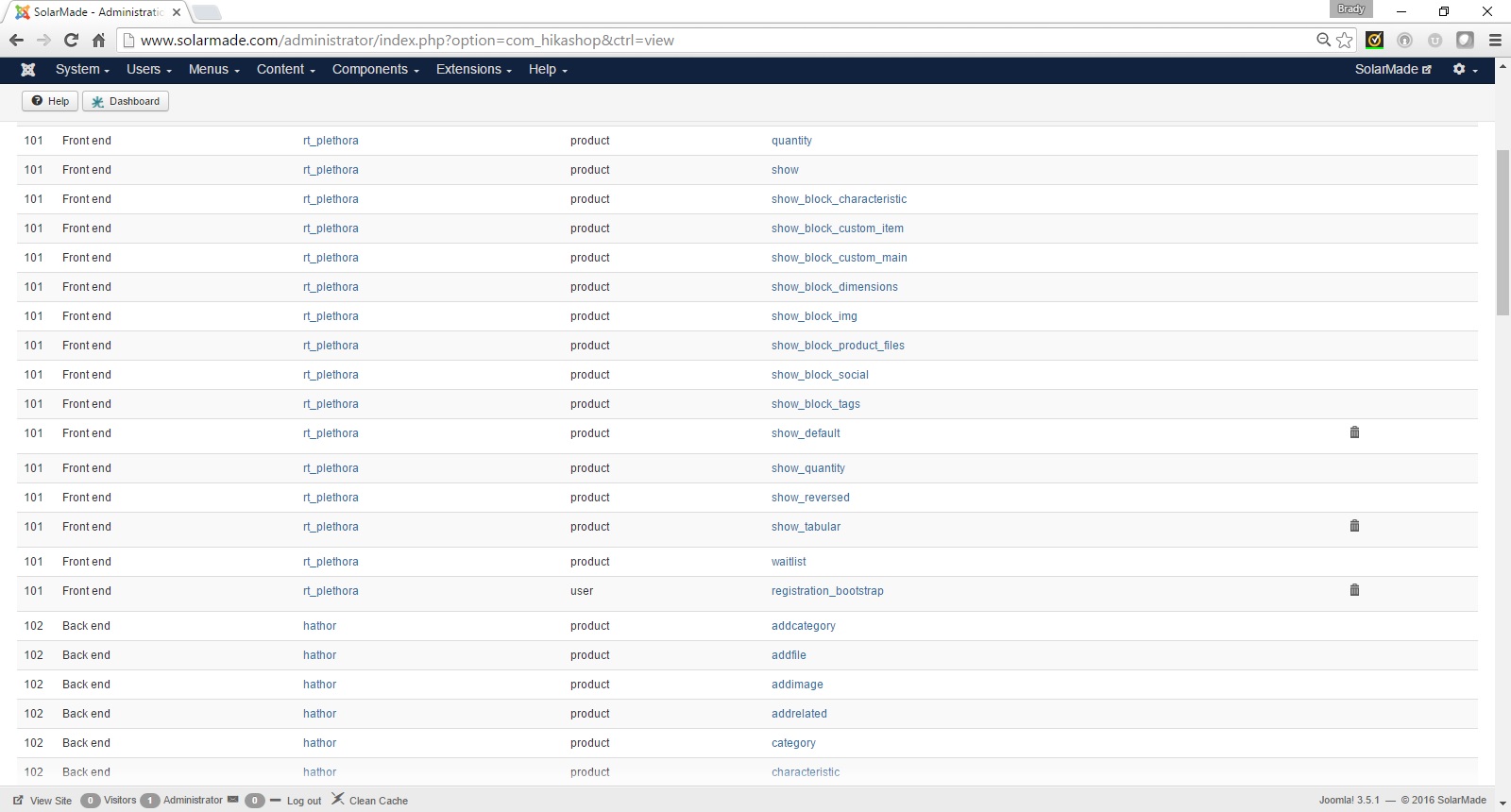

Hello Nicolas,
Do you mind giving me a little more assistance in locating exactly where the problem is, or what view it may be in? Our website design company is long gone and I am having to learn all the PHP myself in order to solve these problems.
However, I don't know what customization was added exactly to each file.
I feel the customization is also interfering with the voting stars as they do not appear.

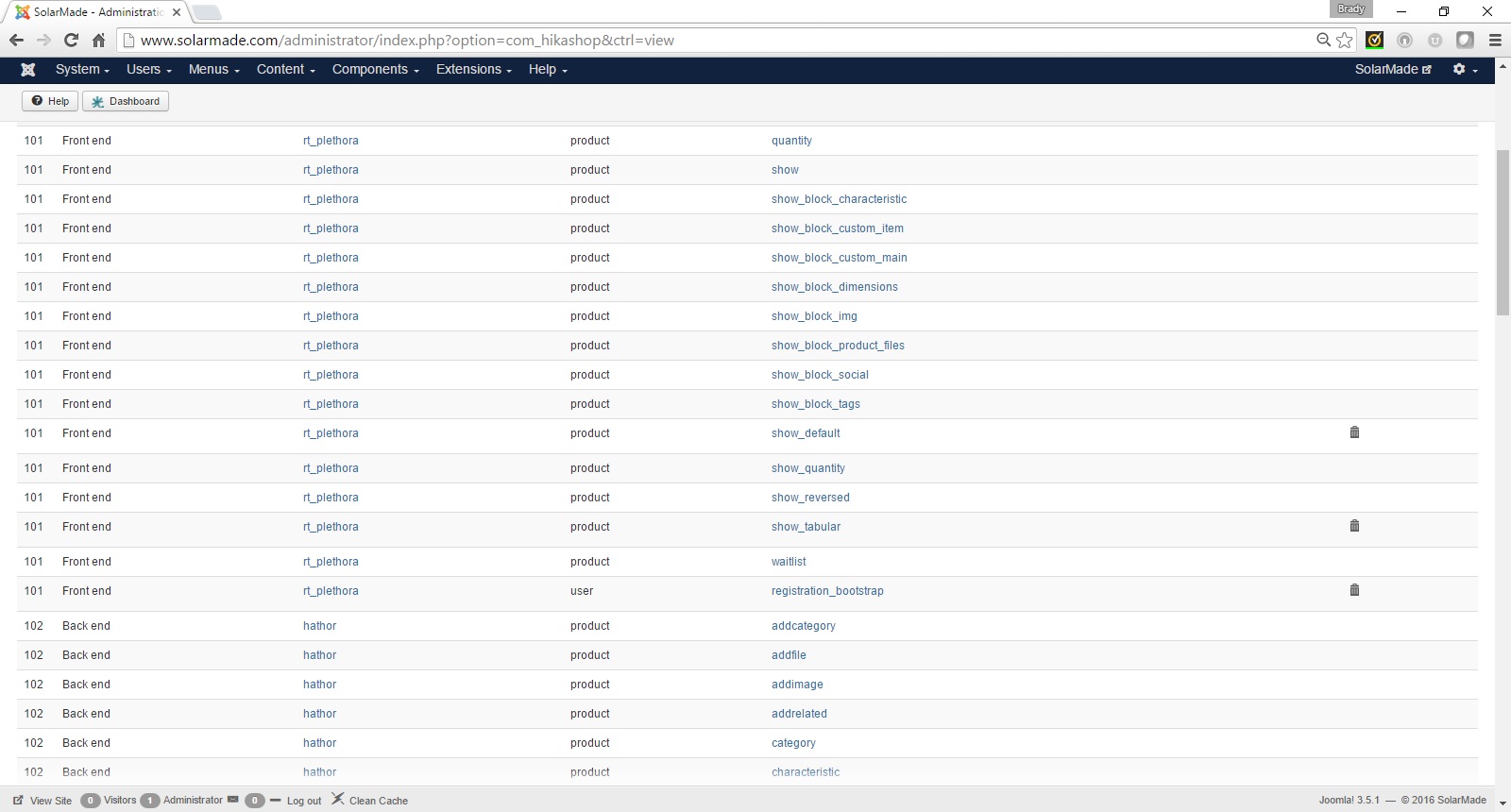

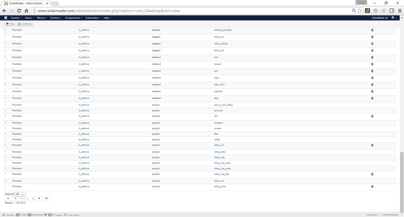

The attached pictures show all of the "product views" that are customized.
Thank you for any guidance you can give me.

You can find the customized files in the subfolders of the folder templates/YOUR_TEMPLATE/html/com_hikashop/ that you can access via FTP.
There, you have the product folder which contains the different files relative to the product layout customization, and the vote folder which contains the different files relative to the vote system customizations.
Rename the files there one by one in order to identify which files generates the problem.
Once you've identified the file, compare it to its equivalent in the core of HikaShop, in the folder components/com_hikashop/views/product/tmpl/ with a software like winmerge.
That way, you'll be able to see what is different and you can potentially test to replace the changes, one by one in the file
  • Posts: 31
10 years 2 months ago #242454
Thank you Nicolas! It worked like a charm.
The customization in the "show_tabular" view file is what was causing the problem. Your advice worked great and the problem is fixed.
