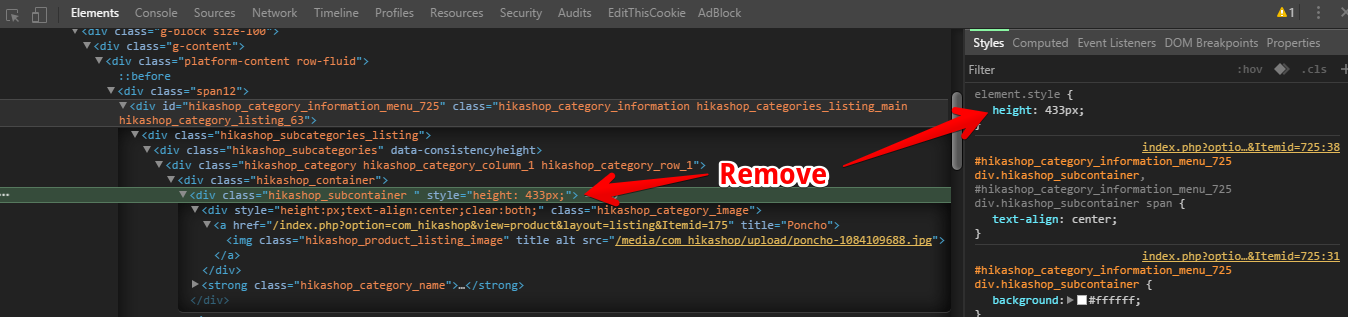

can you please tell me how can I remove the inline height added to the hikashop_subcontainer div on categories listing page?
Where can I find the code?
thanks!

You need to edit the file "listing" of the view "category" via the menu Display>Views and add such code at the top:
Code:
<?php $this->params->set('consistencyheight', 0); ?>

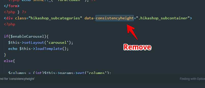

Shouldn't the code above be assigned to a variable, because it doesn't work.
I've removed the code listed in the attached screenshot. Will this be a correct solution?
thanks!
thanks!
Last edit: 10 years 4 months ago by michaelmyth.
10 years 4 months ago #245105
by nicolas
Replied by nicolas on topic Remove height code on categories listing divs
You can also remove that code yes.
You actually have an old version of the view which is why it didn't work.
The code you're talking about is actually like that by default with the latest version of HikaShop:
